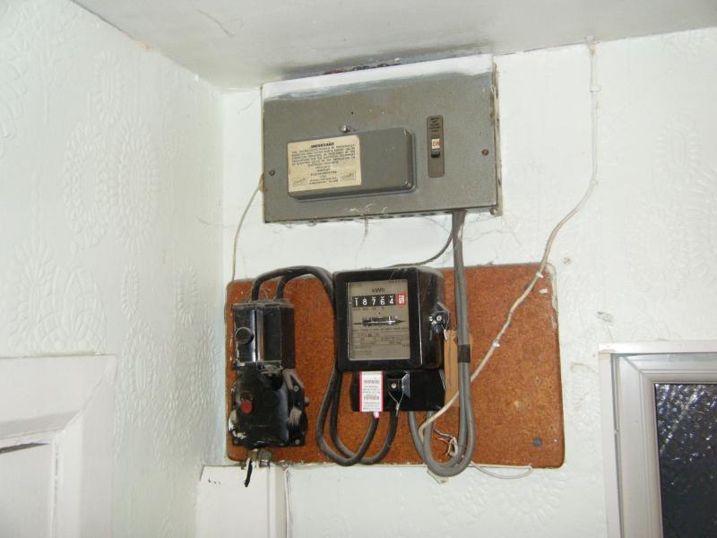

Thanks for the replies. I've never actually used the test screwdriver anyway, its just sat in my toolbox. I do have a multimeter though.
There is no RCD protection in my CU. If I just put the pos and neg leads from the multimeter onto the live and earth wires respectively, could this give me an indication of whether the earth wire is suitable to be reconnected?
With the appropriate fuse/mcb off/pulled you can test your earth connection at the box in the pic by testing earth-NEUTRAL, this should give you a VERY LOW continuity reading if on a TNS or TNCS supply, if on a TT supply the reading may be vastly higher, possibly a few hundred ohms. See the wicki re TNS TT etc
Gigagator: Firstly, have a visual check to make sure that the cpc's havent been snipped off elsewhere. Confirm that fact here and then you can use your test instrument, such as it is.........
Lucia.
All of the bare earth wires are snipped off at every point on the upstairs lighting circuit i.e. at the switches, at the light fittings and at the junction in the attic as shown. I'm not sure about the downstairs lighting circuit junction as I can't lift floorboards to get at it but the situation is much the same downstairs.
However, I'm not sure if the earth wires have been disconnected or cut off in the CU as I have never opened it. Here is a picture of my CU in the hallway - usually has a cover over it.
Remeber that when you open that board that the main switch is OFF also remember that the two grey cables that come in from the bottom of the board to the top of the main switch will always be LIVE!!

Okay, I am going to have a look inside the CU tomorrow. I understand that some parts will remain live so I will be cautious.
I'll also take a photo of the inside for your curiosity. Judging by the state of the work elsewhere in the house, no doubt the CU will be equally worrying.
Thanks for the advice.
Hi there
Purely out of interest - is there a lead seal on the main fuse?
Couldn't see it in the photo - so just wondered.
Martin
Hi there Martin,
I'm not sure to be honest. I will check tomorrow - you mean on the unit farthest to the left, correct?
