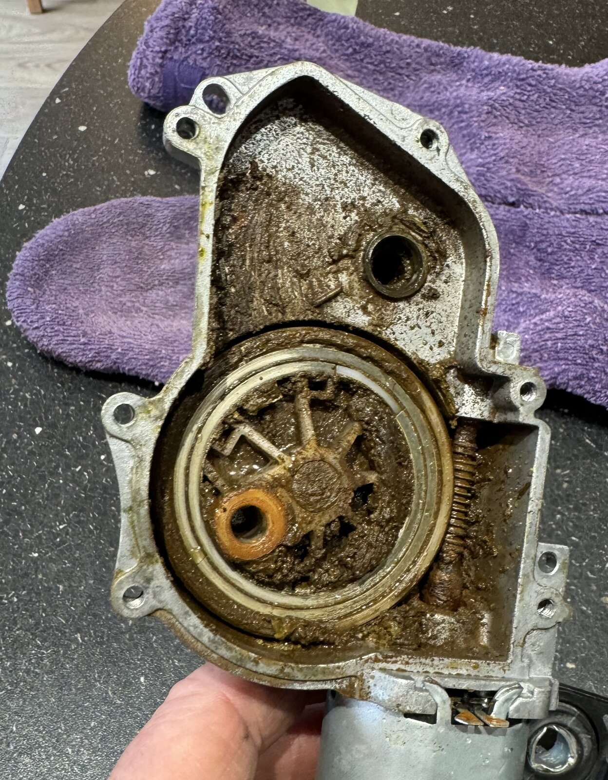

Next job was to sort out a water leak in the tailgate. No water in boot floor but every time I opened the tailgate I'd get a flood of water pi55 out of the tailgate trim and drip on me 'ead! On top of that, the wiper was playing up - intermittently stopping halfway through its travel and not parking properly when switched off. Took the tailgate trim off and it was obvious straight away what the problem was. On the A3 the washer water goes through the wiper motor and comes out through the wiper arm spindle where the jet is fitted. It had leaked internally causing the wiper to play up and water to leak into the tailgate. You can see the rust marks where water is coming out of numerous places on the motor. Going to order a new wiper motor when I get home.

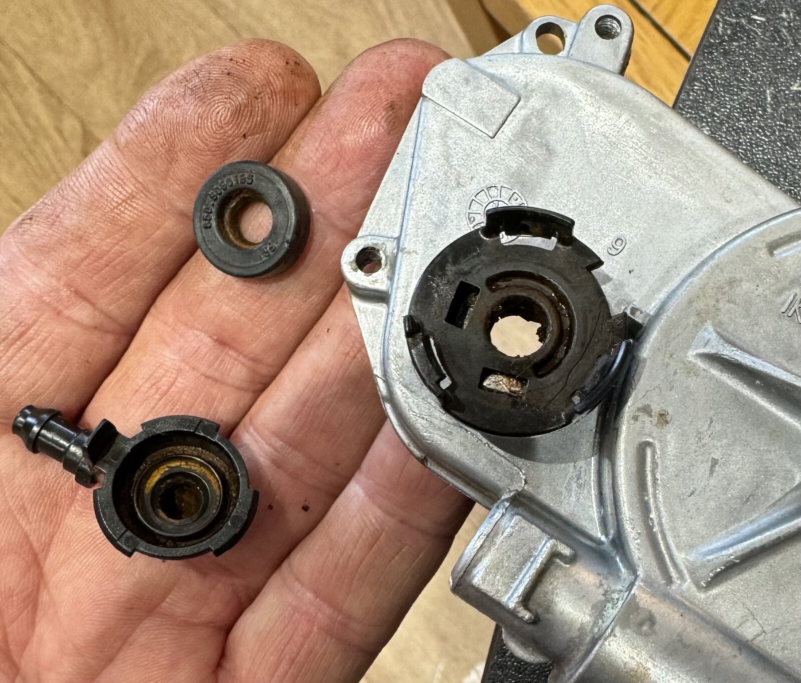

Replacement wiper motor came today so I fitted that on. I opted for a second hand OE motor in case my insurance was invalidated according to @DiyNutJob. ;) Not really, I bought it instead of some new cheapo Chinese p.o.s. even though I could have got one of those for about the same price. All working now but I opened it up to be nosey and what a mess. Looks like it failed because of a seal on the washer pipe connection. Anyway, all done now.
