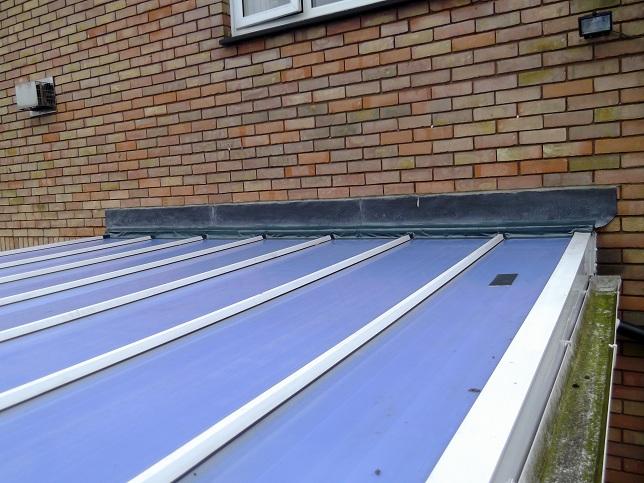

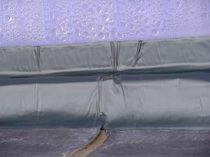

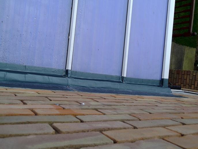

I got a quote that said lead flash and a days work for two men - what I received was flashband after two and a half hours...
Is it right that "in the trade" lead flash actually means lead look (in the dark if you squint) flashband?
Is it right that a trader quotes to the public in "trade speak" without explaining
When someone says lead to me I expect lead.
I get that you talk codings when it comes to lead and my existing flashing is code 4 but I did not realise that without mentioning a code that "lead" wasn't lead - am I the only person this stupid?

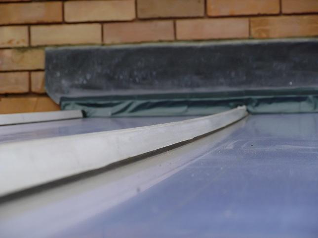

Was definitely a quote - it said in the summary a lead flash band (I figured this was just a band of lead it did not cross my mind he meant flashband which is not lead) esp. as in the detail it said "we would lead flash underneath this existing lead down onto approximately 4 inches of your ... roof"
The quote was £500
Other thing is I wouldn't have got anyone in to flashband the thing when I could do that myself. especially as the remedial work that was being carried out had no guarantee there was no advantage to me to pay a company to do it for me...
That would be a shed load of flashband for £500... you paid him yet?
Not paid him yet still missing a part he was getting for me - included in the 500 but cannot thing the part was more than a tenner!
What do I do? He is adamant his quote was clear and that anyone in the trade would know he meant flashband... I pointed out I am not the trade and even if I was I don't think his quote is clear...
Right now I don't want to pay him anything - aside from for the part if he gets it and fits it - I was also very disappointed with the way it was carried out and what they did in my garden - not a huge deal in the grand scheme of things just NOT professional!

"Lead flash" on a quote means lead flashing. Made up from "lead", the material, and flash, the operation or component
If anything else other than lead was to be used I would expect terms such as
Non-lead alternative flashing
Flashband (or other proprietary name)
Self-adhesive flashing
Bitumen based aluminium flashing strip
Note that "Flashband" is not lead, so there can not be any "lead Flashband". Also Flashband is a one-word proprietary product. It is not "flash band"
If someone writes "lead flash band", then I would expect a band of lead flash(ing)
If someone writes "lead flash band" intending to mean "non-lead self adhesive Flashband" then they are out to con you In which case don't pay for the work as it was not as per the agreed quotation /acceptance (ie legally binding contractual relations) and offer to refer the matter to trading standards

A 3m roll code 4 150mm is twenty odd quid here Dressed under the existing apron and over the glazing bars.
