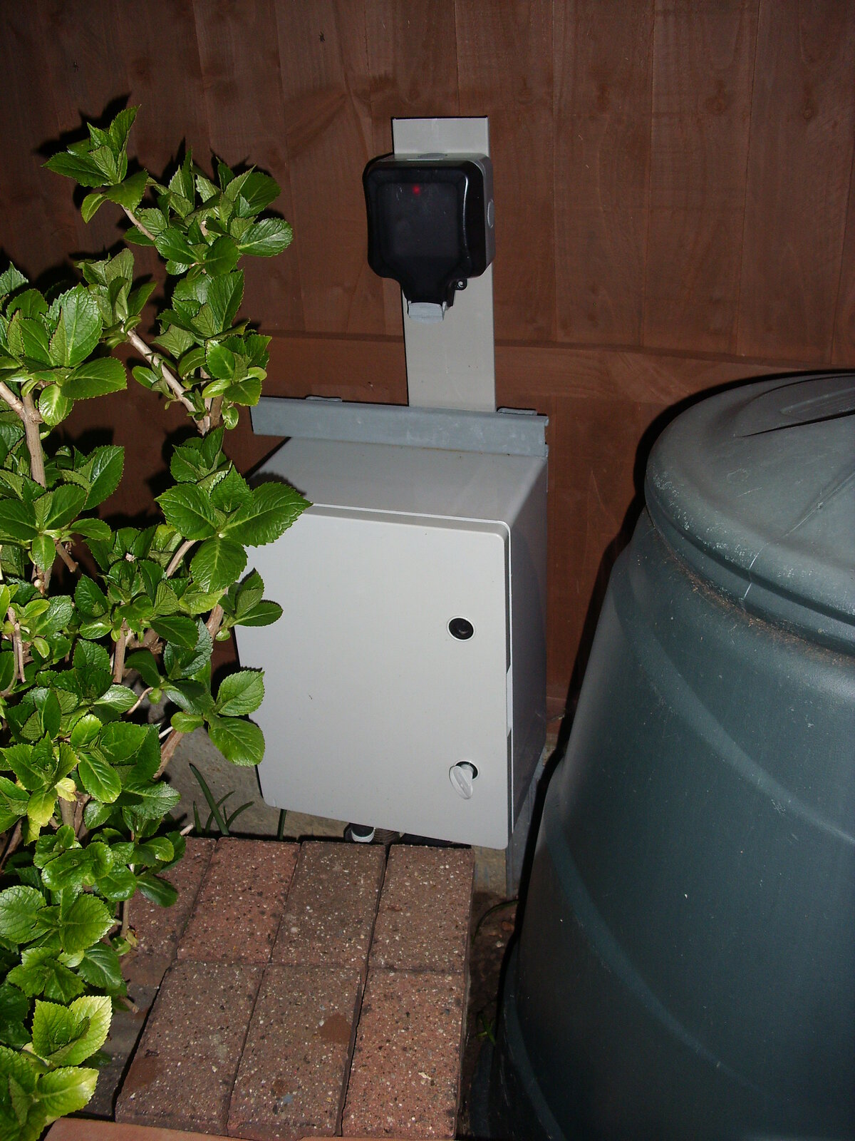

What is this - an external isolator?
Is there a "CU", or some equivalent, inside that box?
It contains several MCBs; 10A for the 13A socket and a number of 4A's feeding a relay contact each to operate Christmas lights and ELV transformers for garden bollards etc.
Anyway, as I said, if one feels one has to have 'a CU' in the garden, then I would personally prefer it to be inside some suitable enclosure, rather than having an "IP66 CU" screwed to a wall or fence :)

I understand the comment and have myself installed many CU's [or equivalent] in larger enclosures but surely an IP66 enclosure is an IP66 enclosure.
Most things are available if one looks hard enough! However, would you really be happy with an "IP66 CU" in your garden, or any garden you had anything to do with?
As Rocky said, one could put a CU (or any other sort of 'distribution equipment') in a suitable outdoor enclosure, but I'm not sure that I would really want even that - and, as I said, I can't recall having seen such in any UK domestic garden - have you?
Fair enough. I'll accept that as being 'some equivalent' to a CU.
Perhaps I wasn't clear enough. Given my experiences with 'outdoor electrics' over the decades (regardless of alleged IP ratings), I am pretty cautious, and what I was meaning was that if I really felt the need for a CU ('or equivalent') outdoors, I would probably favour "an IP66 CU inside an IP66 enclosure". On the whole, I attempt to avoid 'exposed to the elements' kit of that sort, even if doing that involves extra cable runs to the house and/or convenient outhouses.

The pictured enclosure it the only protection, for McBs, DIN rail terminals and relays. As said before the vast majority of my work has been commercial and if the job is done correctly with the correct products the weather issues are not common, I won't insult by saying non existant. Working with, sometimes very large, control panels in the open on a tall office block is common and the contents are far from IP4 rated, just like the traffic light control pillars and additionally they usually have significant vent holes.The important thing is to provide drainage holes on the offchance water may get in.
I realise that, which is why I said that I tend (because of past experiences) to be more cautious than that, and to have "IP66 things within an IP66 enclosure". As you say ...
.... if the job is done correctly with the correct products the weather issues are not common,
True, but I would say a lot more common than some of the incredibly rare and improbable hypothetical issues we have recently been discussing in this forum.
.... The important thing is to provide drainage holes on the offchance water may get in.
That can be a bit of a two-edged sword. The last couple of RCD trips (maybe more) I've experienced because of things going wrong in outdoor accessories has been due to spiders and/or various insects getting in through drainage holes and then setting up house and multiplying dramatically inside them!
