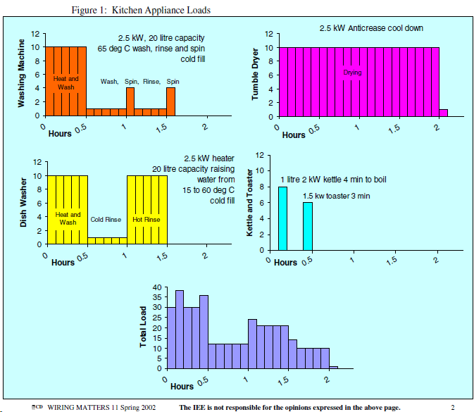

A dishwasher, washing machine or tumble dryer does not require it's own 20A circuit.
Washing machines and dishwashers use the heating element for a relatively small proportion of the wash cycle, typical power for the heater is 1.7kW to 2kW.
A direct heating tumble dryer will use the heating element most of the time, but they are around 2kW to 2.5kW, or approximately 10A.
Most smaller items in kitchens are used for very short periods, typically only a few minutes in the case of kettles, toasters and the like.

Maybe time to again wheel out the "Wiring Matters2 contribution to this discussion - not more than about 20A total for periods longer than about 30 minutes, and even the period nearer to 30A (for a short period) only if DW, WM and dryer all start more-or-less simultaneously:
