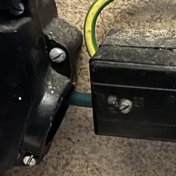

I thought I'd post an update now I've had the work done.
The sparky installed a 14 way FuseBox CU with surge protection, 8 compact RCBOs and 6 blanks. He said he's been using FuseBox kit for a while and hasn't had any problems.
I also had a new meter installed and the incoming fuse and (ancient) head upgraded from 60A to 80A (the installers said they don't fit 100A fuses any more). Along the way I learned the incoming cable is 3-phase with only one live phase, and it comes (underground) from a telegraph pole in the field out front.
