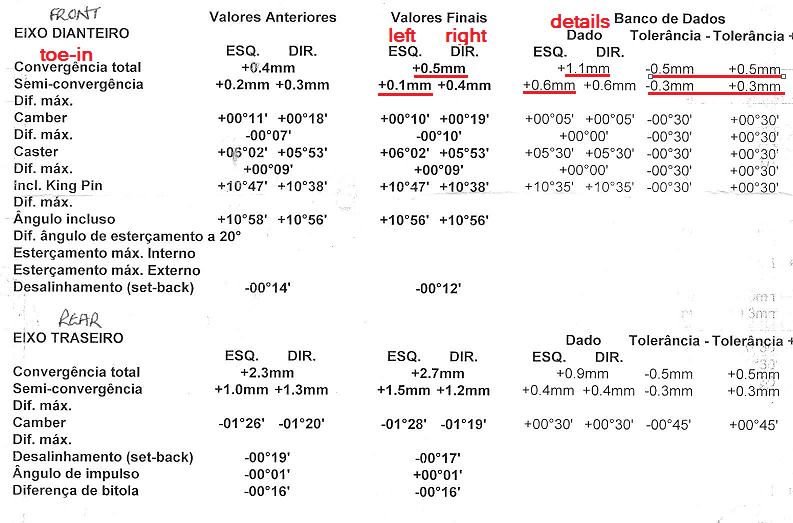

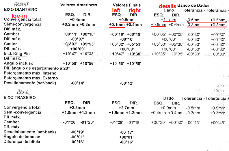

There was a wheel alignment print-out from last November with the documents when I bought the car.
It shows the required toe-in values and tolerances and the settings made. Left wheel is not even within tolerance and the right only just.
So much for precision of the centres - as I have found before.
Correcting these adjustments would cause the steering wheel to move even farther to the left.

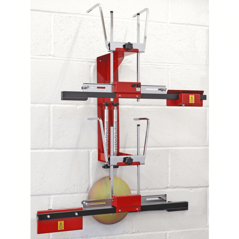

I use these ones. Super tracker ST100. Basic, but they do for me.

Can you post-up a scan or screen shot of the readout on here, and we can have a look?

Yes, here it is with the worst bits underlined.
I suppose anyone satisfied with that may well have not bothered with the steering wheel position.

OK, so that doesn't look too bad to me at all. If I'm reading it correctly, (and assuming the sign convention is the same in the country it came from as it is here), toe-in is positive and toe-out is negative. So you're looking for a total front toe-in of 1.1mm, give-or-take 0.5mm, which means a total toe-in between 0.6 and 1.6mm. Your "finished value" has a total toe-in of 0.5mm so it could do with an absolute smidgen more toe-in. Frankly, I wouldn't expect to be able to feel that if I were to drive it. Your front tracking is set a bit closer to parallel than specified, so I guess the tyre wear will be minimised, but it might feel a bit vague in the straight ahead position?
The next row, just shows the figures "per side" - which, perhaps unsurprisingly, should be equal. In practice, of course, to go straight, you'll just end up tuning the wheel until they ARE equal.
You have 9 minutes of a degree more positive camber on the right than on the left. Is it a left hand drive car, by any chance? It's unusual to see a car with positive camber (wheel leaning outwards at the top when viewed from the front), but if that's what they specify, then fair enough. On most suspension geometries, it goes more negative as the wheel moves up on its spring, so it's possible that the left hand side is sat fractionally lower than the right? In any case, camber might not be adjustable on that car? You can see that the specification is for anything between half a degree positive and half a degree negative, so it's within spec. Likewise, caster and kingpin inclination (which is just as well, because they're unlikely to be adjustable).
Your rear toe, is worrying though. You're running a LOT more toe-in at the back than specified. Did they not say something about that?! Your total toe-in at the back, should be just less than a millimetre, (0.9mm +/- 0.5mm) and it's actually nearer 3mm! If it were my car, I'd start trying to sort the rear toe before I did anything else. I'm not familiar with the rear suspension on a mid 1990s Previa, but is it semi-trailing arms? Sometimes, they have "snail cam" bolts that can be slackened off and rotated so that they twist the arm on its rubbers to face more inwards or outwards to change the toe. Make sure that the rubber bushes in the arms aren't worn out, before you do anything else, because otherwise, you'll be wasting your time trying to set the toe.
I think that's where I would start if it was my car. Sort the rear toe and then see where the steering wheel sits. If it's still crooked, a small tweak on the front toe-settings should sort it.
