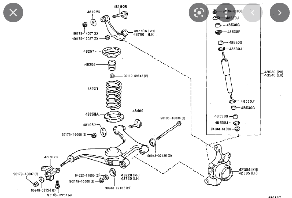

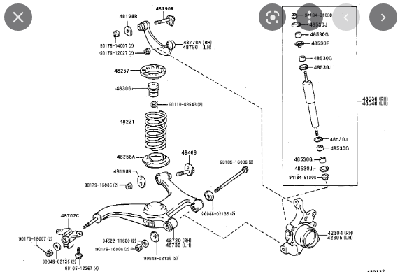

Can you post up some photos of the rear suspension? Also, is yours definitely a Previa? (I think the same vehicle was sold elsewhere in the world as the "Estima"?
Yes, will do but it looks like this.
Definitely had the lower offset washers (toe) and presumably the top ones (camber) too but did not notice when I lookeed.
Yes. :) TCR11L-RRSGKW

OK, it looks like 48409 might be one of those "snail cam" bolts that I mentioned, and I think that will be for adjusting the toe. There looks like there might be another one right at the top for camber. I can't make out the part number.
No photos needed. That's good enough!
