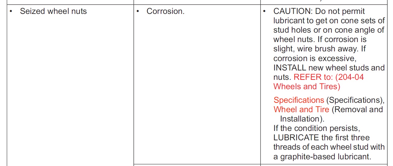

This is from Ford's own Workshop Repair Manual (for a Focus) that staff use in the dealerships. The lubricate vs non-lubricate gets a 'bit' more complicated!!
So, no lube where the nuts contact the wheel. Yes lube, but only a little, allowed on the threads.
May I ask - why?
