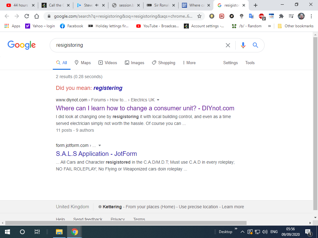

If changing a consumer unit by the book, then looking at £500 plus for test equipment, also problem getting it officially isolated. I did look at changing one by resigistoring it with local building control, and even as a time served electrician simply not worth the hassle.
Of course you can break all the rules, but a collage will not show you how to do it wrong, at least I hope not.
I had to look up that spelling as I was questioning it myself...:LOL::LOL::LOL:
It depends if using PC or Tablet, with PC it underlines what it thinks is incorrect in red, and allows me to change it if I think it is wrong, but the Tablet just changes it, and I have to watch to see it has not made errors, I am dyslexic, and do feel some was having a laugh when they made that word, what a word for some one dyslexic to spell, in the main I see a word is wrong even when I can't work out what is wrong, but of late google Nest Mini has been used to assist spelling, but missed that one.
