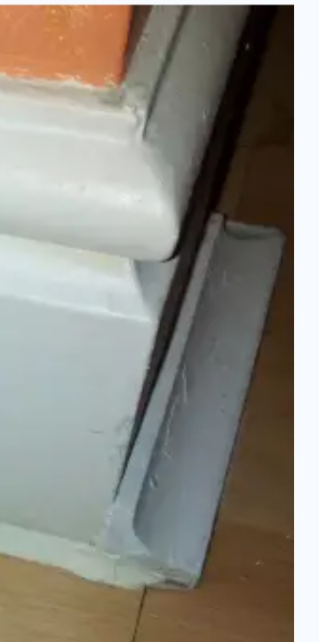

How else can a relatively consistent bead be made? Tool and tape were used. The jagged edges were cause by tape lifting. It's not a problem unless you nitpick with a magnifying glass. The gap between skirting and floor was not suitable for filling flush with the floor and a 45 degree bead was used. The end of the bead was tappered/blended with the thumb dipped in dilute washing up liquid. The floor is not under the skirting, it was cut with a gap from the skirting.

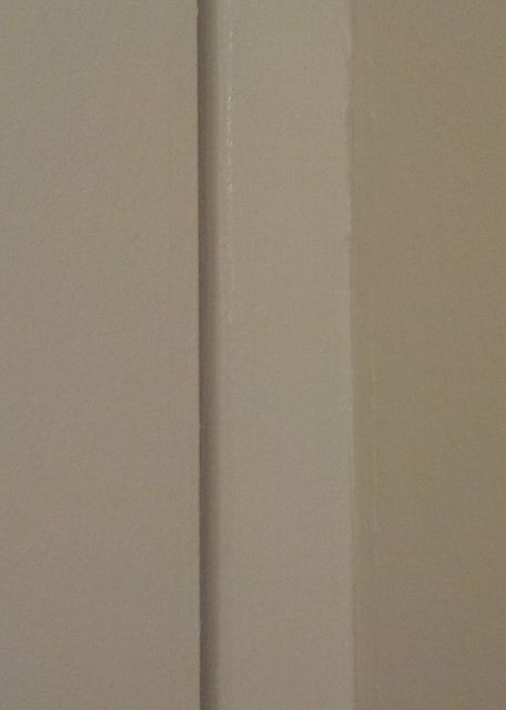

Here's a "de-cracked" door frame to plaster wall joint. Impression of the sealant can be seen (lossy image on this site removed the detail) on the plaster wall side where masking tape was lifted off. People can nitpikc, but I am happy with the result. The joint is subject to small movement when the door is pushed, pulled or slammed. Nothing but hybrid will work.

I agree that MS polymers are best in that situation but I disagree with your (blanket) statement that regular caulks are inferior products.
MS polymers are incredibly sticky and can be difficult to tool. BTW, washing up liquid does not work as a release agent. Washing up liquid works with silicones.
If I fit skirting boards, I will use a thin bead of caulk where it meets the wall. Other things being equal, I would not even consider using MS polymers. The caulk will be faster (and cleaner) to apply and a 10th of the cost.

You can disagree, but it won't stop me throwing them all out. Hybrid is one size fits all. It's not only superior. It's superior x 10.
I don't seems to have trouble tooling. I can multi-pass on the tooling after curing if necessary. Washing up liquid stops the stickiness to the finger or tool.

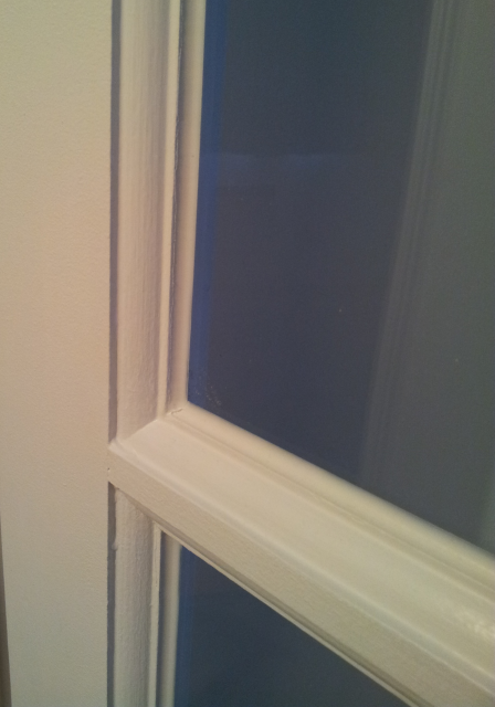

Not if you have experience and technique. EB25 used like silicone on interior glass here. Unlike silicone, this will never fail during its lifetime.
