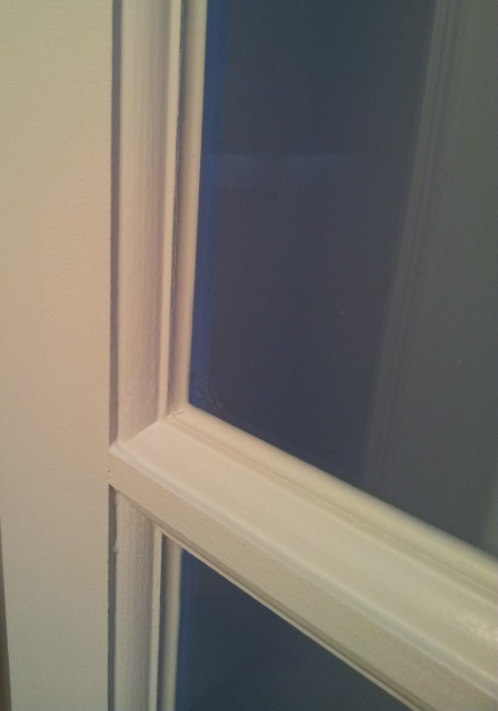

Not if you have experience and technique. EB25 used like silicone on interior glass here. Unlike silicone, this will never fail during its lifetime.
I agree that looks neat and tidy. What about the other rough images that you posted? Oh.... it was the "tape cabal" that tried to make you look bad?
