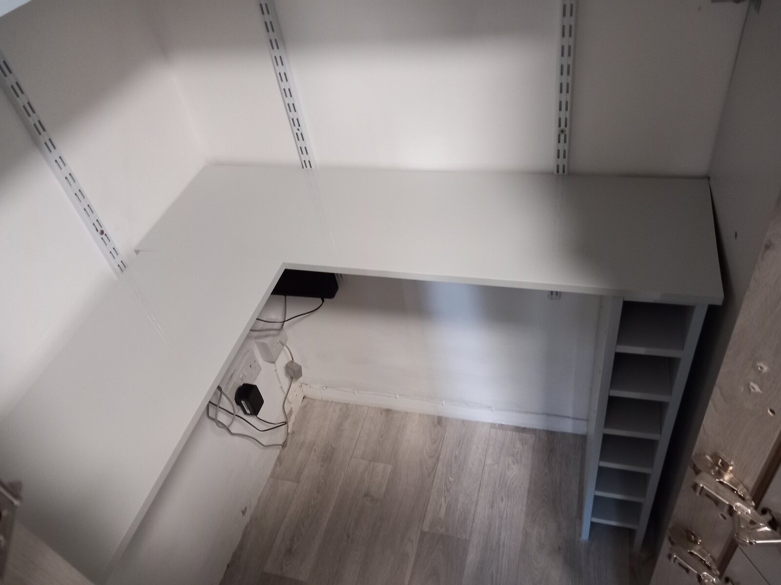

Ok so just take out central support panel like foxholes said. Perhaps some supporting baton at back.

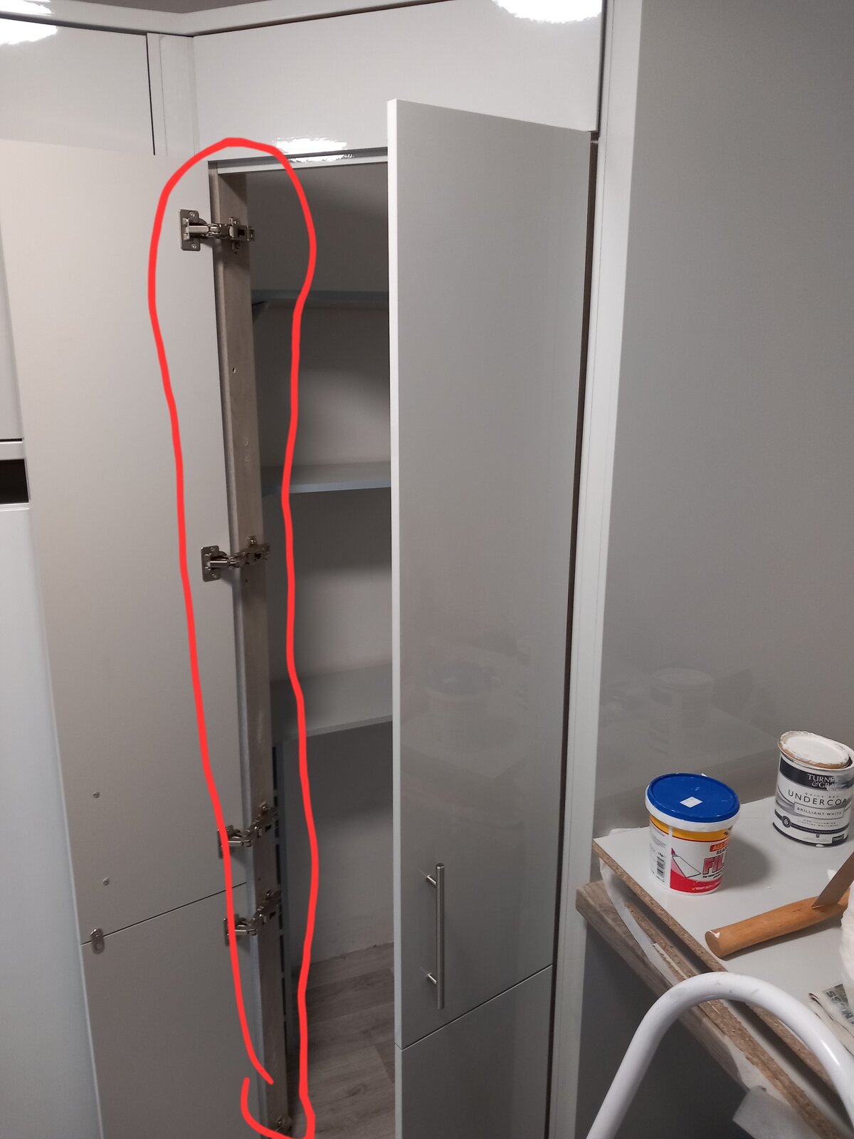

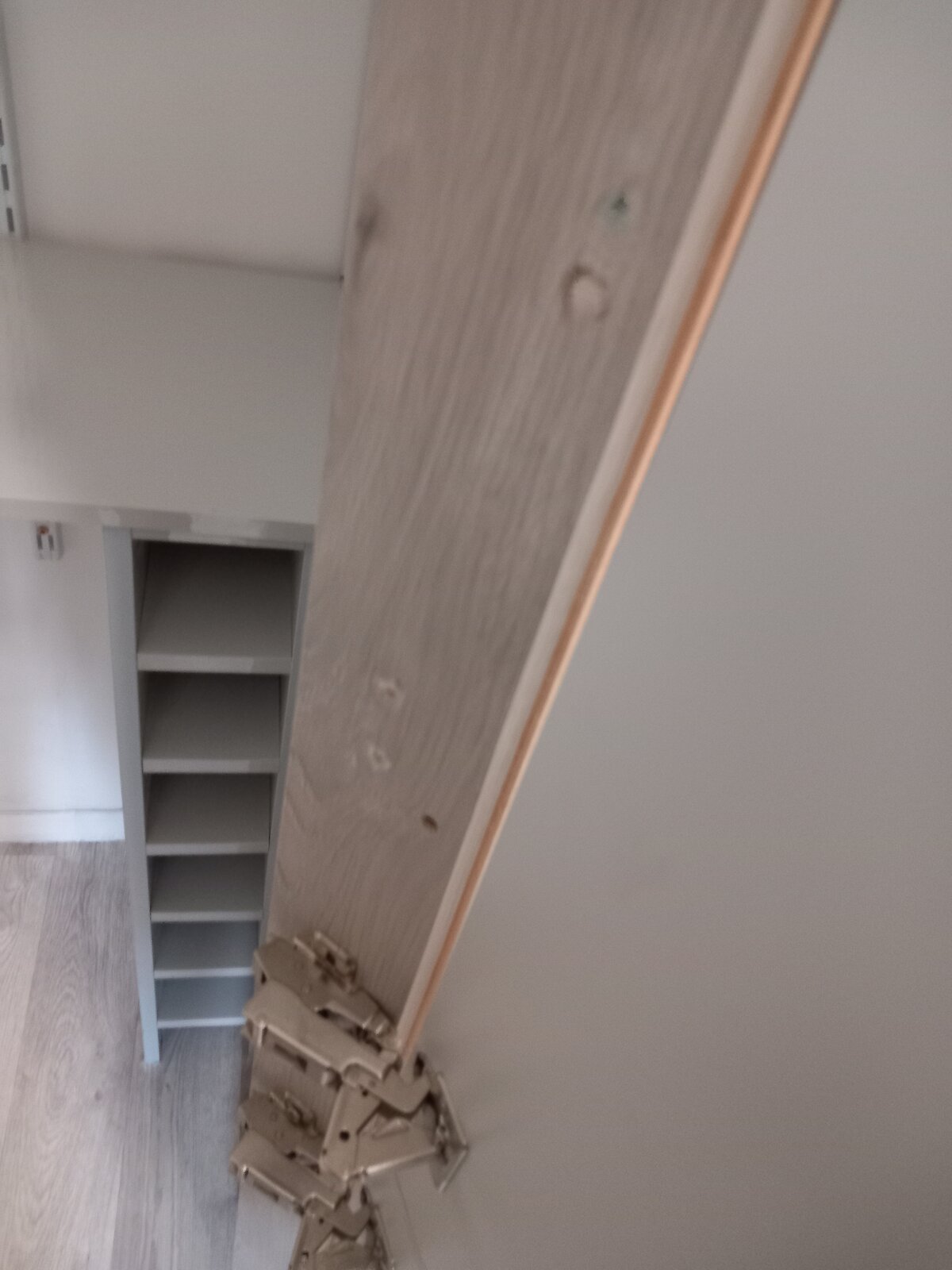

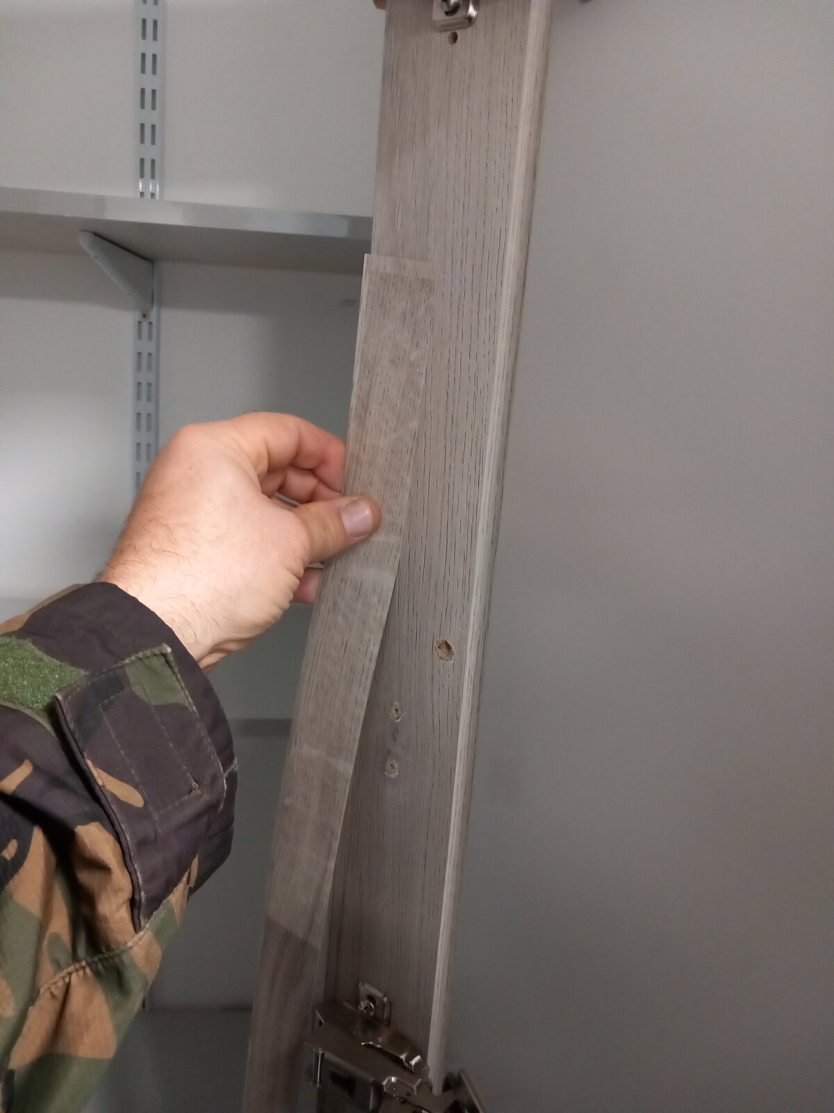

in circled photo both sides of cupboard (with euro hinges in) has holes all over. Can this be replaced or holes covered with a strip glued on?
You can buy purpose made plugs for the task, also self adhesive cover pieces (called FastCaps) or even use coloured wax, mixed to match as required. You can also fill with a near match 2-pack wood filler then tone in with coloured timber repair pens from firms such as Konig. Lots of ways to do neat repairs
As a handyman you really need to learn about a few of these techniques, so take a good look around the Konig website
When filling holes in tiles, I often use water based tubes of artists' paints and mix them in with 2 pack filler. It remains tackier than regular 2K filler but can, eventually, be sanded or chiselled back. If the colour is very light, rather than using grey filler I use the Tetrosil Stone Fill, it is honey coloured and the catalyst is white, requiring less acrylic paint to be added.
You end up with a uniform colour but it is possible to tweak it if you want a multicolour/grained finish-but pretty hard to. In fact, I have never attempted to grain it, too much hassle, but doable.

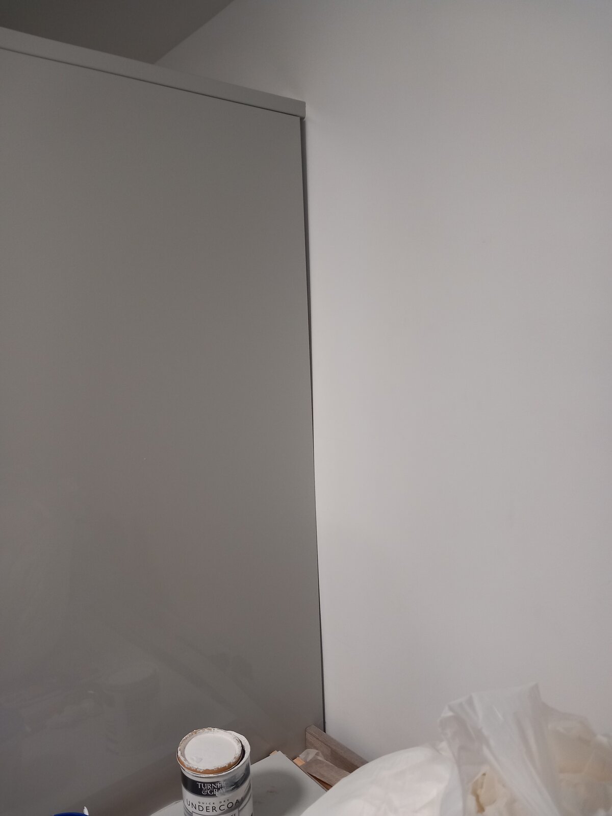

Got a shelf that has an unequal gap, shall I scribe it to side of panel and cut with a trend triple chip blade in circular saw(as recommended above) and shift shelf over so
equal gap on both sides?
Also the unequal gap running down side of panel on wall which wasn't scribe to wall, is there a quick way to hide it? E.g a strip or something

If the kitchen has been fitted correctly there will already be supporting baton to any open expanse or worktop .
No baton, could one be fitted underneath the middle upright removed?
Good job. I can't stand musical worktops!
There should be a timber batten fixed to the wall. TBH one of your photos seems to show just such a batten
