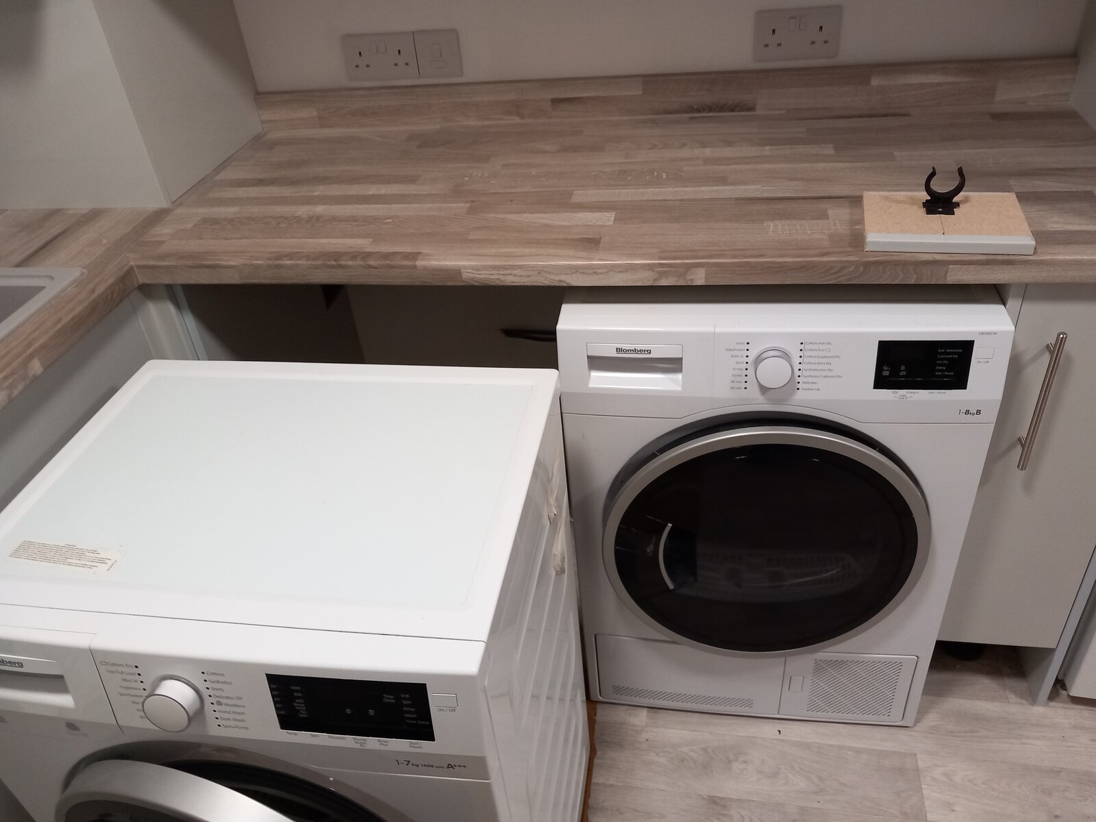

Central dividing board out, long support batten underneath at the back, and if necessary, left hand side support panel out with support underneath left hand edge of worktop.
Will probably reduce load bearing capacity of worktop but guaranteed to fit machine in.
I'll do that 2 x1 baton butted up to underside while it's in situ. Then take out central dividing board. How would you support left hand side if left hand side support panel comes out?

Just need to get washing machine to fit, don't worry about anything else and plumbed in

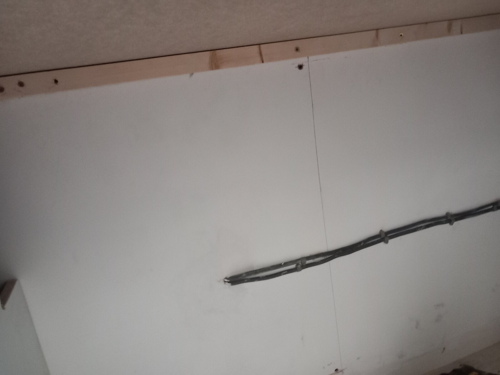

Nice photos. Care to fill us in on what we are looking at? And what questions you have for the brains trust?
It fits now and there's a baton under the worktop.
The middle upright has been removed which separated the two machines
Thank you for the explanation. They say a picture tells a thousand words, but at the end of the day that is just a saying...
Is there a foil protection strip fitted on the underside of the worktop above  both machines? Without one the top will possibly warp over time

There is indeed a batten under the worktop but in the photo it doesn't appear to be touching the worktop from the left hand end to a point just over mid way along the worktop. If that is the case then it was a bit of a waste of time fitting it.
Don't worry, in time it may "self level"
