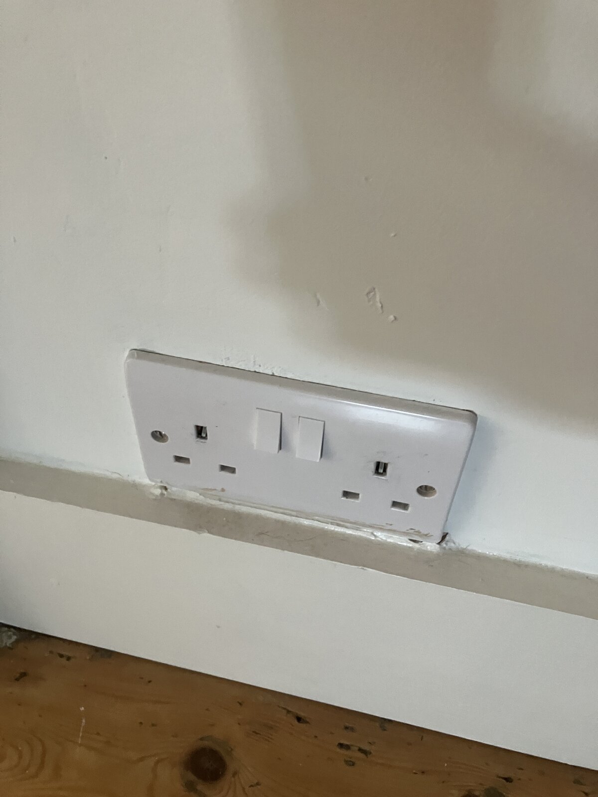

Hi there,
Finally getting around to sorting this out... we had house rewired/electrics replaced a couple of years ago, then skirting boards installed more recently. You can guess what happened... see photo! I think what I need is to install 'spacers' like the below? Am I right in thinking that basically any 2-gang spacer will fit any sockets, and that it's an easy job to install, nothing more than a screwdriver needed? I know the colours and shape might not perfectly match but the current situation is horrible.
Thanks!
Basically, yes, but some will fit/match, better than others.. You will also need, longer screws. Turn the power off, when you tackle it.

OK brilliant, thank you! And is it just a matter of pulling the face plate off, slipping the spacer over it, then re-inserting the screws? Most of the sockets are hidden away so I'm not too bothered about looks, but in one or two places I could replace the whole face plate for looks I guess? Would it be paranoia to think that's an electrician's job given my lack of experience?
It depends how much slack there is in the wires. Sod’s law there will be zero slack and you’ll have a nightmare. Unscrew it now and check.

It is a bit of a puzzle - the house isn't that old (late Victorian). It wasn't a problem before we had the old flooring remove and so new skirting boards installed, and the ex-wife chose some very chunky skirting boards. (Which to be fair, do look good.)

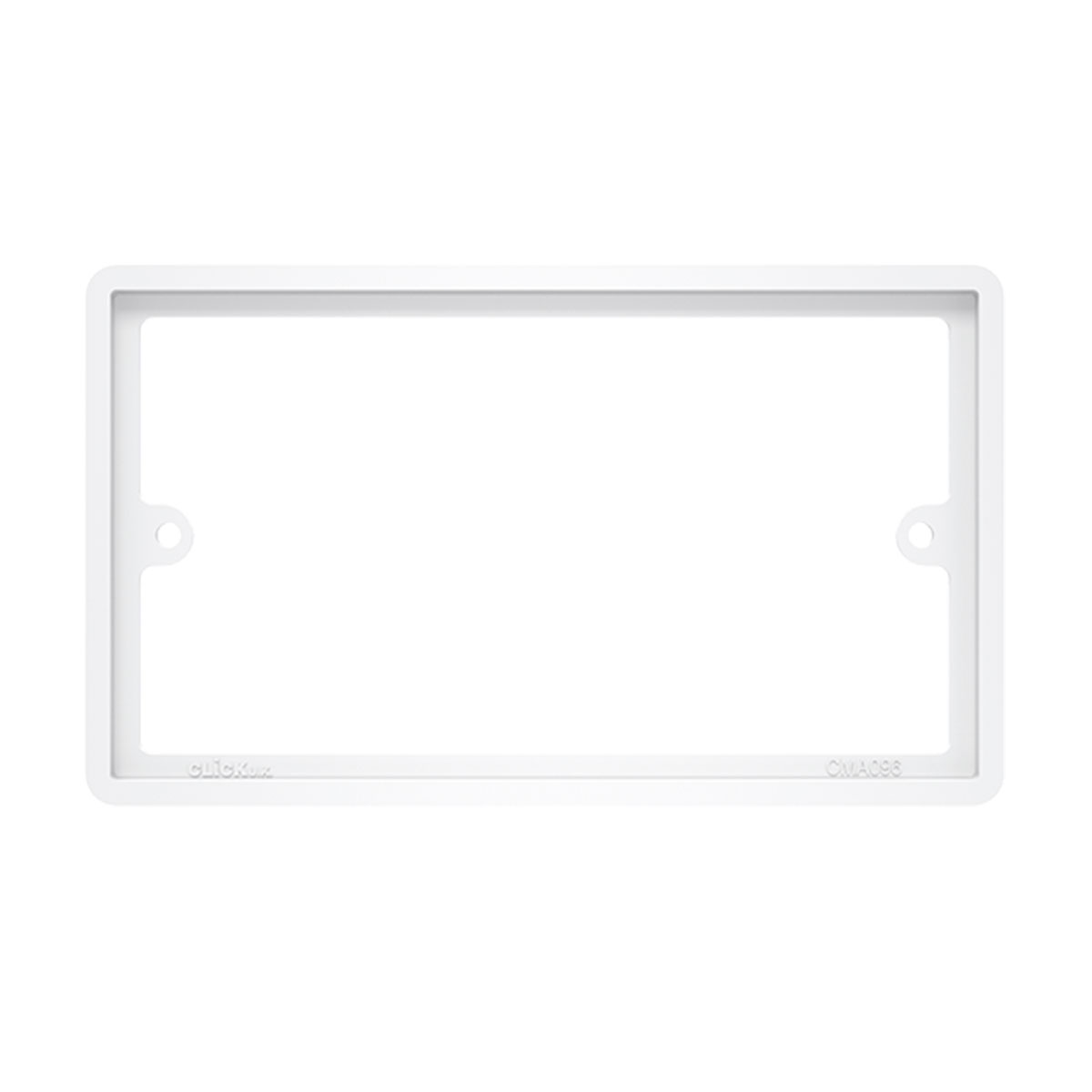

Unlike the single switch/single socket version of these spacers, the version which fits a double, can often be simply eased over the socket, avoiding the need to disconnect/reconnect the wiring.
Yes, that's sometimes the case. As you imply, with the single-size ones, one inevitably has to disconnect/re-connect the wiring.
However, I think the comment (about 'lack of slack') to which you were responding was referring to the problem that existed if there were so little slack in the conductors/cable, that they would not reach the terminals of the accessory if it were moved slightly forwards by a spacer.
If the cables were tight, the OP might have a better chance of slipping the spacer in, without disconnecting, than of disconnecting and reconnecting after adding the spacer.
Agreed - if it's possible. However, as I wrote, I think it may well be impossible to get a spacer over the face of a 'single socket', given that they are made out of rigid/brittle material which has no 'give' in it. However, I may be wrong.
Quite so.
A similar example is when using a "Yoozy Box" - |Something I do very rarely, to retro fit a twin socket without disconnecting and fitting the yoozy box with care can be done quite easily but a single socket or FCU is not easy if actually possible at all.
