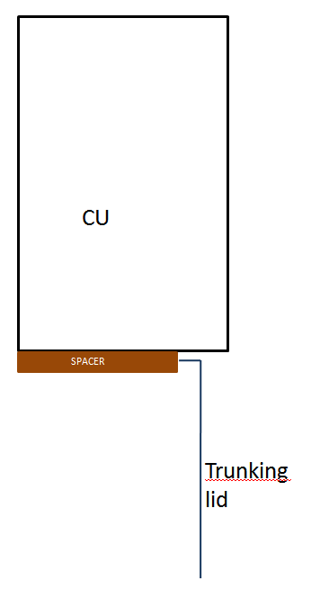

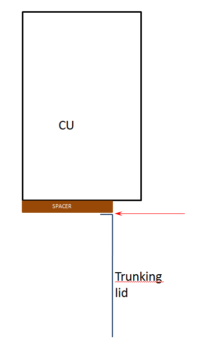

WOE would you end up with a gap like that?
Viewed end-on:
or
With the one on the right, could you really not manage to get that gap down to 1mm?
But instead against the cut ends of the trunking,
So what do people do when they have to cut trunking shorter?

Well BAS, as I already pointed out, by the time you have made and fixed the spacer, you've done most of the work anyway. So for the sake of a couple of minutes to drill out some holes with a hole saw, and then run the nibblers along the slot - job finished as I've done it.
Your way: You still have to make the spacer, you still have to cut holes in it to match the holes in the enclosure, you've MORE work to do to fix it since many materials will sag and open up a gap (IP4x gone) if not fixed as close intervals, and then you have to fix two short pieces of trunking on an uneven wall that's a PITA to fix things to (no, you really can't drill drill a hole and pop a plastic plug in) and make sure you get them aligned.
That latter step would probably more than lose any saving made earlier. My way, I had everything bolted together, so just put the trunking back into place, mark the holes for the CUs, then sort out the fixings. I admit to having cheated a bit on the fixings ...

Wake up at the back :rolleyes: IP4x kits in use for that very reason. Standard trunking and fittings are IP3x, add the IP4x kits and they become IP4x. The IP4x kits also cover up the joins in the lidding (so everything looks a lot neater, and hold the ends of the lidding which is useful when (as is normal) using other than full lengths.
Clean up the cut edge, then attach the trunking to a fitting. There's no exposed edge (two sheets butted edge to edge, or overlapped and bolted together with the manufacturer made edge showing) sticking out to drag cables across or to cut into insulation due to cable movement. Your way, there's an exposed edge that the cable need protecting against.
