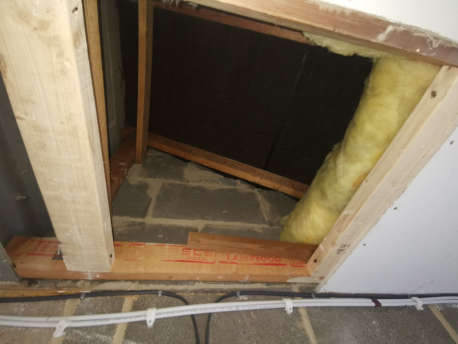

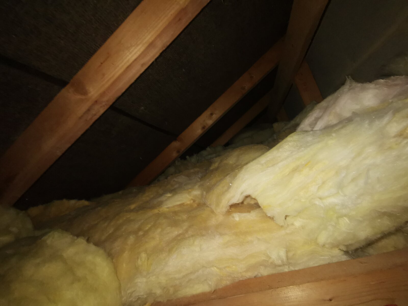

So this is what the area looks like, its all been plastered and everything now so would have to rip it all down to sort if needed.
Its at the front half of the room, total area is probably 2.5 x 2 metres i imagine. The back half of the room has a bedroom above it.
The soffit board is mostly covered by the new window so unable to fit soffit vents, i know some insulation was also put in the eaves but there is no vents there or anything.
The adjoing roof space has vents from when the house was built 30 years ago, HOWEVER as you can see it has a wall so the vents wont be doing anything for this section.

Not every roof void gets condensation issues. Most have enough draught to prevent the heat build up that cause it, and to ventilate it.
There are whole housing estates and millions of roof voids in the UK which are unventilated by design or by default, and they have no issues.
That small void has a very low risk.
And if it helps, I'm sitting under one right now.
