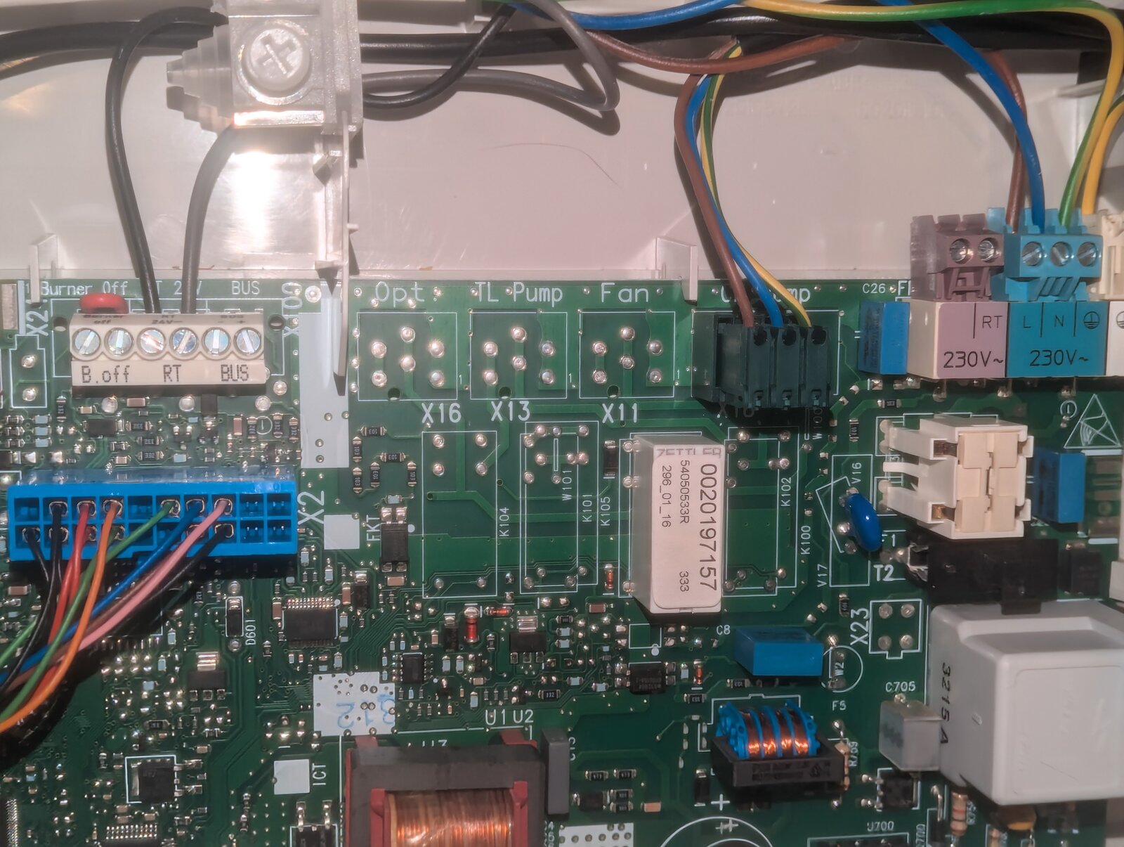

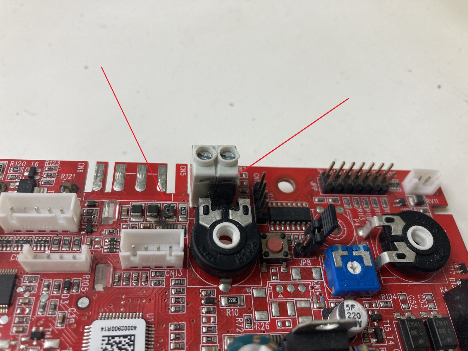

If someone inadvertently sent 240v to the 24v RT connections on their Vaillant ecoTec pro 28 boiler and happened to blow the 3A fuse, what are the chances the boiler's completely bu****ed?

I can't answer for the Vaillant ecoTec pro 28 boiler but I have seen a lot of equipment ( indudtrial and domestic ) that has protection designed in.
Protection that can "tolerate" overvoltages to be applied without allowing the overvoltage to cause significant damage to the equipment
A fuse won't blow under a higher applied voltage scenario.
Any reputable supplier should have some sort of circuitry to prevent over voltages. This can be easily done with a TVS diode or similar.
If it is anything like this Glow Worm Ultracom, then the outcome won't be good - new PCB time...
Vokera boilers also don't appreciate the extra voltage...

The voltage was applied after the fuse.

That's what I'm hoping. Mainly because I do know that there is a 230v RT connection and I'm hoping I can just wire to that instead of the blown 12v RT.

The 12v RT is on the top left of the PCB, 240v is on the top right.
Just to add, there is no sign of scorching, smoke, etc on the front or back of the PCB but there is the smell of burnt plastics/electronics.
There's no sign of burning, scorching, or smoke.
But there is the smell I would associate with that.
