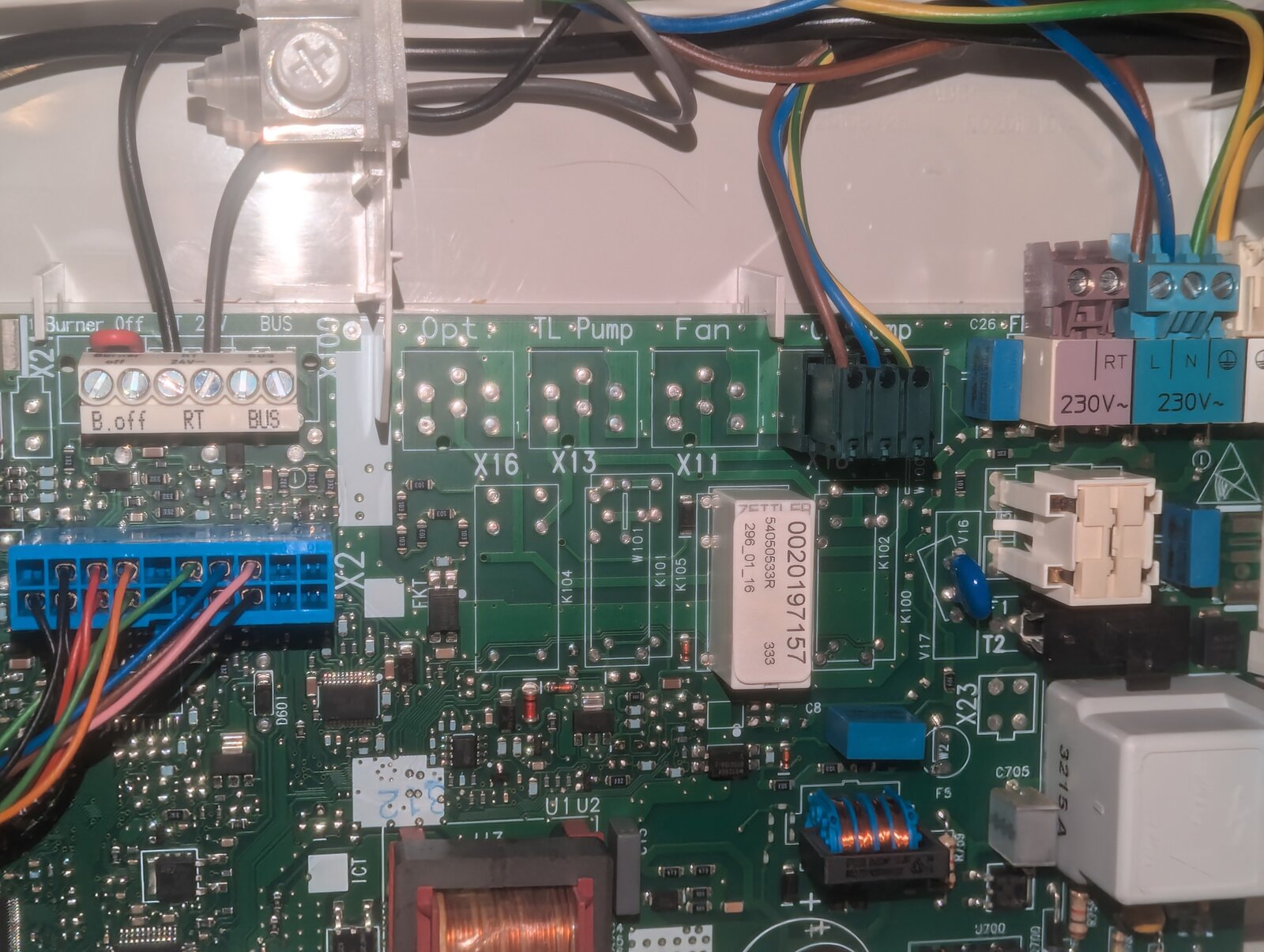

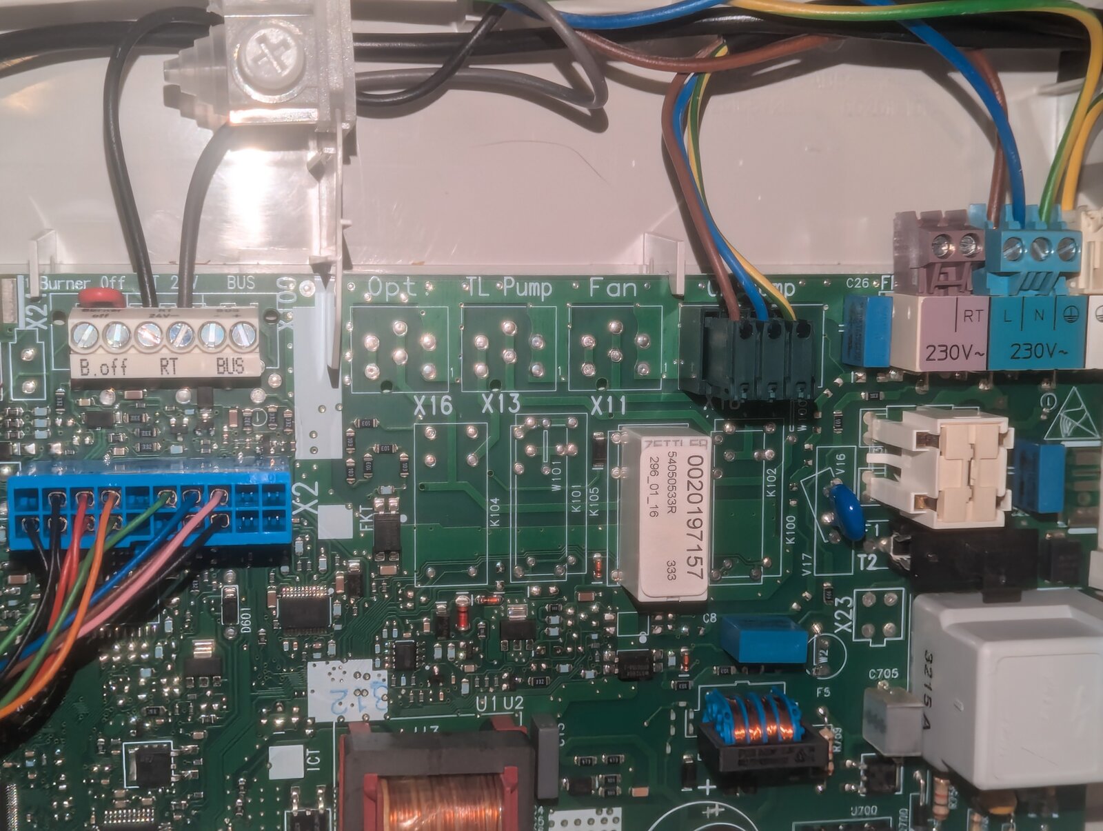

Will overvoltage damage circuit boards? (Ed.)
If that’s how it’s wired, how did you inadvertently send mains voltage to it?

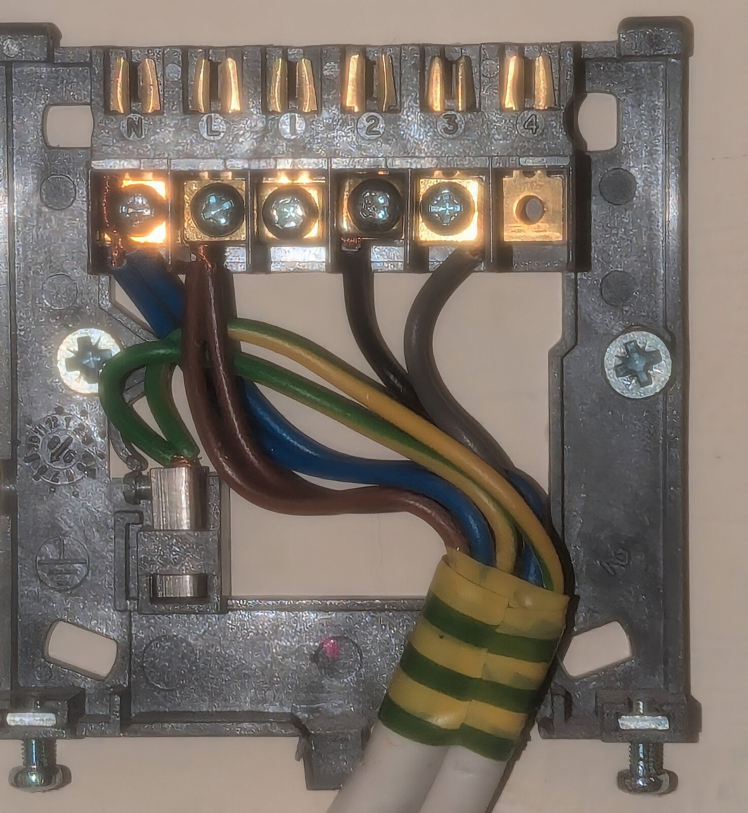

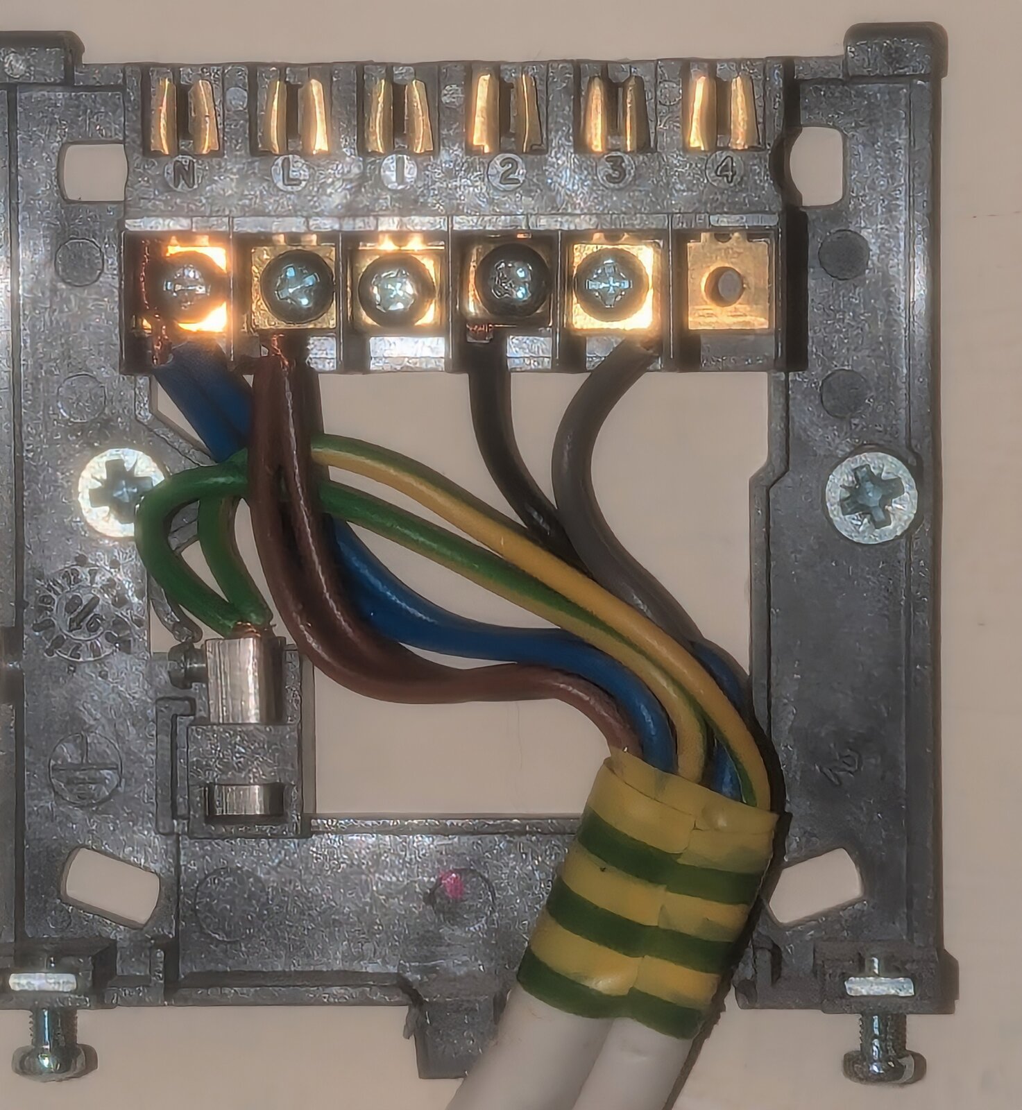

I replaced the hub with a Drayton Wiser unit and the CH wasn't firing (hot water was fine). After some research it looked like i needed a link between L and 1.
Unfortunately, I'm pretty sure that this sent 240v down 2, which were both connected to the 24v RT and not the 240v RT connections in the boiler.
Honestly, I had no idea 24v was even a possibility here and there was certainly nothing on the Wiser docs that suggested it might be the case.
Just to update - I managed to find a new PCB at a nearby merchant, and swapped it in.
I tweaked the wiring in the back plate (moved one of the RT wires from 2 to 1).
NO LINK to L
And it all seems to be working perfectly.
Have booked an engineer to come out and give it a service too.
A £230 lesson.
I got the wrong boiler when I googled, but note
so not sure if the Wiser should use the contacts at all? Should it connect to the little white connector block
on the back of the hub, I am not sure on this as there are more than the OpenTherm options, I know Wiser is OpenTherm, not sure however what your boiler is?
I did watch the instructions video on how to install frankly a bit useless unless the old thermostat used the standard back-plate. My boiler is a 230 volt on/off control, most oil boilers are.

There is an OpenTherm block but I have literally no idea what to do with it and, regardless, my 10 year old boiler is unlikely to have that feature. Again, I've no idea what these Bus connections are for. As a result, I've not touched it.
