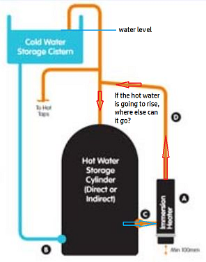

When the water is heated in the Willis it will become lighter and try to rise - like a bubble.
Assuming the pipe is small enough not to allow convection in it then the only way the hot water can rise is if cold water enters the bottom.
It could come from the storage tank but this would mean the water level in the overflow pipe would have to rise. As this is not possible, then the cold water will have to come from the cylinder - hence the heated water will make its way to the top of the cylinder.
This is a better diagram as the overflow pipe actually looks correct and higher than the water level.

.... then the only way the hot water can rise is if cold water enters the bottom. It could come from the storage tank but this would mean the water level in the overflow pipe would have to rise. As this is not possible, then the cold water will have to come from the cylinder - hence the heated water will make its way to the top of the cylinder.
I don't really get that.
Apart from anything else, if the hot water at the junction between pipe from heater and expansion pipe were to 'rise', it would have to 'rise up' the expansion pipe (probably causing water at the top to overflow into the storage tank), wouldn't it?
It would, but it can't, so it won't.
Seriously, how could it do that without drawing water in at the bottom? Gravity would then maintain the level in the storage tank and overflow pipe.
You have acknowledged that with a simple loop the water would circulate so what difference does the overflow pipe make?

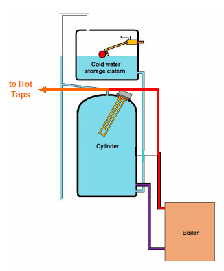

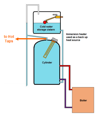

Indeed - I actually once had one. However, the water in the HW cyylinder will only get appreciably hot if the 'hot' feed from the back boiler enters the HW cylinder appreciably below its top, like this
However, if (as in diagram below) the feed from the boiler went to the outlet pipe at the top of the cylinder, although the taps would be able to draw some hot water directly from the boiler (mixed with cold from the cylinder), the water in the cylinder would not get significantly hot, other than (very slowly) by conduction ...
Kind Regards, John
I don't know where the heating pipe enters, because I have never had one, but I'm puzzled as to why it would enter halfway up. I cannot see the purpose at all, but it does demonstrate the principle. You said 'conduction', it is not conduction, rather it is convection - a convection current in water carry the heat to the cylinder.
Your back boiler would none the less, collect the hotter water at the top of the cylinder.
