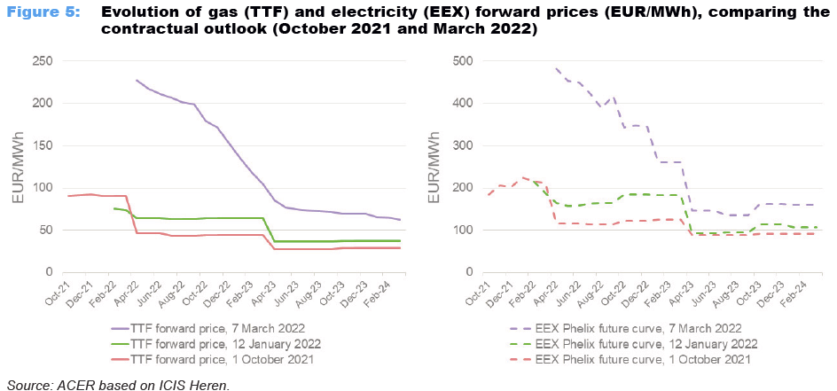

It looks cheap at the moment but if prices go as some predict:
it won't be quite so rosy.
I'd bet those turn out to be over optimistic.

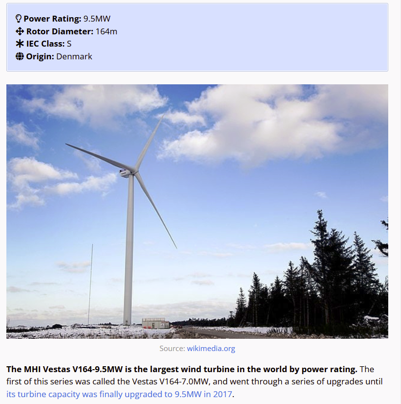

THis is out of date so there will be bigger , probably:
SIemens have some , onshore in Spain, 167m
What is your graph intended to convey?

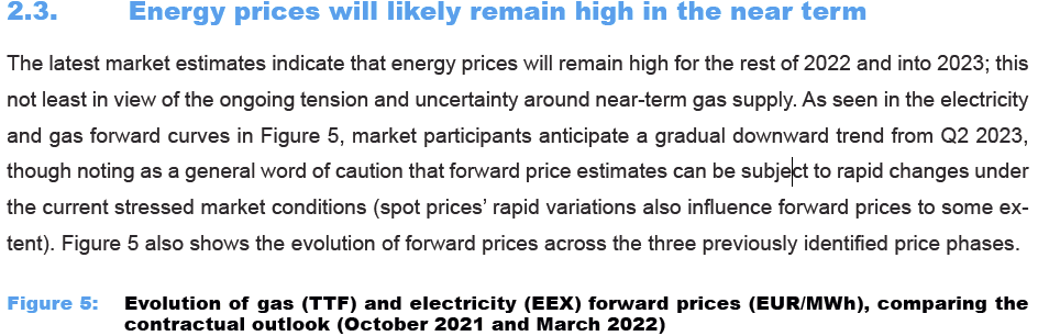

They do get paid the going rate, then they hand back the difference later. I believe quarterly
When Hornsea phase 3 is built in 2025 they'll be selling their power at the market rates then returning any above £37.50 to the government. If power is less than that then the government will top them up every quarter.
P15 of the ACER document you already have:

The graph appears to show prices going down, forecast to go down some more, and level off.
I didn't draw the graph, it's the one in the reference you gave.
Now that you've managed to read it, why are you questioning me? It means what it says.
