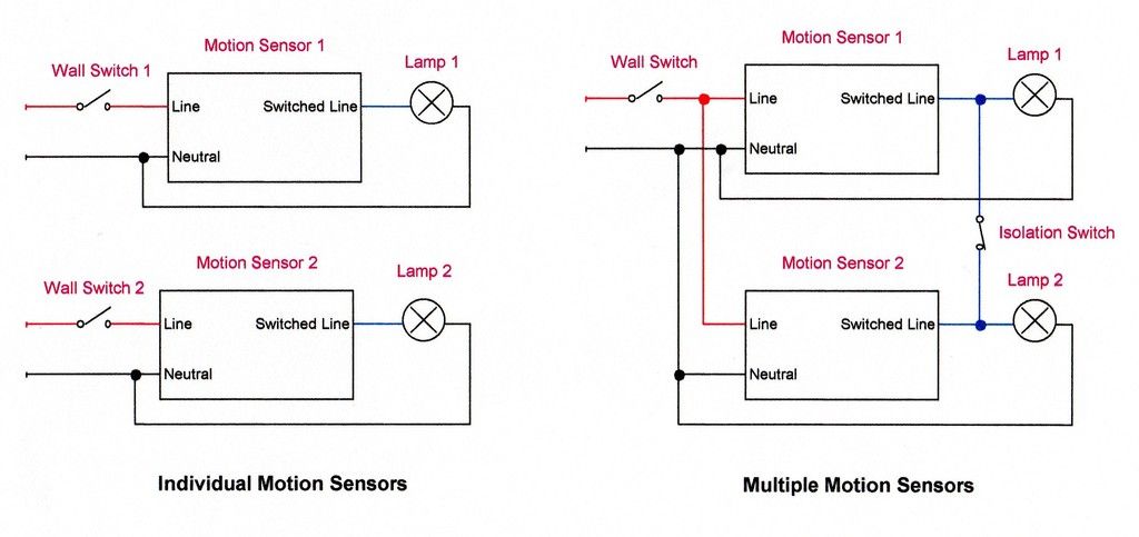

my two PIR security lights are already installed with a separate 1.5mm twin and earth to each light.
Can i simply connect the two L1 together with a single core cable OR will i need to require the system so that the second light is fed from the first with 3 C + E?
It is probable that the set-up which mstizomad now has is as pictured in the circuit diagram on the Left of the above - with separate Wall Switches, which may or may not come from the same Lighting circuit.
Simply joining the Switched Line outputs from both sensors would work but it would not be a good idea since, with one Sensor activated, part of the current from one Line would return via the Neutral of the other circuit - which may come from a different Lighting circuit.
It would be better to rearrange the circuit as shown on the Right, with all devices fed from the same switched circuit.
While the connection could be direct, I have found it preferable to include an Isolation Switch, in some accessible but not obvious location (such as in a garage cupboard.)
This is because it makes any sensitivity and timing adjustments for each Sensor easier if there is no possibility for the other Sensor to switch on the Light while one Sensor is being adjusted.
(If there are more than two Sensors controlling multiple lights, an Isolation Switch would be necessary for each Sensor.)
