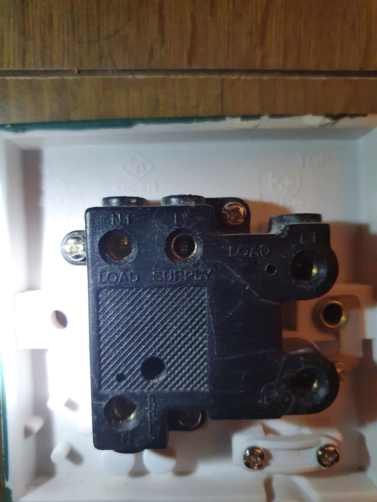

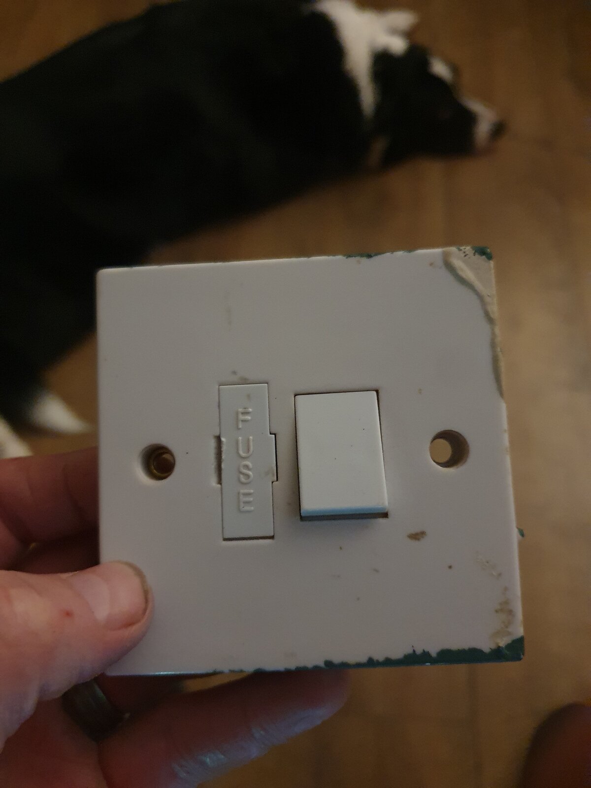

Take a look at the next 2 photos, this is the original fused switch I taken off, for some reason this one work at all now , could someone tell me what wires go were ? Thanx

You need to establish which cable goes to the light.
I take it all three cables are the same size? They look the same size in the pictures.
There are 3 grey sheathed cables present at the switch position. One of them goes directly to the light ,can you identify which one it is ?
So you're going to just connect it up without the fuse?
I will double check tomorrow when it gets lighter outside lol
The fact two earths are in one sleeve, the remaining earth in another sleeve may help identify the 'load' cable, if the wiring pictures you took can be closely studied.
Better still, have you got a multimeter?
