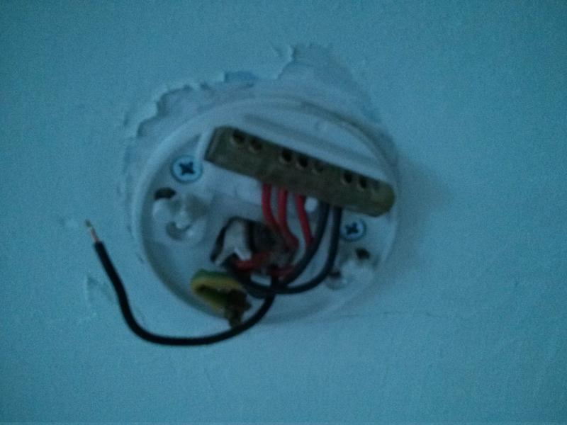

I've got one wire in, one wire out and one wire coming from the light switch. Unfortunately, I labeled the wires when removing the old light fitting. But when i pulled the wires of the labels came off. Do I connect the brown or blue wire to the pair of black wires? Thanks

If this is for the chandelier you posted earlier, then you may have enough space in the chandelier cup to connect these cables via a small connector block with 4 terminals.
One for your live loop - 3 reds
One for your neutral loop - 2 blacks
One for your earth loop.
One for your switch live (black (put a red tape around it))
Then use the other side of the connector block terminals to connect:
Your lamp live to the switch live (black with red tape)
Your lamp neutral to the neutral.

Yes. The wire in and the wire from the switch are not long enough to reach the chandelier in its new location. My idea (perhaps not a good one) was to use a connection box in the loft where the old light fixing was installed and extend with the chandelier wire (I've got loads of spare). I am happy yo use a connection block as you suggested if I find a safe way to extend the in and switch wire in the loft. Is there a way to do that (I have no idea what is allowed and what is not)? Thanks
If you have access to the loft area then use can use one of these with the connector blocks I mentioned. Use a piece of Twin and Earth to extend the switch live, neutral and earth from the chocbox to the chandelier cup and use another small connector block there.

If you do not have access to the loft area then you can use one of these:
http://www.tlc-direct.co.uk/Products/ASJ804.html
Connect it as described earlier with extended T&E to the lamp - push it up into the space (hole) by the old ceiling rose.
