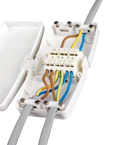

Yes, I got that :) I got the j804 jb. but i cant work out how to fasten the wire in the terminal. I thought these were push terminal but it's not. Anyone there let me know how to do this?

Yes, they're just 'push in' terminals. If you have a solid wire, it should just push in (have to push quite hard!). If that doesn't work, or if it's a stranded wire, push down (again, quite hard) with a screwdriver on the plastic bit with a 'cross' above the terminal hole and, whilst pushing down, the wire should just slide in to its hole.
I take it that your JB looks a bit like this (this is a J803, with only 3 sets of terminals - your J804 will have four sets):
