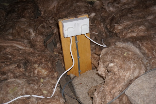

Hello, was thinking this would be straightforward.
Three months back my electrician installed a new fused spur in the attic, going into a double socket (pictured) into which I've got two Herschel infrared heaters plugged in. Heaters are on the ceiling of the bedroom underneath. Now I want to replace the Herschel wireless thermostat I've been using because it's rubbish frankly - set desired temp to 20c, it only switches on at 19.0c, off at 21.0c, even though it measures in 0.5c increments.
I've got a Salus RT510RF which can switch on off in +/- 0.5c or +/- 0.25c. I thought it would be a simple job for me to put install the receiver before the socket, so it switches the socket on and off. But I'm not sure about the wiring. The spur socket and heaters all have an earth but not the Salus receiver, and nowhere to 'park' earth either.
So would I run L and N from the receiver, then have output to the socket at NO and COM, and sleeve the earth wire from the spur directly into the socket?
Back of receiver pictured and this is the wiring diagram pic I have, https://thumbsnap.com/JUA3ltS8
Cheers.
Where does the supply to the sockets come from?
What is the rating of the heaters?
Are both heaters on the same plug?

Thanks for replying.
The supply is a new fused circuit on the circuit board. Only that double socket is connected so far.
Heaters are 1 x 600w and 1 x 400w. They're on different plugs, the two in the picture. We set it up this way so I could swap the heaters out for different ratings by just unplugging them.
You would not wire a socket to N/O and COM.
They are basically a Live in and a Live out and not used for a Neutral.
Though you will need a Live and Neutral to power the receiver, any earths would connect together in a connecter block
Running your two heaters through it will overload the contacts as said above
How is the existing stat connected
The Salus is only rated at 3A so you cannot operate both heaters with it.
Hmm, yes thanks. I've checked the Salus specs, it says "16A relay switching". A site selling infrared heaters says the Salus is up to 16A, without mentioning the relay. So I'd need to get a mains relay to control the input to the sockets?
Ah, I beg your pardon.
Yes, the receiver is 16A; the thermostat is 3A, so ok for what you want.
What about wiring it like this:
Existing socket unaltered >> one plug >> one cable >> receiver >> both heater cables.
