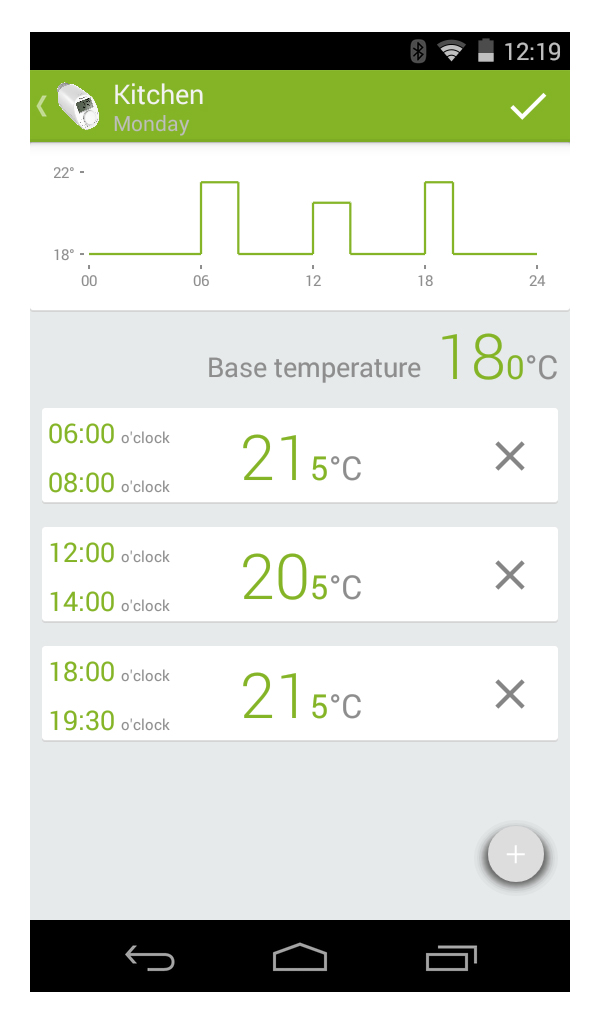

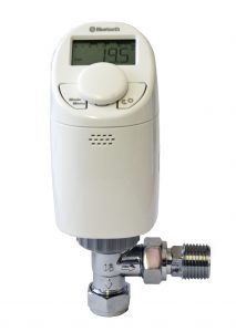

I do reach down and turn radiators on, the electronic TRV head EQ3-Straight-213x300.jpg has two buttons and a dial, it has a schedule set for when I would normally used the room, and also the comfort and eco is set, so if I use a room early press one button right hand side of dial and it moves from eco to comfort, the head cost £15, try finding a programmable thermostat for that price?

You can split programmable TRV heads into three groups, very cheap start around £10 like the eQ-3 and terrier i30, next wifi enabled allowing geofencing, and finally linked to wall thermostat.
Geofencing and occupancy detection I have not found that good, for a TRV to adjust a room temperature takes around 2 hours, any faster and likely they will over shoot, and I do not live 2 hours from work, I am not impressed with the Energenie TRV heads at around £45 each because you can't adjust manually, I don't walk around the house with a phone in my pocket, I want the option to manually set temperature up/down as well as with phone, the bluetooth on the eQ-3 is only used to make it easier to set up, only reason you NEED bluetooth is if two radiators in one room and you want to pair them so both work together, but I only paid £15 for bluetooth version.
So setting slots
I can ensure at those times the TRV returns to a low setting after I would normally use the room, also it has open window detection, so if I come home and leave the back door open while unloading the car, the TRV closes down for time set, in my case ½ hour, in many ways the cheap eQ-3 actually work better than the expensive Energenie, so I have 4 Energenie and five eQ-3 if a room is not used, it's not heated.
