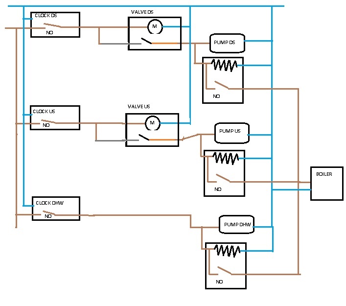

Wiring centre for central heating & hot water
That won't work. If say 2 zones are on, when one is no longer calling the relay will be latched on by the other zone. You must take the live in to the relays contacts from the supply not from the switching circuit. I don't know how the system is meant to operate so I can't comment further than that.
I see what you mean, the supply for the boiler ought to be taken from the permanent live through the 3 switches (2 zone and a relay) in parallel.
The thermostats ought to be on the control side of the zone switches / relay
Oops- left the thermostats off that drawing completely. Silly me....each should, of course, be between the relevant timeclock and valve (or just the pump for the water)
Oops- left the thermostats off that drawing completely. Silly me....each should, of course, be between the relevant timeclock and valve (or just the pump for the water).
And yes, see what you mean about the relays- so busy avoiding the loop from the boiler I missed that one. Drawing amended.....
There's another amend to make depending on how the pump overrun works at the moment.
And another option- with the relays buffering, there is no back linking to the motor of the valve via the valve microswitch. There is an argument that says the supply to the microswitch should be direct rather than via the timeclock/thermostat. Problem with that is if the motorised valve is manually opened then the pump will run for ever... if this is desirable (and in some circumstances it may be) then do it, if there were no relays involved then you'd have to do it (otherwise as posted above when more than 1 zone was calling they would latch on until all zones were off on the timeclocks)
