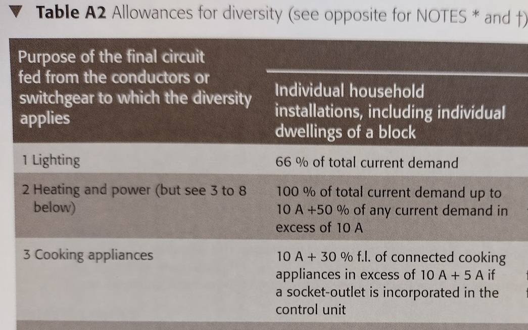

It doesn't work like that for cooking appliances.

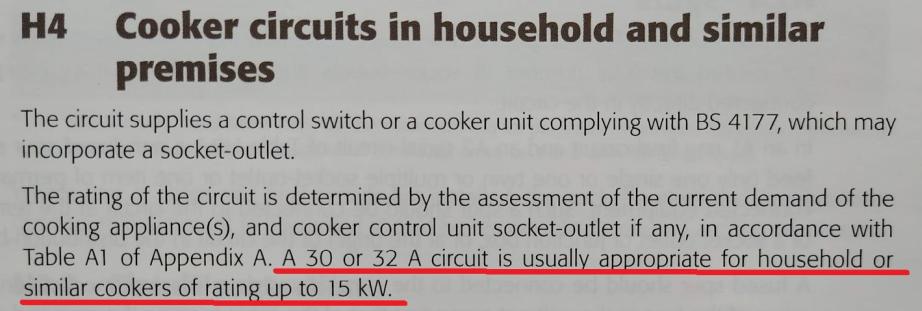

Because of 'diversity' a 32A cooker circuit can supply upto 20kW of cooking appliances.
Thought it was 15kw? Asking for a friend....lol.
20kw works out to 33 amps.
You might get away with 19kw.

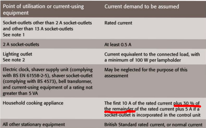

Some might say you can take into consideration "Maximum diversity factor" that not everything will be on at the same time. It will be at Christmas.
What nonsense.
You can’t apply diversity to showers and EV points
But cookers you absolutely can and DO
All in the current and previous editions of the On Site Guide.

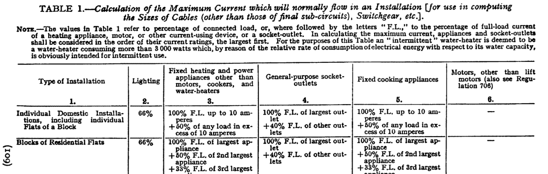

Previously in the Regulations for the Electrical Equipment Of Buildings starting with the 10th edition published in 1934 and contained in every edition since then until the information was moved in the OSG.
The only difference is that is was 10A + 50% long ago, revised due to cookers becoming more efficient as insulation was added to ovens.
It should be revised again as induction hobs are significantly more efficient than those with resistive elements.
Anyone calling themselves an 'electrician' or anyone who owns any edition of these publications from the last 90 years should be aware of this information.

20,000W / 240V = 83.333A -10 = 73.333A x 0.3 = 22A + 10 = 32A
I realise you were dividing by 230V but it is very unlikely that the Wattage quoted was at that Voltage.
