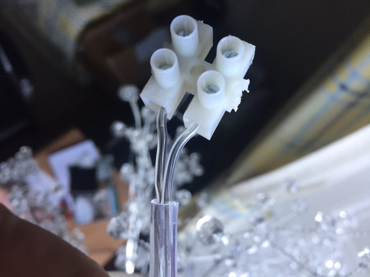

Hi,
I've got a ceiling LED light I'd like to swap out from a conventional bulb, but the cables from the LED light aren't labelled at all - they're just in clear plastic rather than blue/brown, with no markings/texture difference etc to tell them apart. From a quick Google it sounds like because it's a UK AC supply it'll make no difference which is connected to live or neutral, but wanted to get some expert opinions before I try it?
Thanks, and Happy New Year :)
C.
I presume you mean a whole new light fitting. What sort is it?
It's unusual to have clear plastic. Have you a link to the product or can you post a picture?
It won't matter which way round the lamp is connected.
That's alright - not what I was thinking of.
It says the 'shade' is plastic so that's ok but it does not actually say it is Class 2 - double insulated so no earth required.
The fixture material it says is metal but the ceiling 'cup' looks plastic.
As long as yours is the same with no metal parts touchable it seems alright.
Thanks for checking this out. The ceiling cup is metal unfortunately - I could line it with something before fitting though?
A better option would be to earth it by drilling a small hole and attaching a ring crimp terminal using a small nut and bolt or self-tapping screw.

As EFLI implied, its possible that the metal cup screws onto an earthed bracket.
