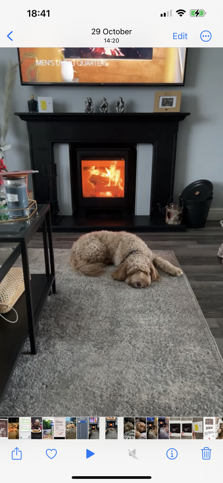

In my opinion, the current stove looks too large for the opening. It just doesn't 'sit right' in my eyes. I think the smaller one looks much better.
However, before deciding what route to take, I would compare the cost of replacing with the Allure 4 against the cost of any building work.
It may be that the supplier will give you a good part exchange deal against your current one.
For what it's worth, we have a multi-fuel burner which has approximately 8" either side and a good 12"-15" above. It comfortably heats our lounge which is approximately 14' wide x 28' long with a real wood floor. Dimensional size it seems slightly narrower and lower height than the last photo you posted.

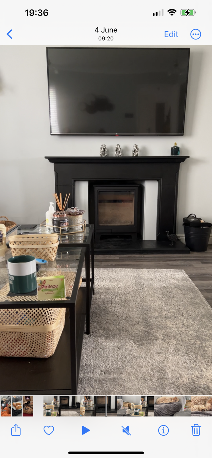

Based on my current set up do you guys have any photos of what would be a suitable set up in terms of space surrounding the wood burner?
I will send photos to the installer and say that’s what I want for efficiency and to avoid losing heat emitted from the stove up the chimney breast!

The ideal measurement from the top of the stove to the register plate is 11” or 280 mm to allow an eco fan to work.

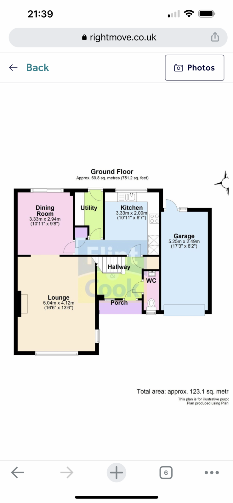

"Here’s the floor plan? Does that help lol."
It tells me that the world is on the other side of the wall, but it doesn't so much help explain why the chimney breast that sticks out into the room (on the plan) doesn't appear to stick out into the room (on the photo) which makes me believe the floor plan is not true to life

The chimney breast is mostly within the wall cavity and sticking out of the house exterior. We don’t have a chimney breast visible in the room the wall is flat all the way across!
That's the bit I was hoping to get to; the floor plan shows the breast as internal but your explanation that it is external makes the photos make sense. Also makes it a bit more difficult to arrange a ducted fan that pulls air from the room and blows it in behind the stove. Not impossible, but a bit awkward..

The main conclusion drawn from the feedback is not to increase the spacing around the stove JUST to get a fan.
It’s more about increasing the air space around the stove to allow the heat emitted to have somewhere else to go, I.e out into the room, instead of directly up and out of the chimney or stuck within the wall cavities.
A lot of the heat emitted from the burner is coming from the top, but above it is only a 2” space so it’s the consensus that the heat is actually getting trapped..
