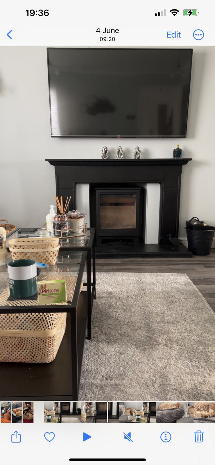

But the heat emitted from the stoves hot surface exterior is also likely getting lost / trapped due to the tight space in which the stove has been fitted?
As hot air rises and there’s just a tiny space for the heat to travel outwards most will be going up and getting trapped is what I gather from everyone else on this forum?
A lot of the heat emitted from the burner is coming from the top, but above it is only a 2” space so it’s the consensus that the heat is actually getting trapped..
Getting lost/trapped where though? If 2 inches of a gap was enough to shut down convection then radiators wouldn't work, fridges would overheat..
It is closed off, but the heat can still get partially trapped and sucked into the wall cavity?
or do you think that our set up is the best it could be and any alternations - smaller stove / larger gap around would be pointless?

This wouldn’t be a fair test? This fan could only be placed on the hearth which doesn’t get hot and is by the foot of the stove. It needs to be on top to catch the rising heat in order to push it out?
I am going off what the 6 other people in this forum have said. And looking online at stove installations they all have decent space above.
Could the heat not get forced and lost in the walls? Thus not all of it entering the room like it would if there were more space?

The original installation doesn't seem to be effective so either abandon it, put up with it or try something else. In my opinion, if you can get the 10 or 11 inches required above the burner then go for a smaller one - I can't comment on the cost of a new one, or how much the existing one is worth. This gap gives you the possibility of using an eco fan, but there will be much more natural convection too......at the moment there is none.

I have the funds it was just seeing people comment that it isn’t worth it put me off, but what you’ve said makes complete sense. I’ve been in homes with wood burners in (they have all had much more space around them) and they seem to offer more heat!
So I think that’s the conclusion ☺️ I’ll contact the installer and get more space around the stove!

Gap around fire looks to small should be 150 mm ,they are the figures I was given when had one fitted and looking on google same figure keeps coming up ,the heat can not escape and walls are being used as a heat sink.(and lack of air flow round the fire)
How much difference it will make I cant say ,but the figure must be there for a reason
