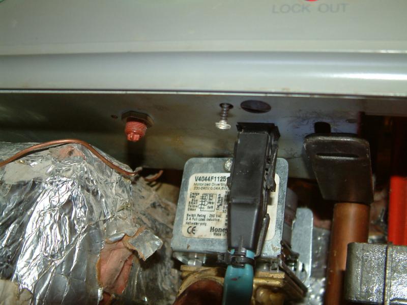

Hi, Guys,
I hope someone can help PLEASE, I have a Worcester 15/19 Heatslave with no HW or CH water, the other day I had a load noise coming from the water pump so I changed it, but now I have no HW or CH water, the pump is the correct way up & the electrics are correct, the diverter valve was changed about 18 months ago & since has run ok, today I isolated the boiler & drained it down, while empty I set the expansion vessel pressure to .5 bar & refilled it slowly via the filler loop, the diverter valve was set at manual & all bleed valves open, I restarted the boiler it will runs fine for about 6 or 7 mins then stop, it will not restart until it cools down, I removed the powerhead off the diverter valve, I checked the motor on it the reading is 2290 ohms’, I get a open & close circuit when the when I move the lever between manual & auto, I’m at my wits end as to what it can be, can someone HELP me PLEASE.

...I restarted the boiler it will runs fine for about 6 or 7 mins then stop, it will not restart until it cools down
Clearly the boiler works.
I assume the system pressure is above minimum, lets say 1 bar.
You have symptoms of low/zero water flow. Do you have pump isolating valves? Are they open?...No, I mean really open? Crappy 1/4 turn ball type isolators sometimes don't open (or close) properly and cause cavitation (noisy pump), or low flows.
Is the system water clean(ish)? Could the boiler pipework be blocked? Check the pipe temperatures at the flow and return connections to the boiler. If they're both hot after those 6 or 7 minutes then clearly the system isn't taking the heat away.

It is obvious that there is a circulation problem. Either the pump or the pipework is airlocked or there is a valve not fully opened.

The pressure in your boiler seems absolutely fine, so I'd forget about that one - 1 bar at rest rising to 1.3 is bang on.
The high limit thermostat reset is on the underneath of the electrical panel, with the thermostat knobs, left side. Its pressed up to reset.
I'm sorry, I don't know what you mean about something at ground level, 9.3 - unless its the burner air door screw. Could you post a pic, do you think?

John I've posted a photo of the control knob I mention earlier, I think it's something to do with the burner control.
Yes I have pressed the red reset button (top Left), after it's run it once (6 or 7mins) I have to wait most of the day before it will start up again (it will then start up without having to press the red reset button) which I believe that this is down to the boiler core being to hot, if I open the middle bleed valve I it's mostly steam coming out.
Today I intend to take off the powerhead & try to manually mover the diverter valve to see if it's stuck, t I can only try one job per day as everything gets so hot.
