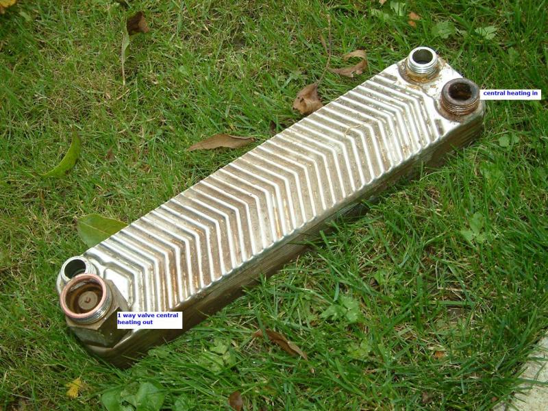

Hi John,
Today I'm going to try taking off the domestic water heat exchanger, the hot water seems to be going to the exchanger, but the pipes coming out are all cold, perhaps there is some crud in it, I'm trying not to buy anything that's not needed, is there any other forum members that would like to offer their views.
John if you are ever down West Wales drop me a line & Ill take you for a ride in my Cobra it has a Chevy V8 engine & it's bloody fast.
Kelvin
Hi John,
I got the heat exchanger off there doesn't seem to be any crud in it, there is a one way valve on top of the heat exchanger, as below could it be that this is faulty????? it's position in the boiler is as it is in the photo, the bottom is the front of the boiler, the in & out is marked on the photo's, as you stated you said that it should need changing.

Hi Guys,
Is there anyone else out there that can pick up on this thread, I refitted the heat exchanger & it's still the same, there is no hot water getting through the HE when I open the middle bleed valve there seems to be a lot of pressure on the water coming out, I've tried running with the diverter valve in auto & manual with no difference I've also bleed all the rads, CAN ANYONE PLEASE offer any advice I'm at them end of my tether, I don't know what to try next PLEASE HELP.

Coming in at the end here, I'll add my observations, which are really a summary of the others here.
The boiler is locking out on high temp.
You changed the pump because it was noisy.
The boiler only locks out on high temp, after 7 mins or so when it is started from cool. When hot it locks out almost straightaway.
If the new pump was shagged, it would not allow the DHW heatstore to warm up via the plate heat exchanger. The water simply wouldn't circulate and with 17kW cooking you would get nowhere near 7 mins, more like 7 secs, before the high temp lockout.
Therefore, there has to be an airlock or blockage in the CH side, not necessarily anywhere near the boiler.
I am curious that you changed the pump 'because it was getting noisy'. Noisy pumps are often air filled ones. Had the pump actually died before it was changed or was it just noisy?
I'd look elsewhere in the system for an airlock or blocked non return valve before changing anything else. Running a mains pipe into a drainoff on a rad and letting it run through the drain off in the boiler can cure difficult airlocks.
