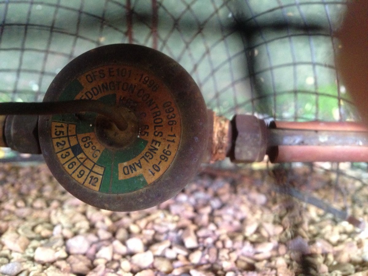

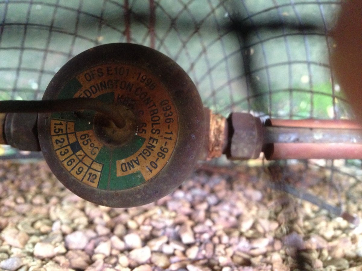

Might be worth adding that it is not uncommon for a fire valve to be fitted rated at 65c.
Most boilers require a 90c fire valve, so might be worth checking the brass valve body, where the temp rating is marked.
Looks like mine is 65c,
Boiler still not right ☹️... it is still tripping the lock out but now it does not trip the fire valve??
Seems to trip when high demand is on the boiler.. Anyone any ideas what to test now??
Well that me up and running again, thanks to everyone that helped, much appreciated....
