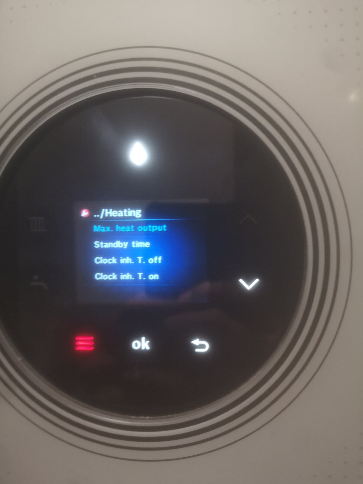

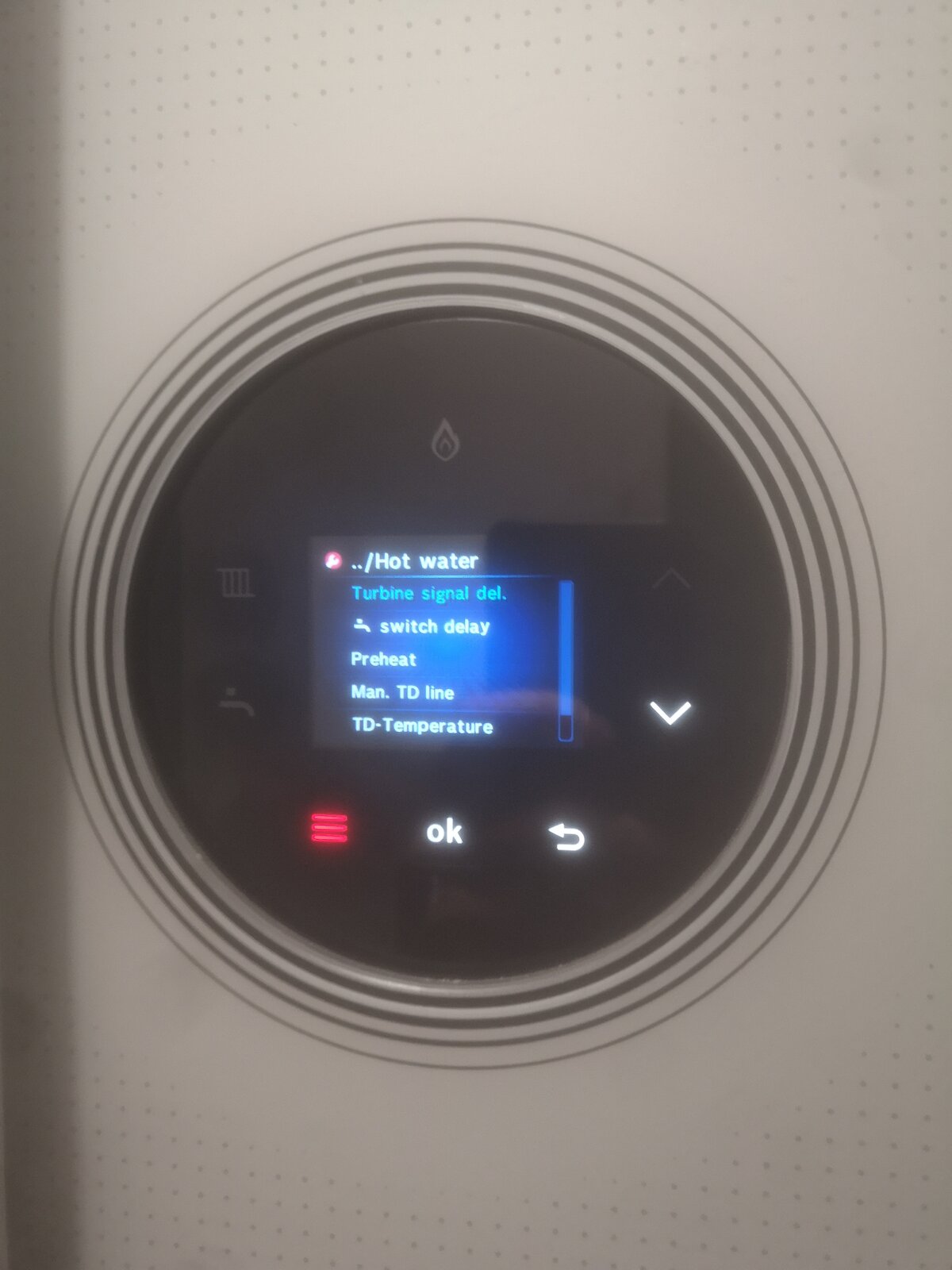

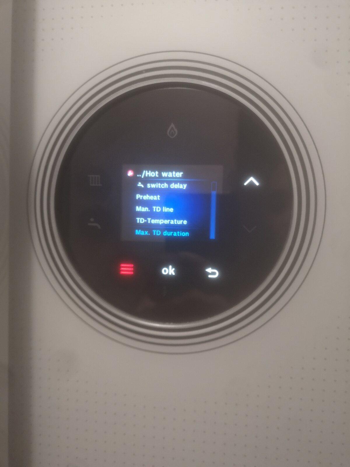

I can't find how to change the anti cycle time in settings. These are the options for Heating and Hot Water.
1 min 45 is quite a short amount of time. I don't think your problem is that.
Does the boiler stay alight when trying to reach 70
Yes the boiler flame is on when the CH is on and stays on when it reaches 70, however the flame stops after someone has used the hot water. The flame then starts again after 1min 45seoncds.

I did speak to Worcester technician and he said this is a built-in feature in order to reduce wear and tear in the boiler. This can't be changed.
So nothing we can do unfortunately, it's normal. It is frustrating as it can take a long time for central heating to heat up if people are using hot water.
