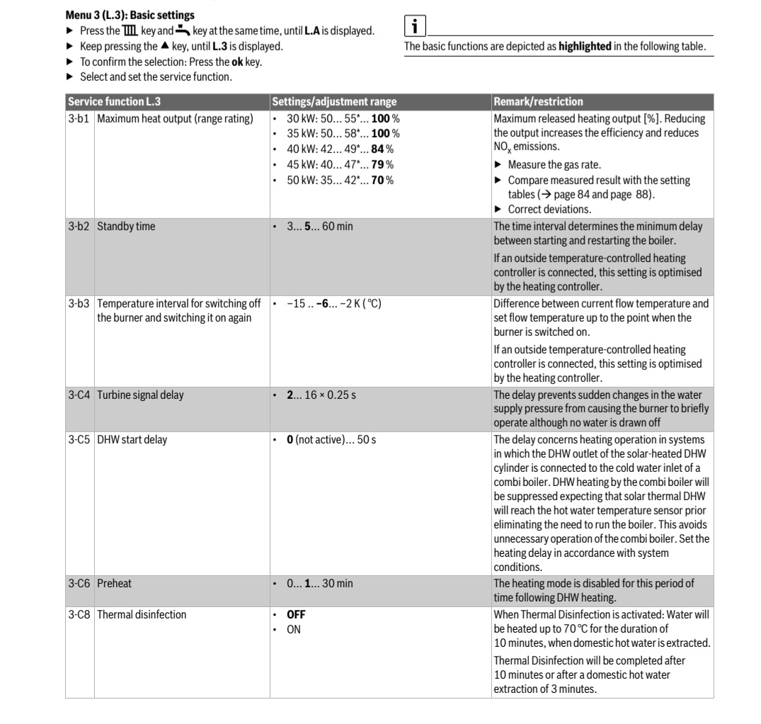

Try changing pre heat to 0
Can you please give us guidance how to change this?
Thanks.
Pre heat settings are in the image I have uploaded..if you are able to view. I haven't changed it yet to test myself but will be doing so

change setting 3-b2 from 5 (default ) to 3 this the time between a thermostat asking for heat and then asking again
3-c6 from 1(default) to 0 this is the delay time after using hot water or preheat activating
3-d1 3 (default) change to 5 or 6 to increase pump speed around system if poor heating to any rads

Thanks snb. I'm already on these settings, but it has made very little difference and all it takes is for someone to open a tap and then we're waiting for ages for the boiler to go back to the higher temperatures, it's just ridiculous.
if you have changed these settings then the delay from drawing hot water to heating starting again would be about 75 seconds.
As a comparison for other combination boiler manufacturers this is about the same time delay. You cannot compare to older model boilers as there was a change in 2019 to achieve a minimum efficiency rating and nearly all manufacturers had to adopt this delay to be able to achieve it.
