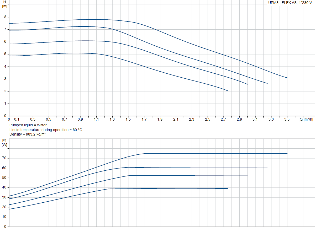

Where are you seeing mention of residual head?, the 30LPM at 5.5M looks very much like a typical 8M pump curve, ie, a 8M Dab Evosta 3 will flow 30LPM at a 5.3M head.
Residual pump head is just "pump head" at any given flowrate?, remaining head is probably the one that gives the head after passing through the HEX??.

On the second photo in the first post it says H is Residual Head.
Residual head is the same as remaining head. "Residual" means what's left remaining, as in "residual estate". It is the head that is still left over after passing through the heat exchanger. That's why they only show it for combi boilers and system boilers.

I know it is a Grundfos UPM3 pump. I believe it most likely is this one.
Boiler manuals can be wrong though. That is a major caveat!!!
https://product-selection.grundfos....00?pumpsystemid=2296989012&tab=variant-curves

Yes, I see that now but am still of the belief that it only shows the pump head, the pump head that you show above is exactly the same as the one in the UPM3 attachment, it couldn't possibly be the head available after "the" HEX, as no HEX is mentioned, IMO its the generated pump head, if you stuck a valve on that pump discharge and throttled it to give a flow rate of 30LPM, 1.8m3/hr then the pump head is 5.8M, I think remaining head is the word but of course if the boiler makers just gave us the HEX head loss at any given (normally the design) flowrate and the pump curves then no more confusion.
I am sure I am right about the meaning of residual head. But I don't trust the info. on this in the Worcester Bosch manual. I think you are correct that the graph is simply showing normal pump head. Probably for a standard UPM3 rather than the more powerful version I posted.
