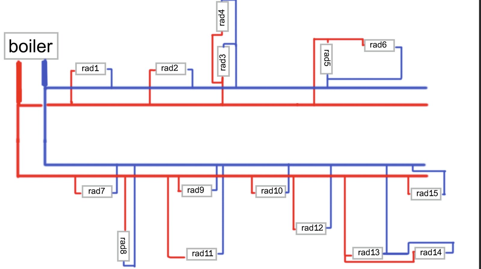

Oh and I totally forgot, to add a bit of context, i've done a little map of how the rads are piped up (birds eye view)
starts at 28mm for the first meter or so, then splits into 2 x parallel runs of 22mm, then down to 15mm to each radiator, for the last meter or so.
On setting 4, it was rad 14 that was not warm at all.

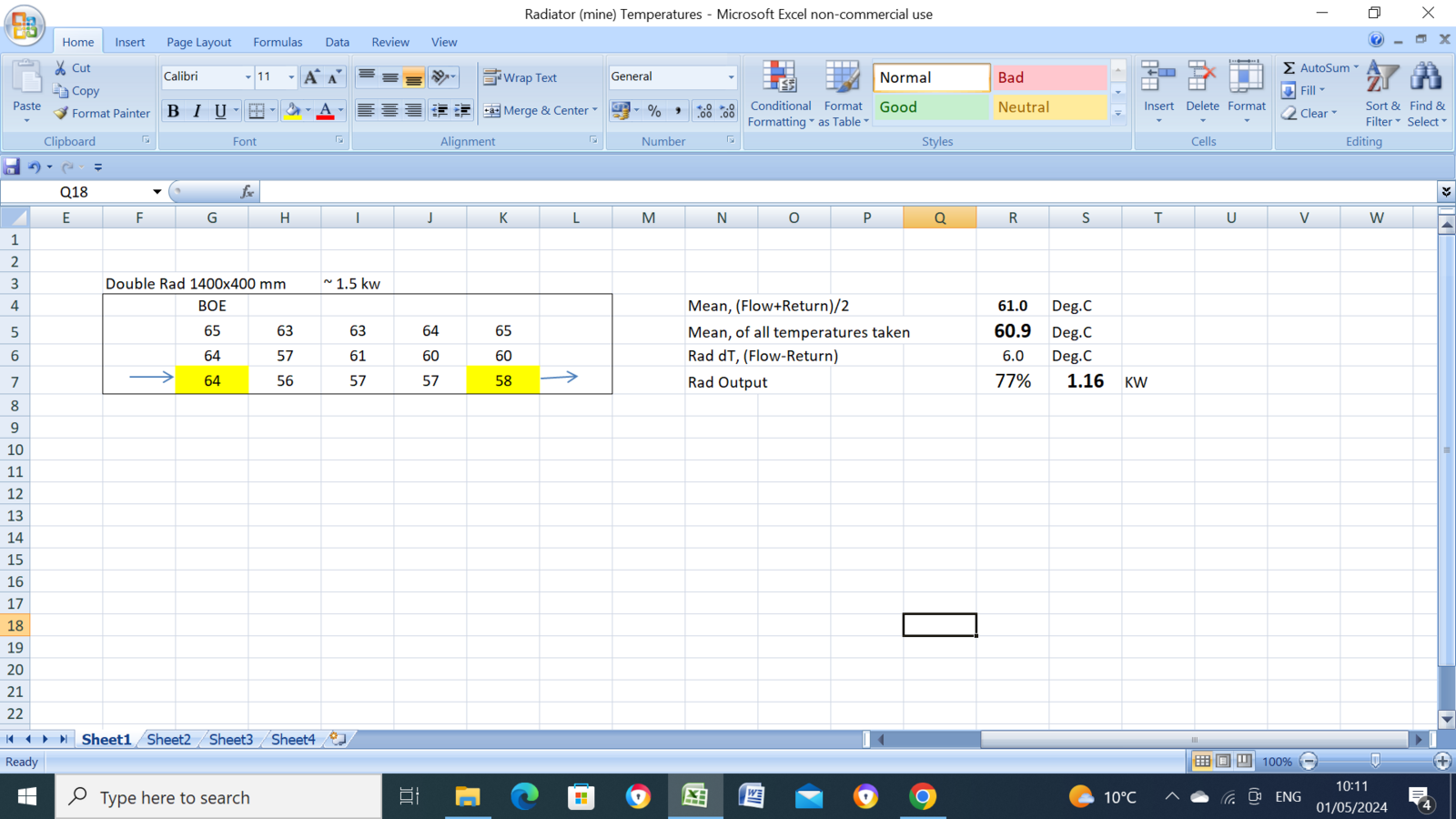

Below is a screenshot of one of my rads, the flow is from left to right, as you can see, the hotter water moves vertically upwards in the first 120mm or so, then falls pretty uniformly downwards through the remainder of the rad to give those indicated temperatures and a rads output of 1.16Kw, that rad has a TRV so once room temperature up to its SP of 20C will throttle right down to give the required rad output.
