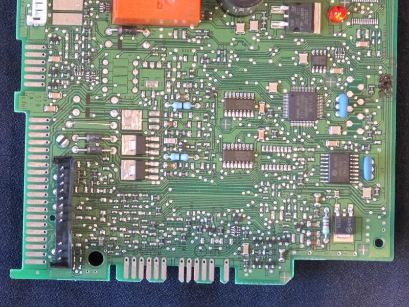

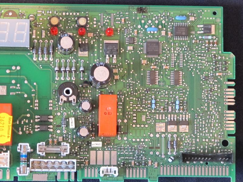

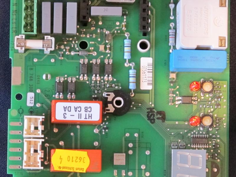

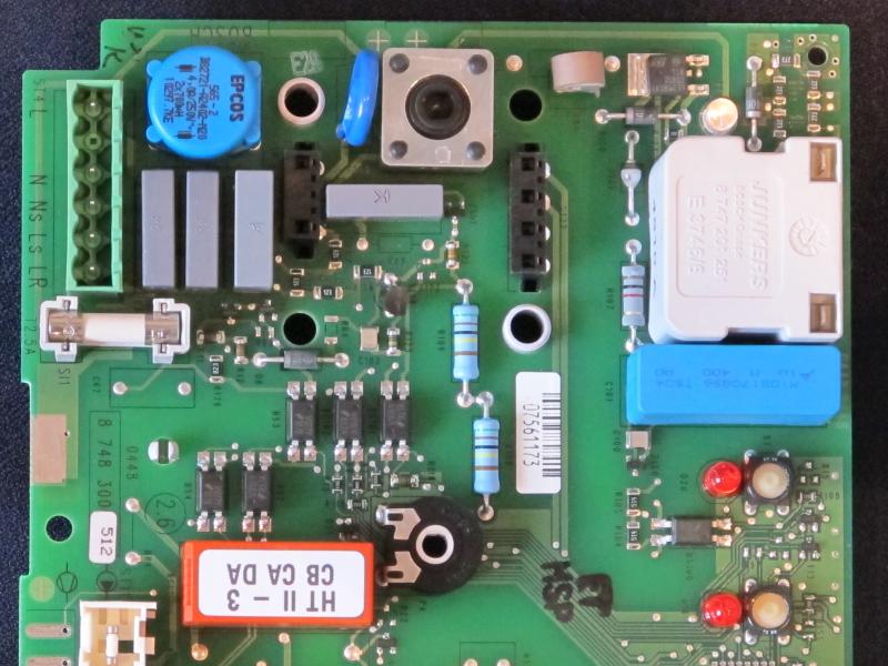

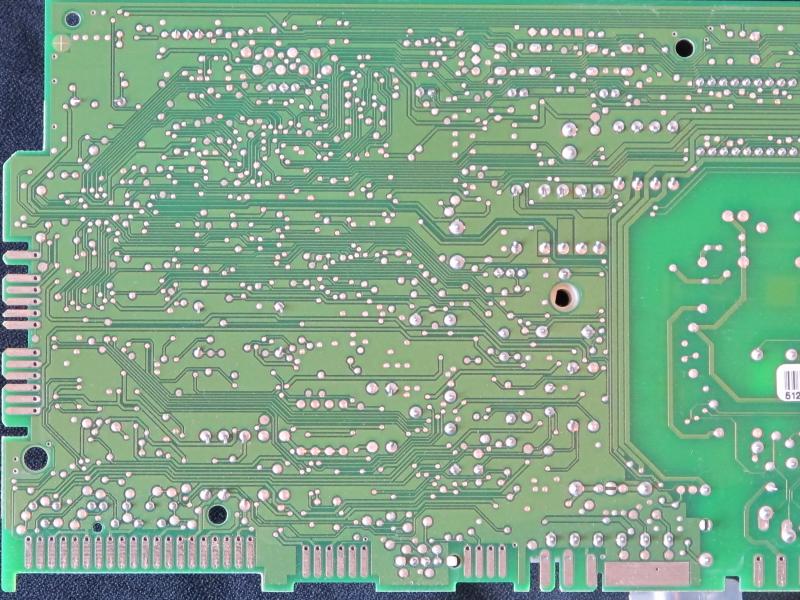

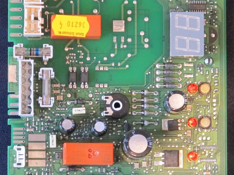

if you could post some photos of the pcb dave (both sides) it would be useful
as better options may be available as I think we may still be able to incorperate the tr2 in part
Matt

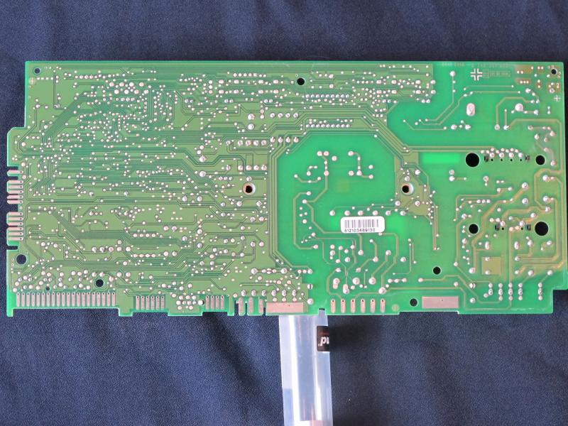

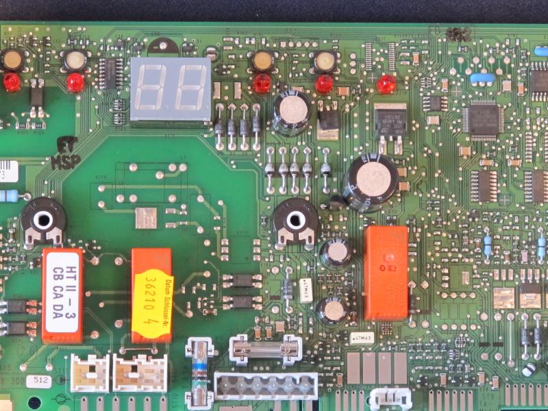

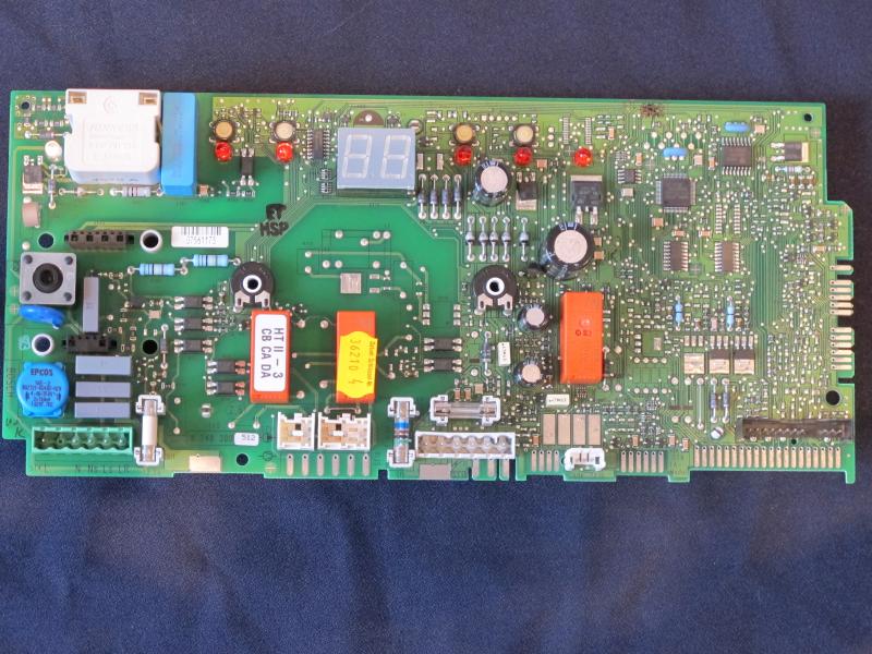

Matt[/quote] Hi matt managed some photos hope you can make head or tail with them,ht//media.diynot.com/191000_190175_48099_42896035_thumb.jpgtp://m//media.diynot.com/191000_190175_48100_29973100_thumb.jpgedia.diynot.com/1http://media.diynot.com/191000_190175_48101_35144673_thumb.jpg91000_1901//media.diynot.com/191000_190175_48102_26691439_thumb.jpg75_48098_39055013_thumb.jpg [/img]
Try again
