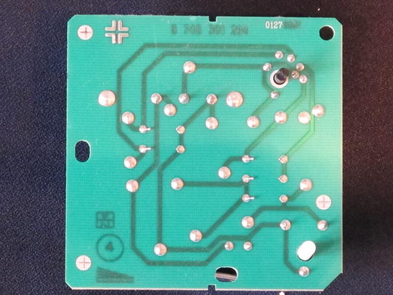

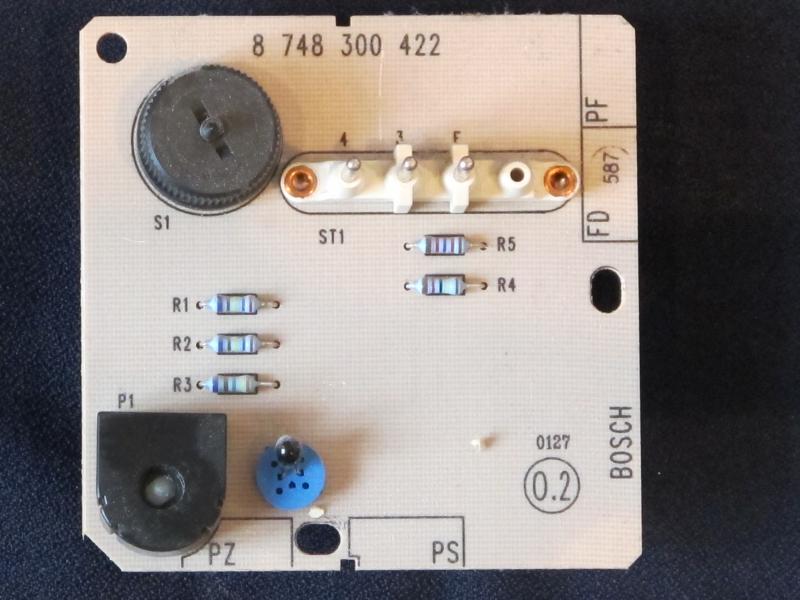

Yes Dave the tr2 pcb as picasso has stated, I probs won't get the chance to study it till fri though as away at mo

Ok here's how the rt2's circuit actually is
View media item 48169
