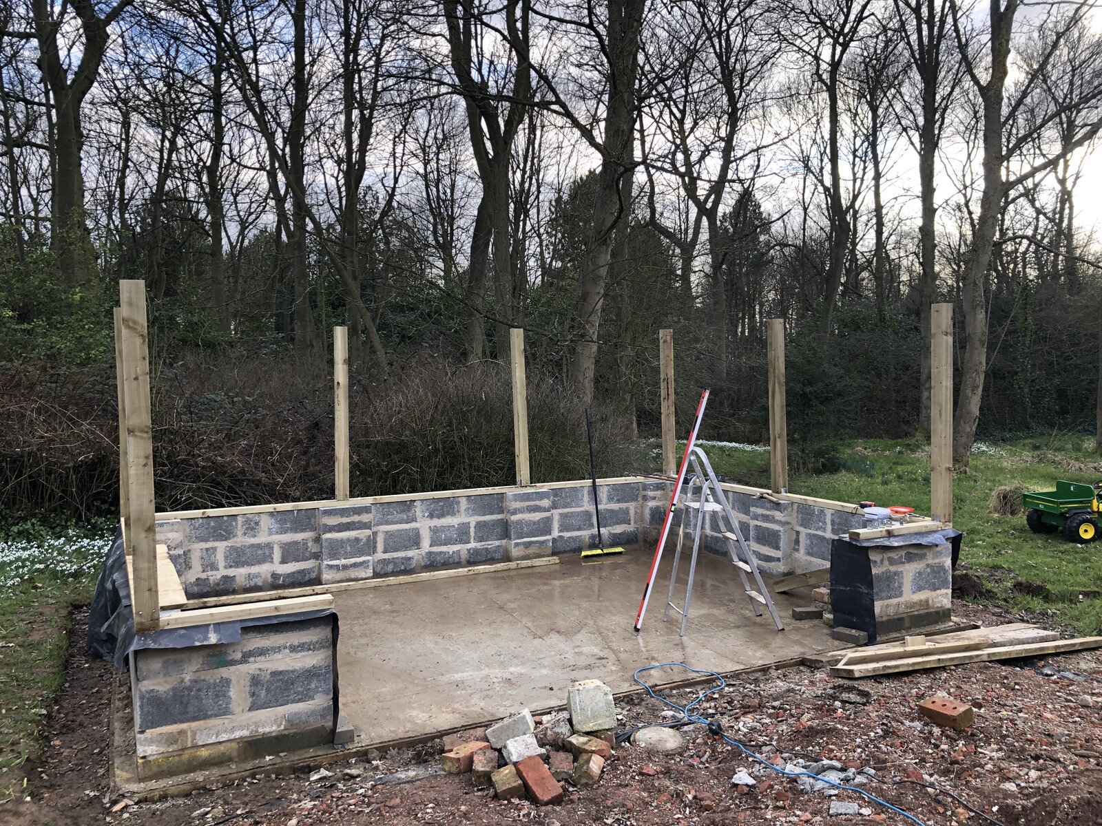

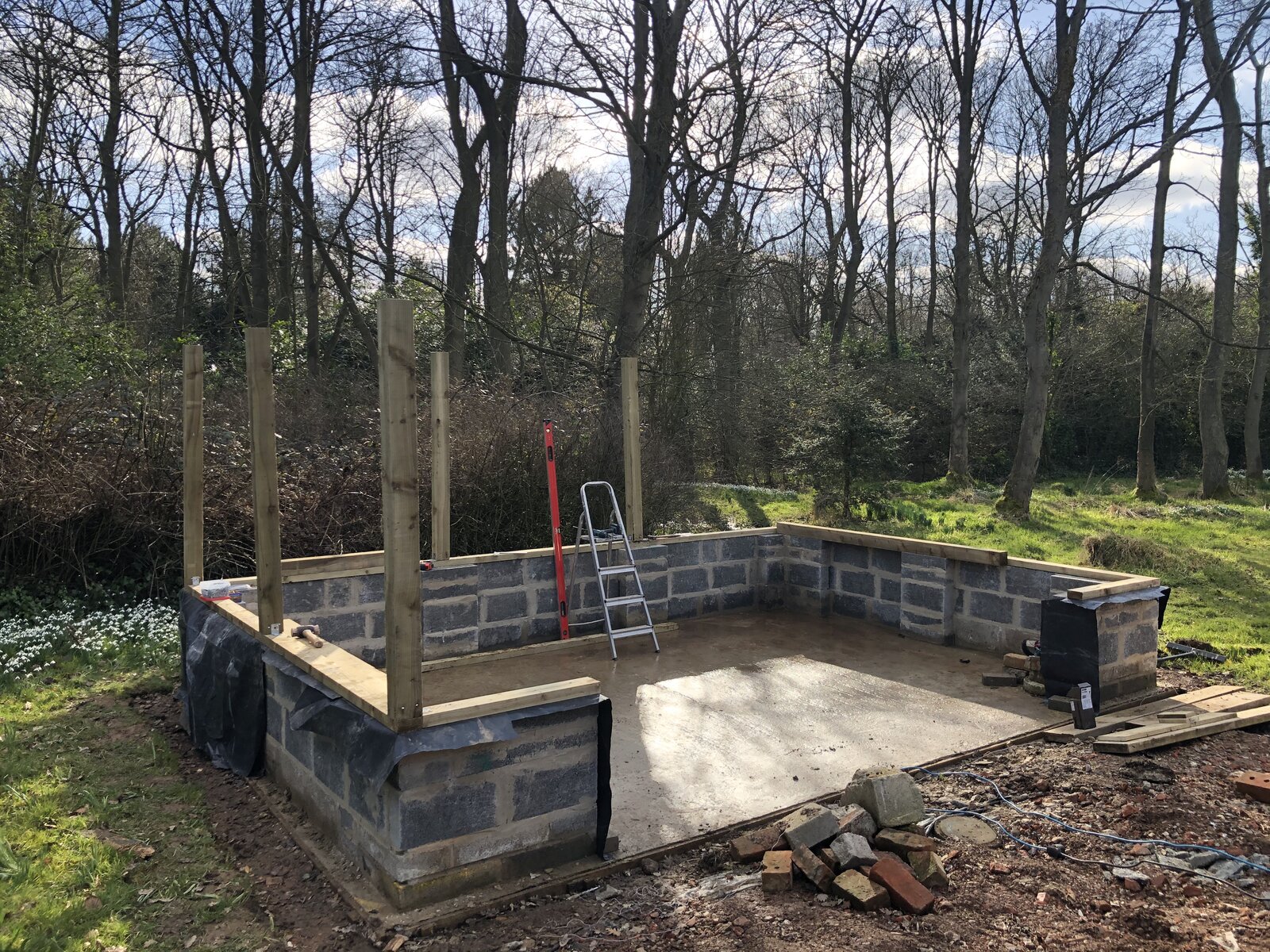

So next job is to bed a 4x2 sole plate on to the block work. Going to bed it on with a thin layer of cement and DPC to make sure it’s level. Then we’ll be flying.
Good work mate. Slow and steady wins the race as they say!
Fair play mixing all that mortar by hand too, I would have bought a mixer for that...but I use any small job as an excuse to buy tools.
Hope you’ve got an electric screwdriver/impact driver and that you bought reisser screws, they are second to none for timber without needing pilot holes. (Personally I’d have bought a nail gun too :D)
I would screw the base plate down to the blocks too
The mortar is just to give the sole plate a nice level surface. I'm sure domdee will be bolting the sole plate into the blocks using bolts and resin anchors :)
Could have bowrrowed my old mans mixer but thought I wouldn’t be mixing much to bother... yeah should have gone and got it. Never mind
Yeah I will be screwing down the timber. I like the frame fixings which you drill the 6mm hole first and the screw self tap into the bricks/ blocks. Had good success with them over the years so will stick with them.
I will be armed with my drill and impact driver. Im used to pilot drilling and prefer it in many ways so don’t mind. Plus I’m tight and wouldn’t pay for dearer screws hahaha. Same goes with buying tools. If I can make do with what I have then I will. So I opted for 2kg of loose ring shank nails and will putting the outer boards up with a hammer by hands.

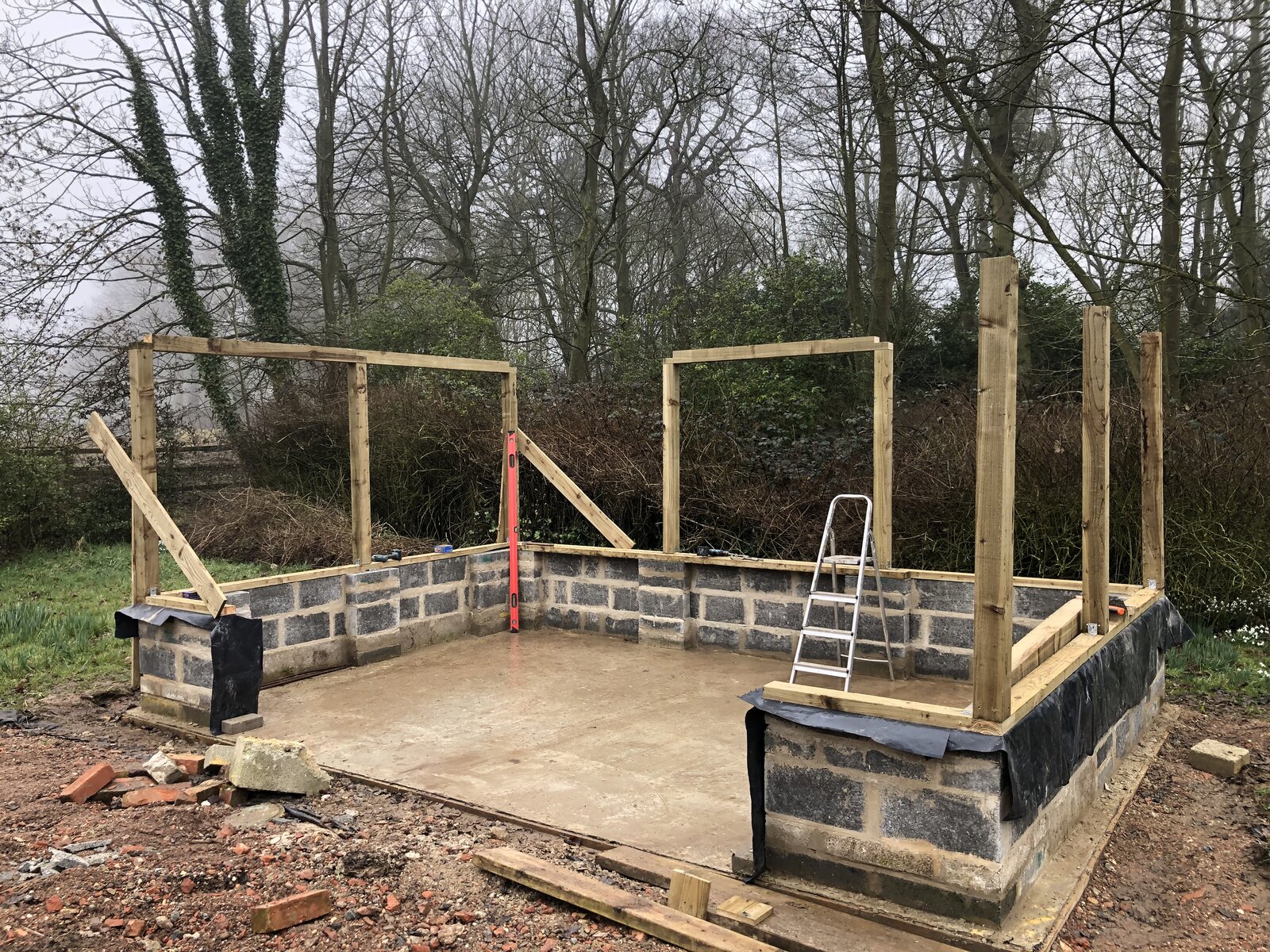

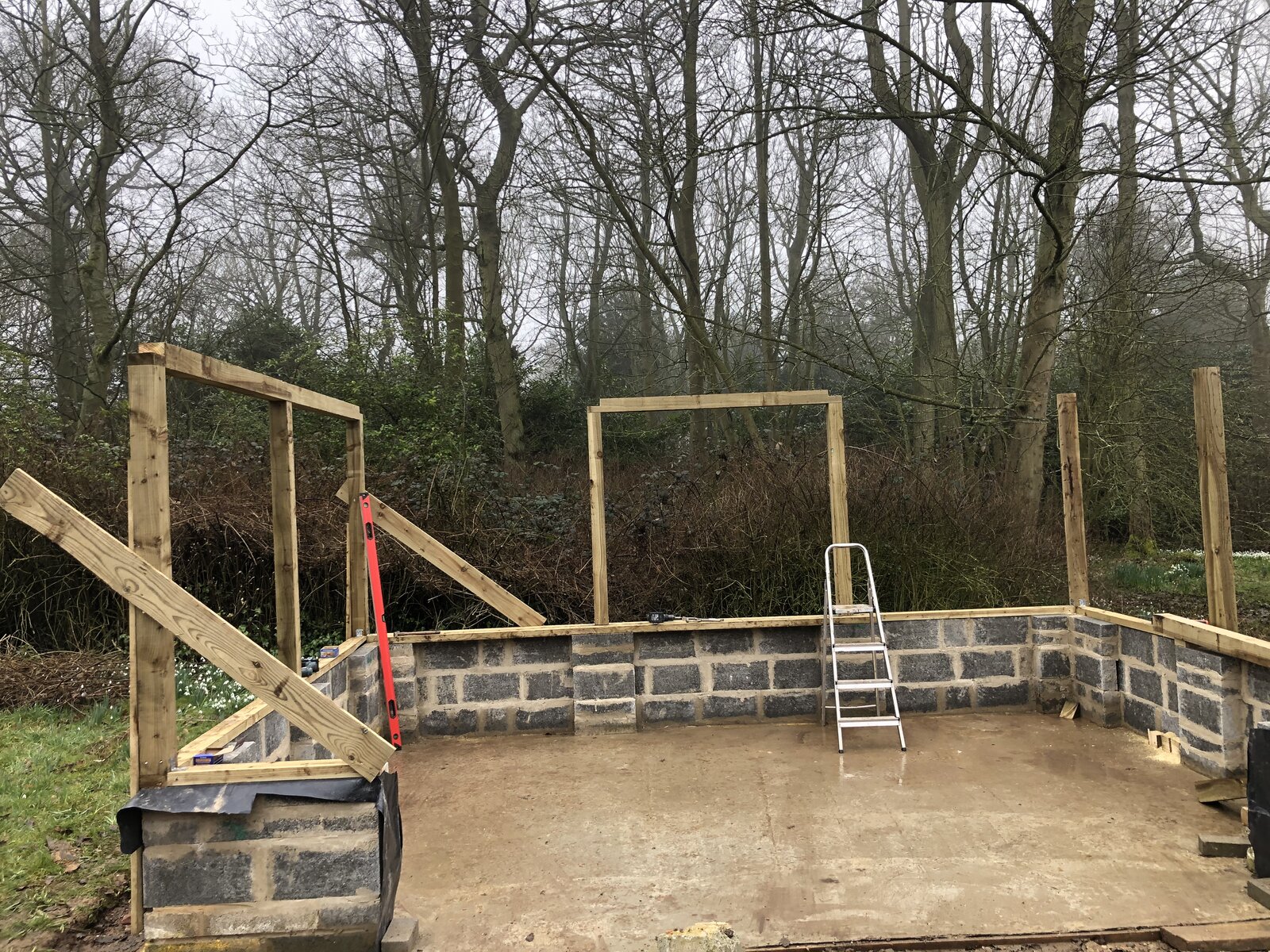

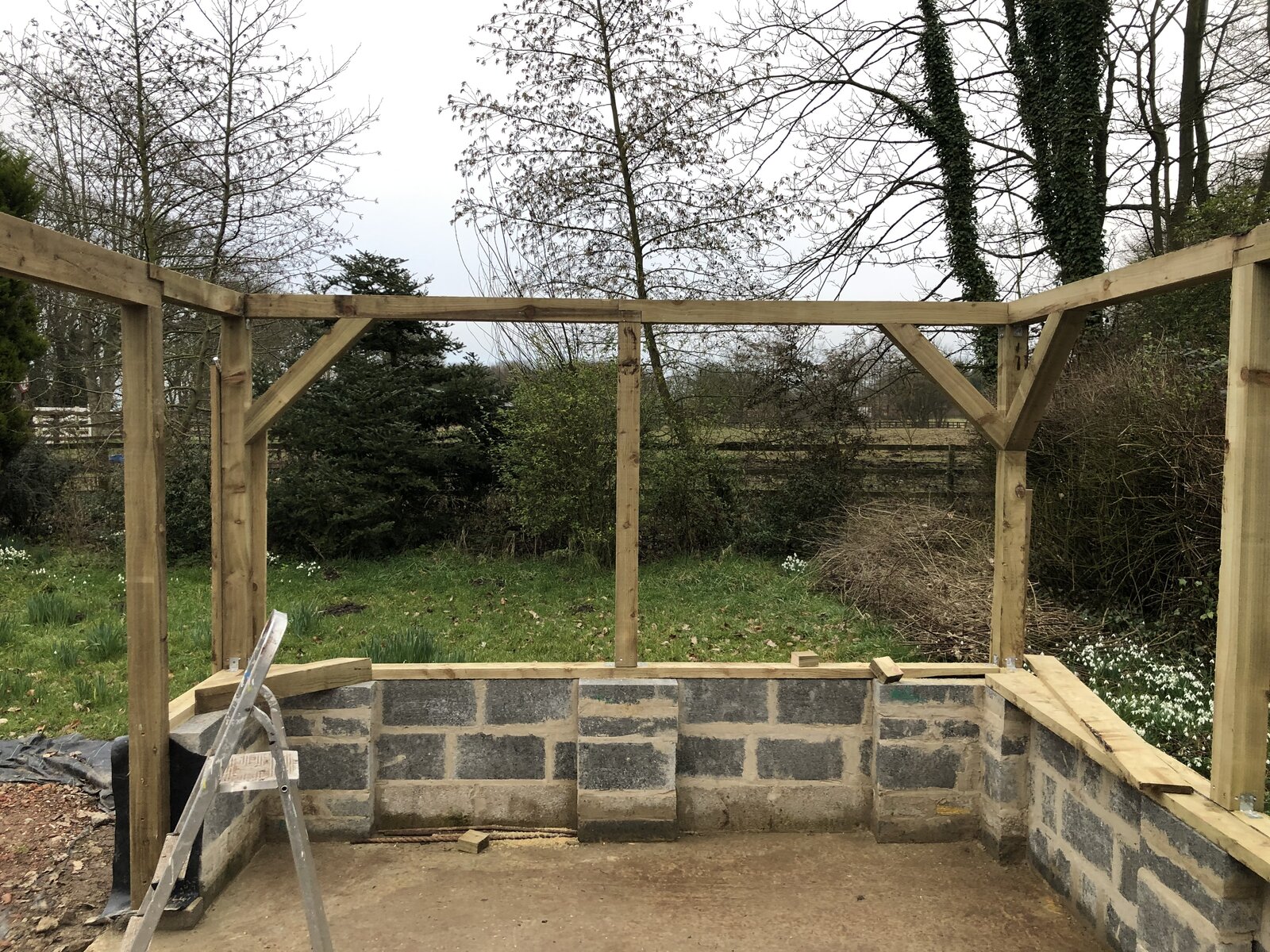

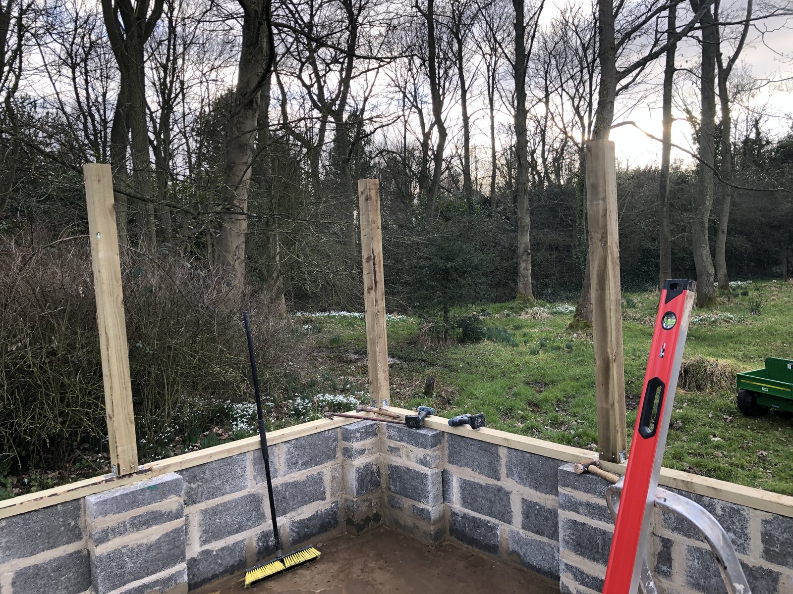

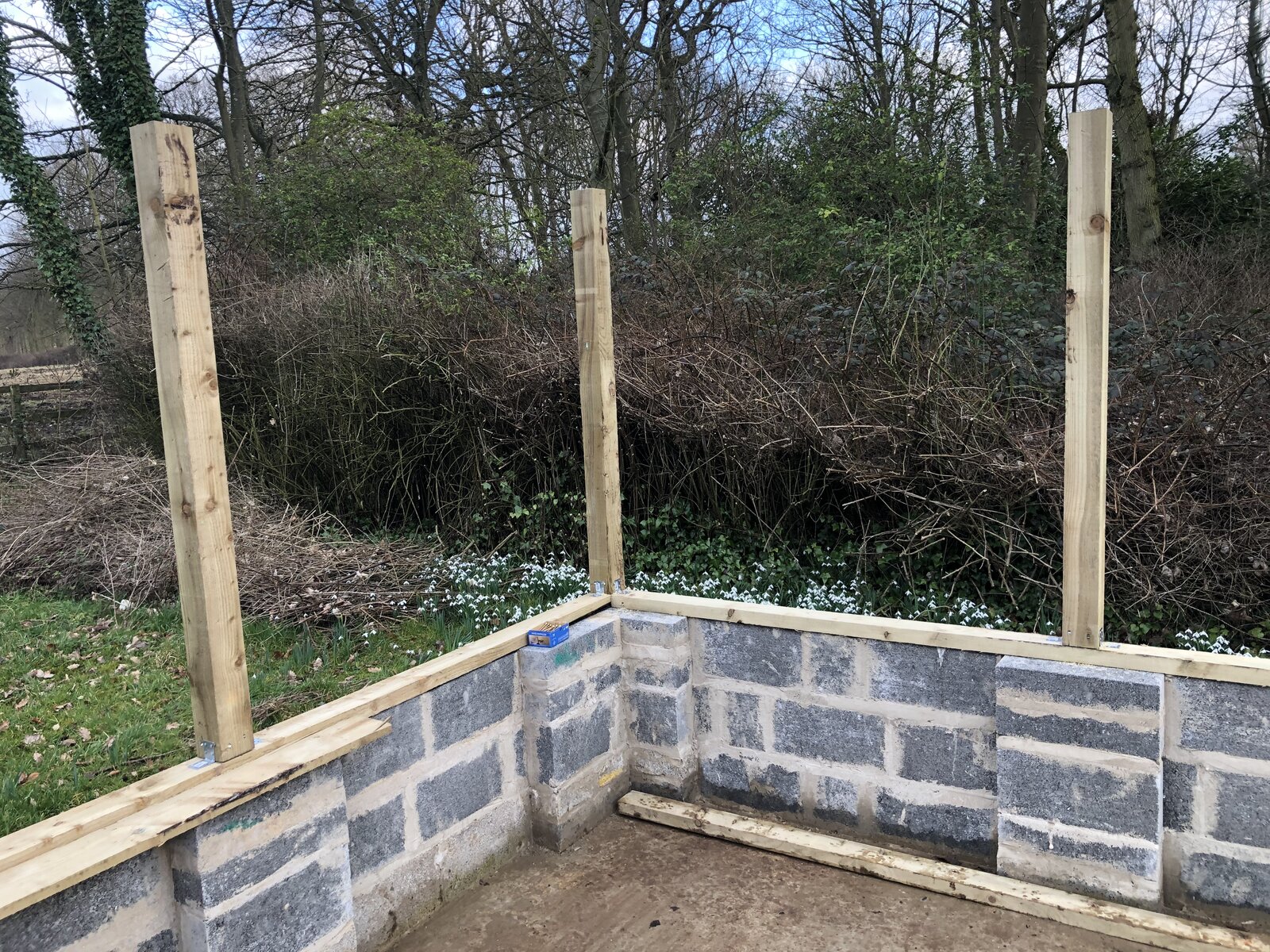

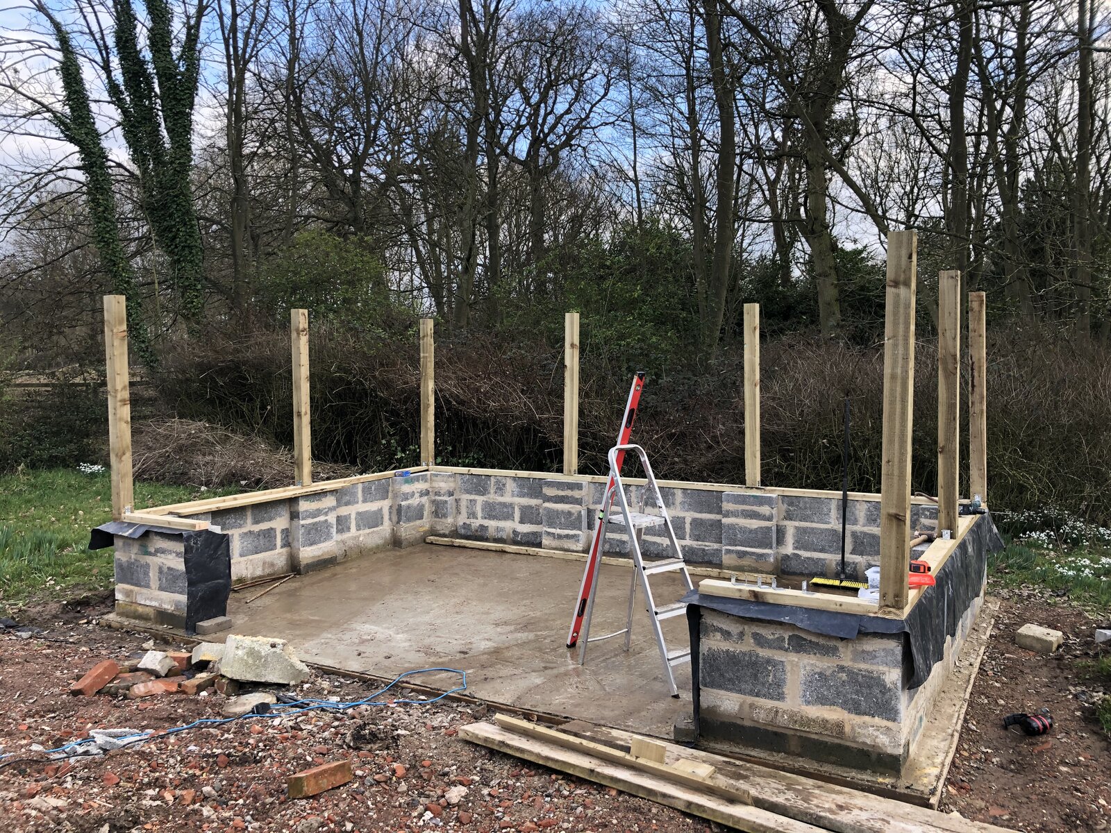

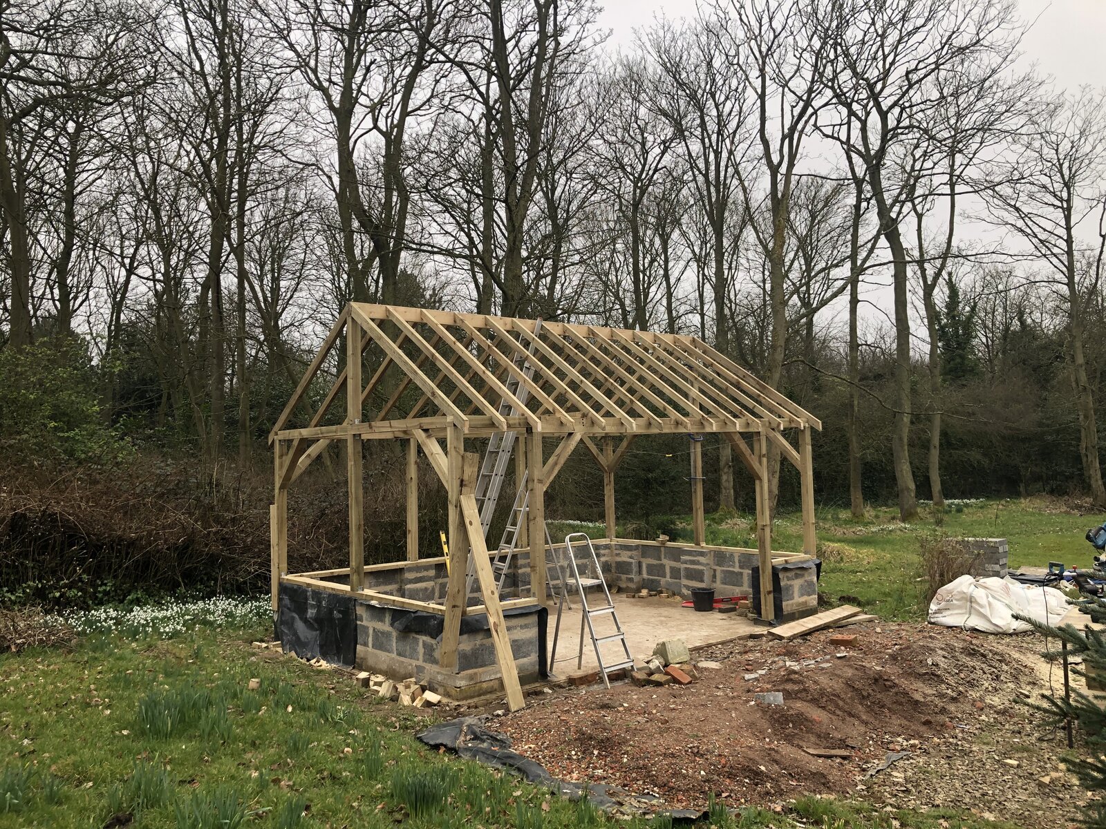

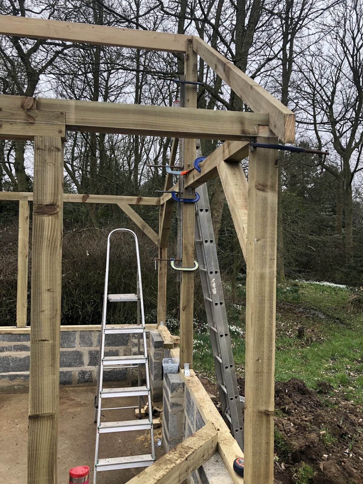

So starting on the timber work today. Got the sole plates down and started erecting the 4” posts from there!
Not plumbed up yet.

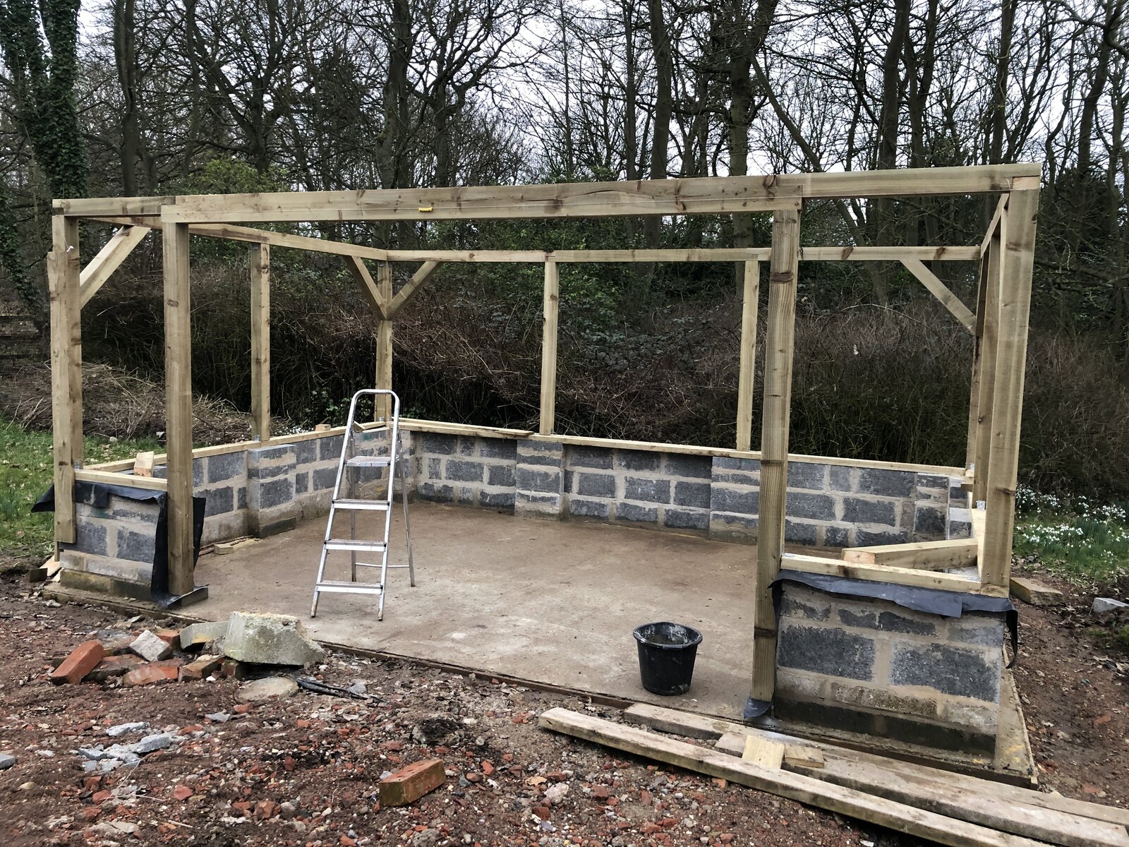

posts are secured with 8x 4” nails (2 on each face) and 2x angles brackets nailed in with square twist nails.
Loads to do but made a start and are chuffed with that.
More progress made. Currently jobless so making the most of it!

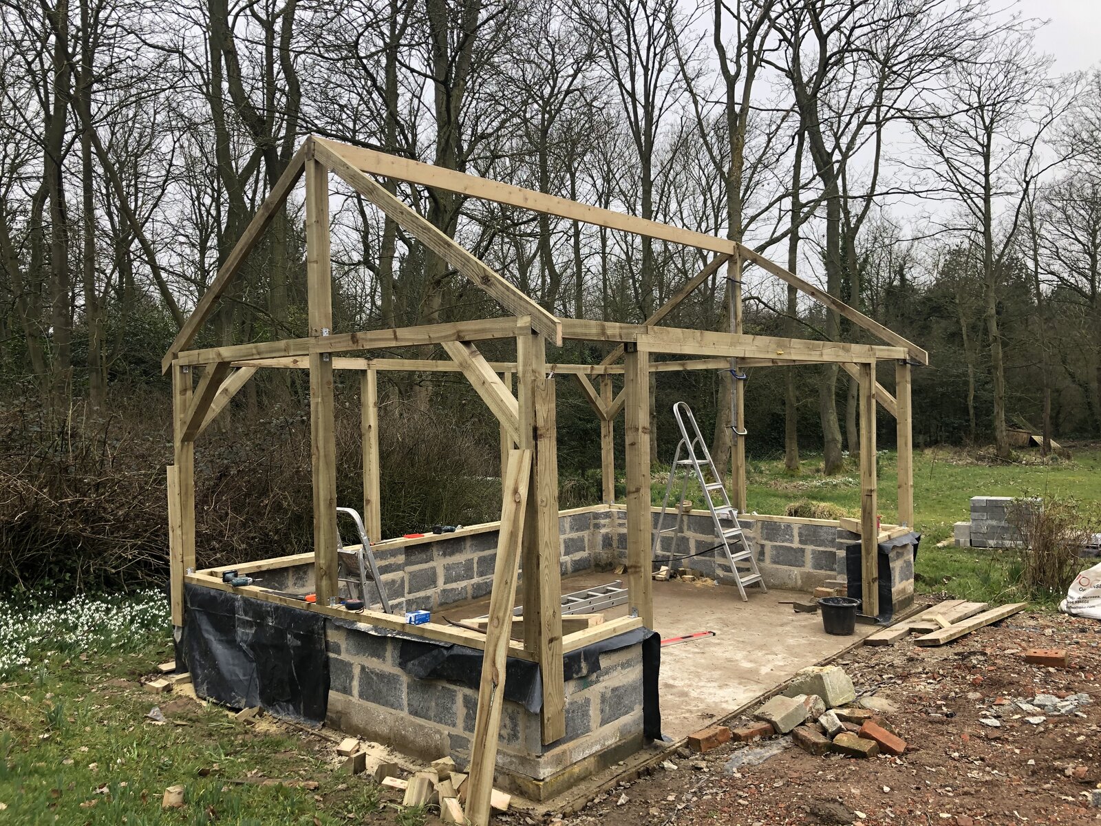

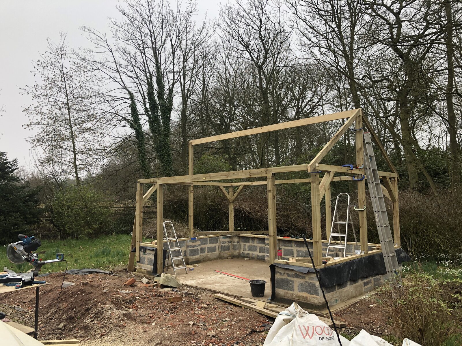

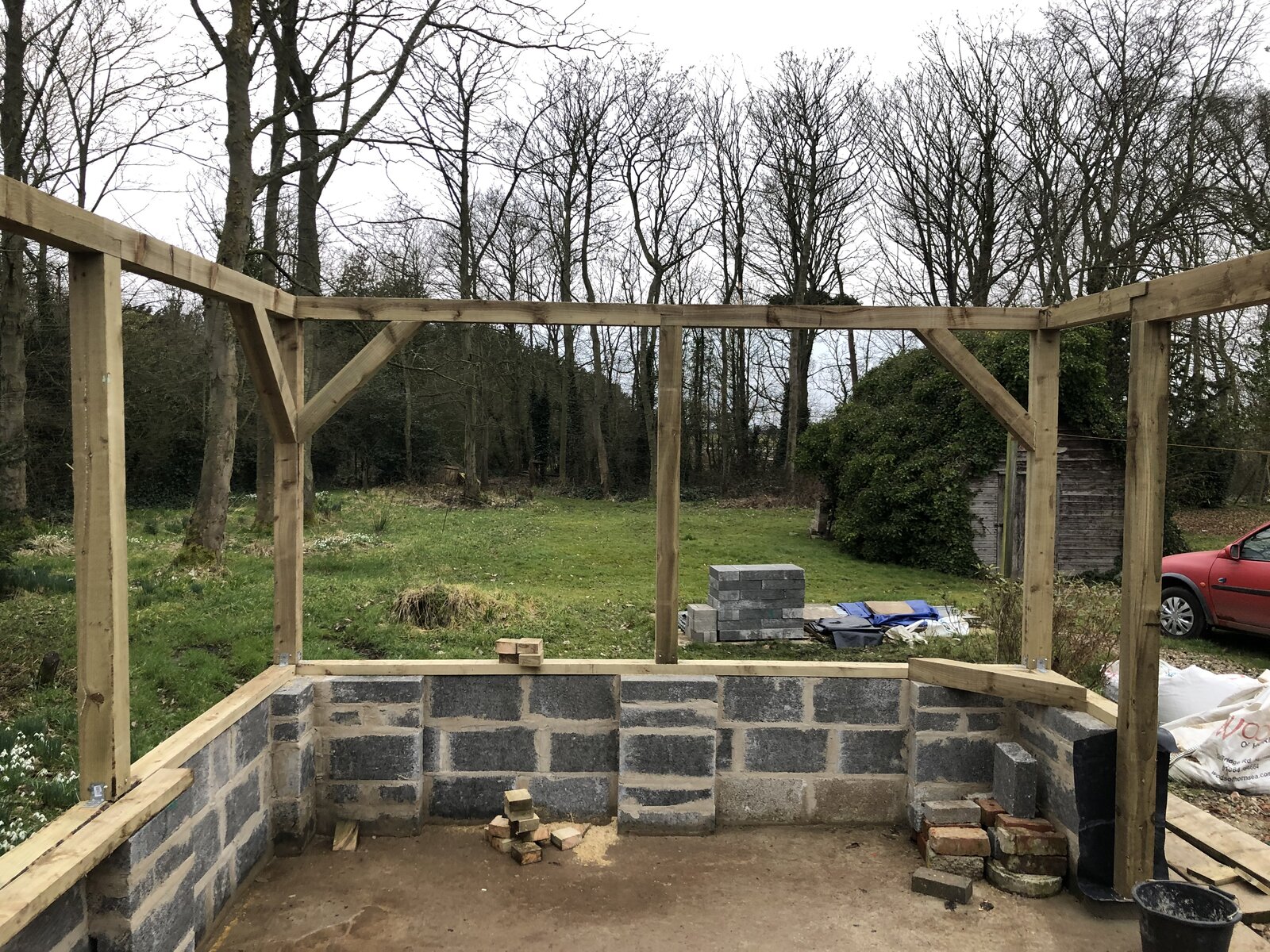

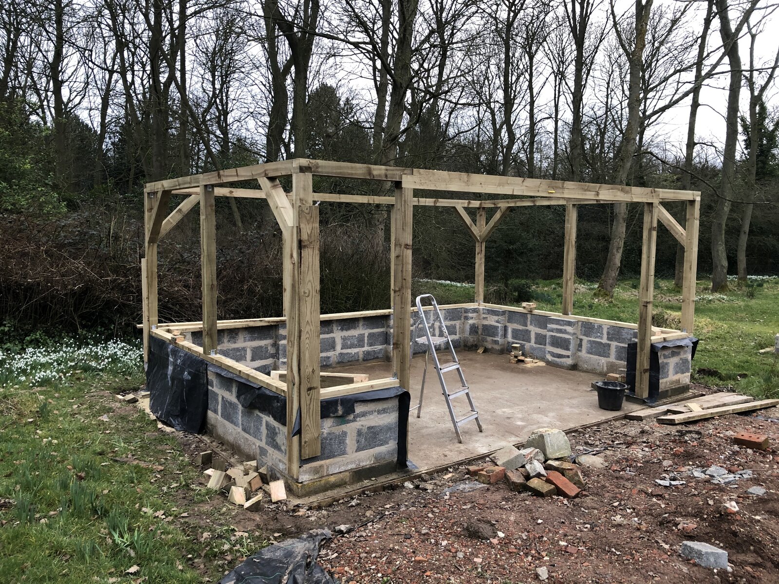

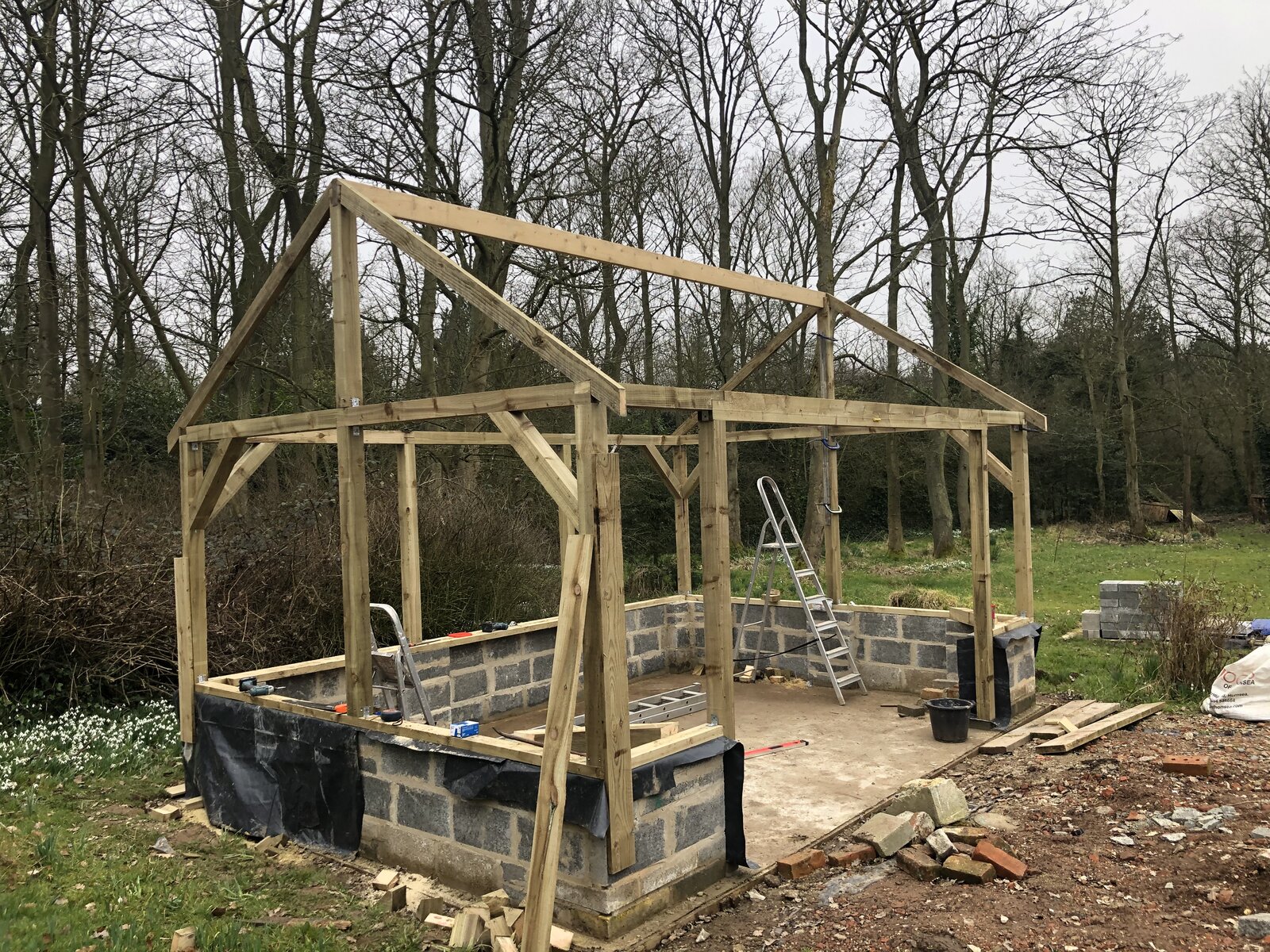

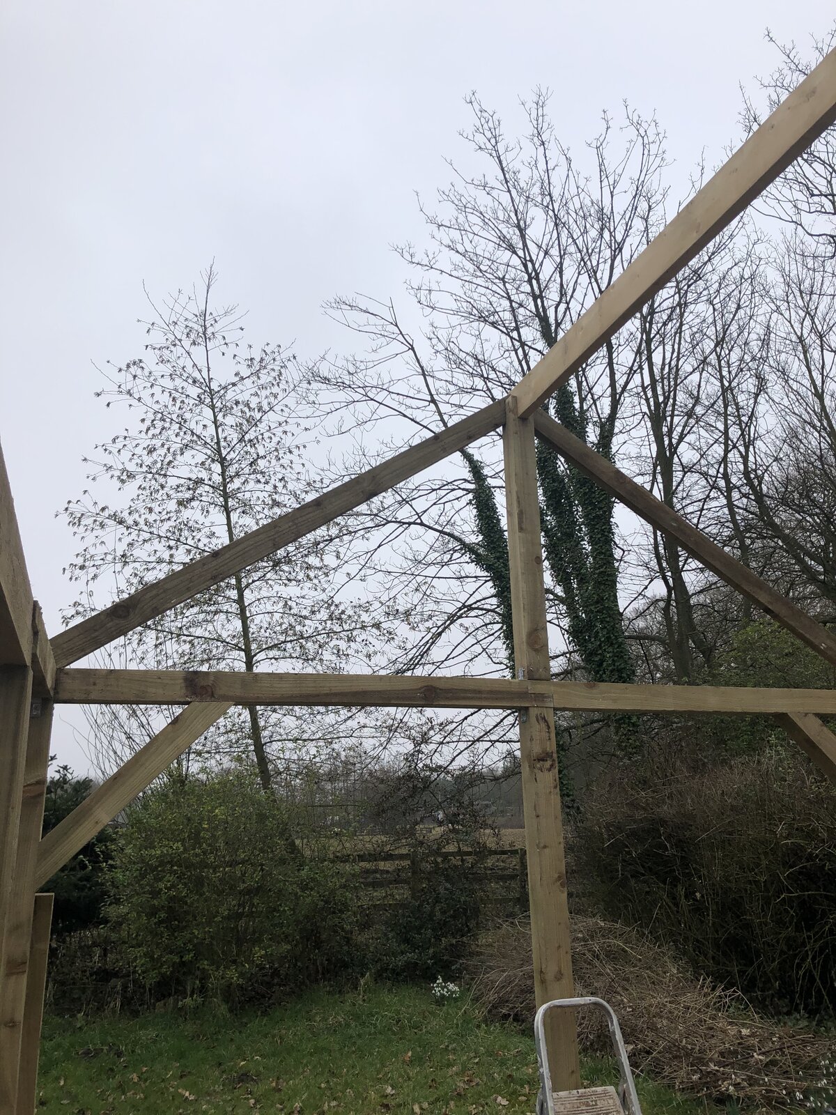

Braced all corner posts square and went from there. All dimensions are repeated so makes cutting easy. Minimal waste so far. Few more diagonal braces to fit using off cuts. And I’ll get the on with the roof.
More tomorrow I hope... if the wife will have it that is.

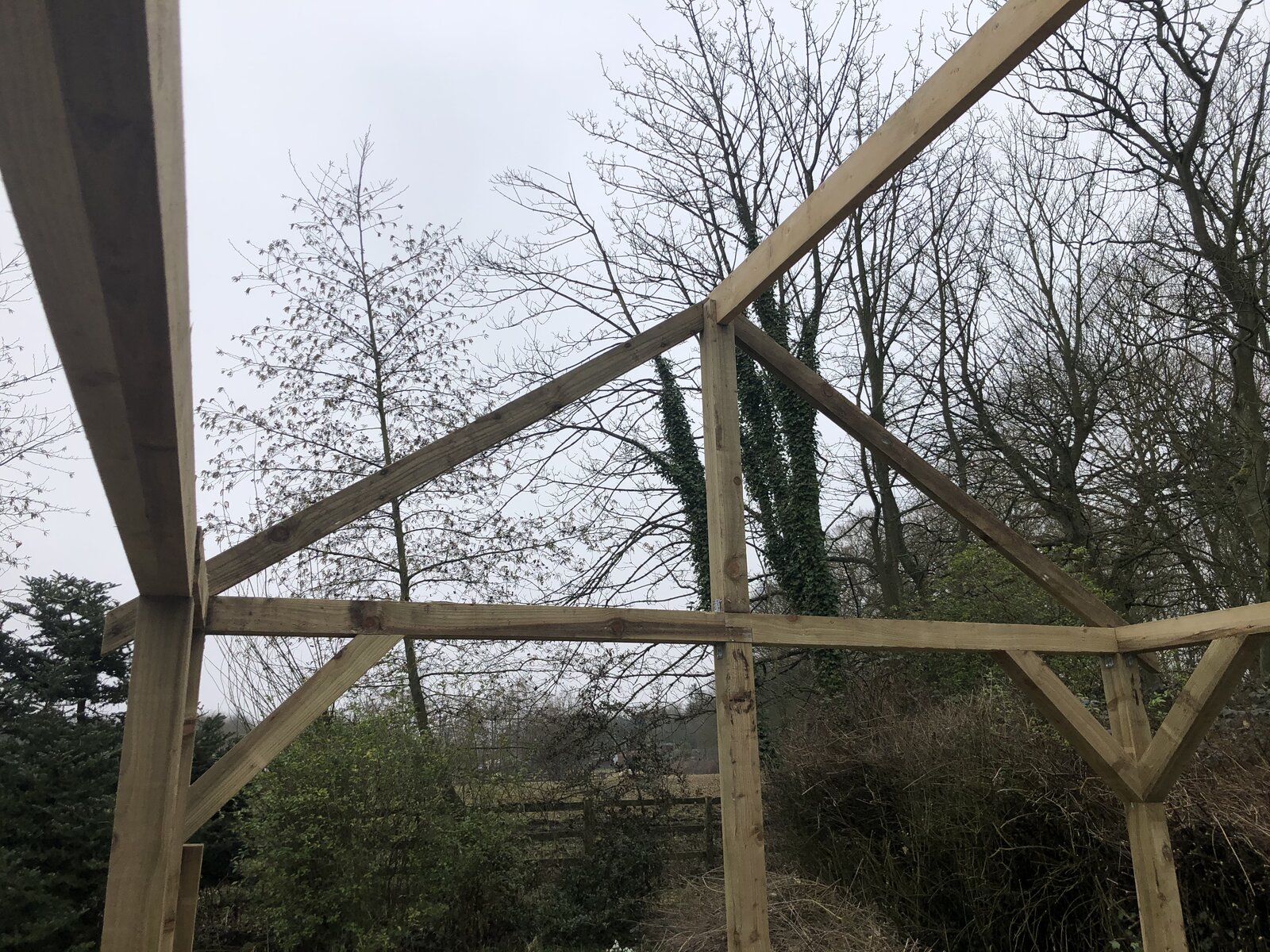

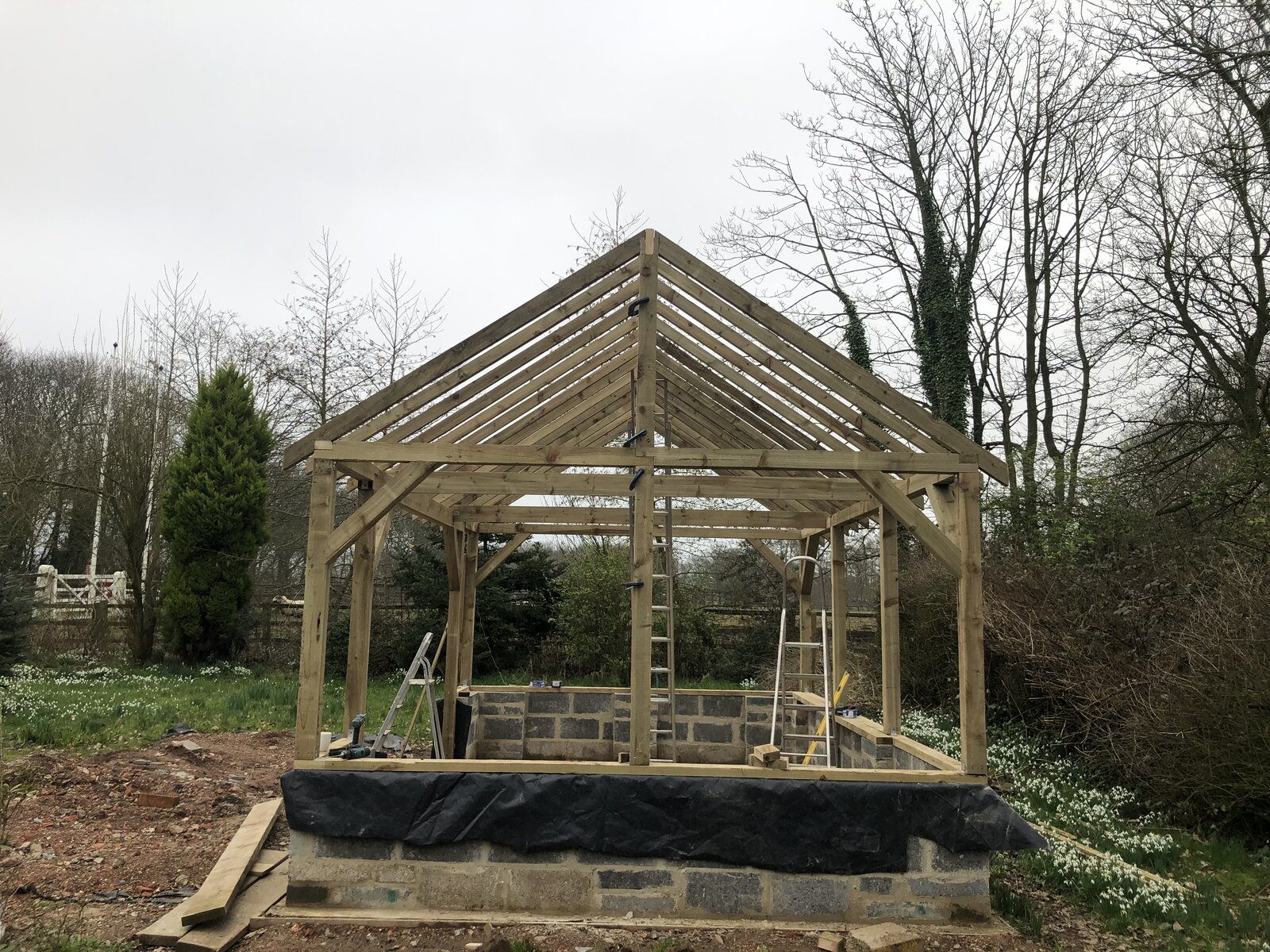

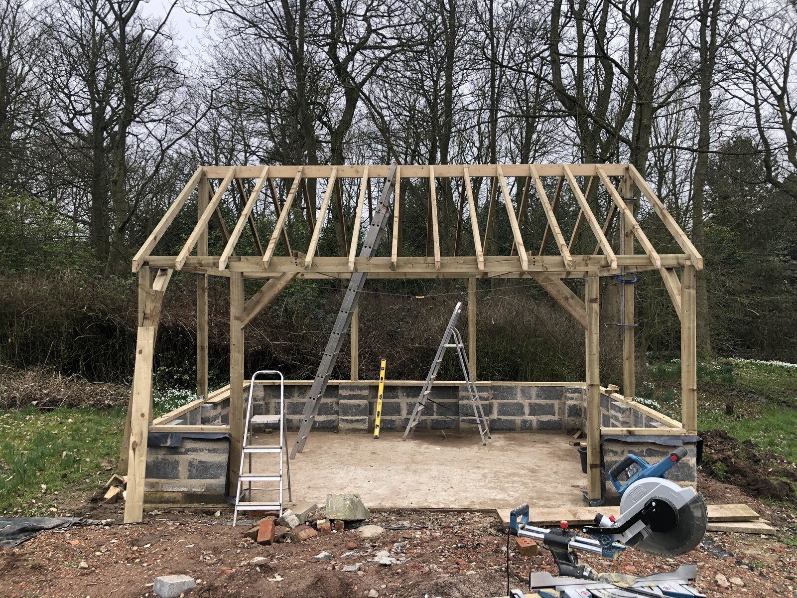

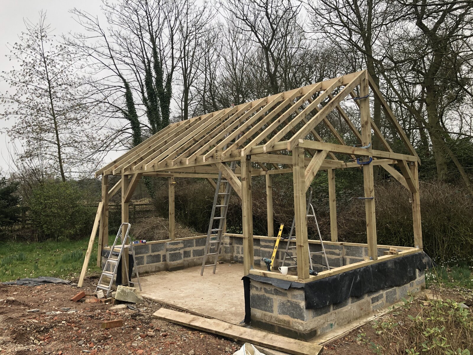

Bit more progress yesterday and today. Not many pictures during the days but well chuffed with how it’s gone! Sick of cutting rafters and birds mouths so glad it’s finished. Perlins tomorrow and bits and bobs.
