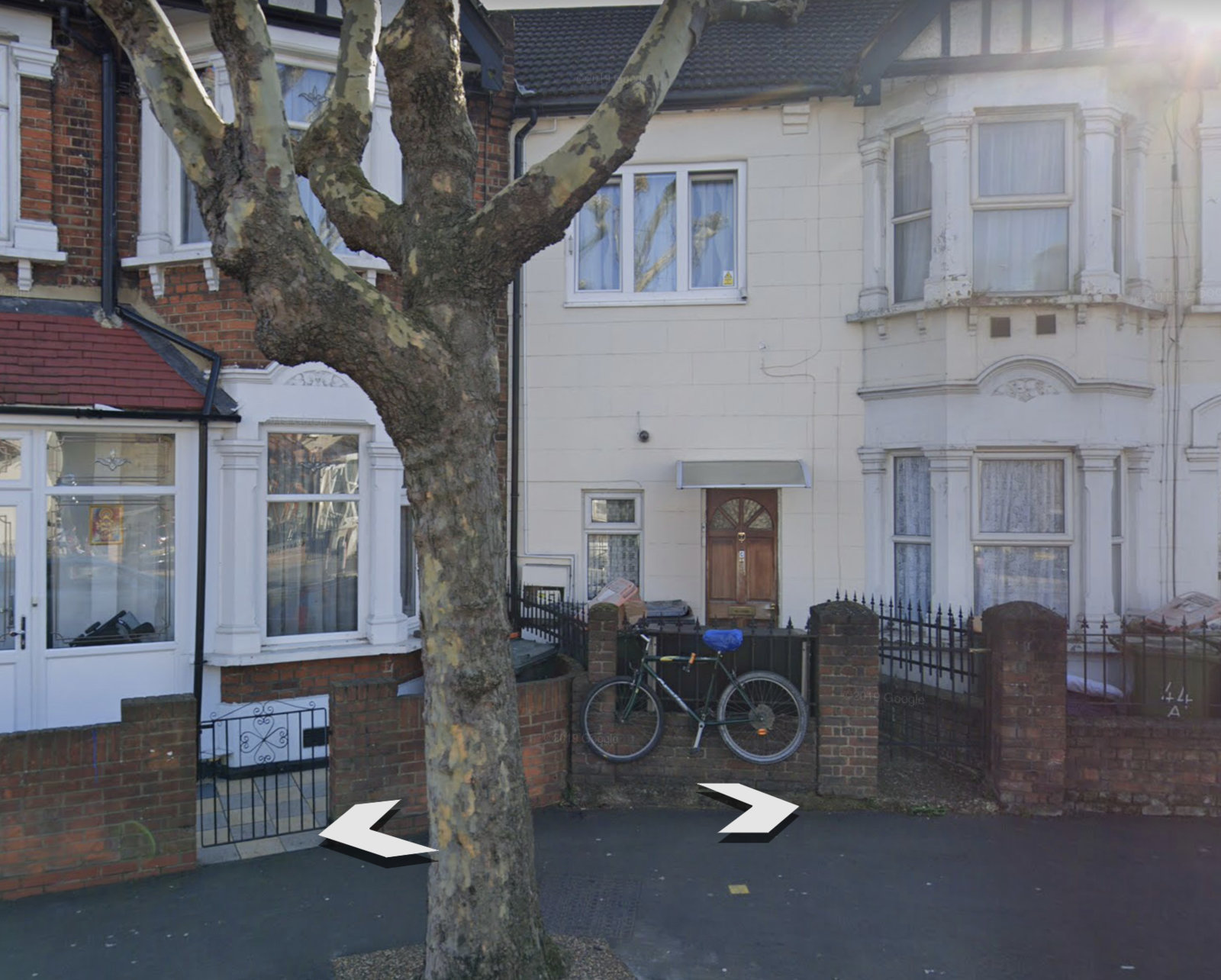

There’s a terraced house near where I work that was built on an old garage site that was built about 30 years ago. Skinny at the front but opens out at the rear. Totally out of character (One of my conditions is that I mirror the bays and door opening of adjoining properties). How they got PP for that I can only imagine. :whistle:

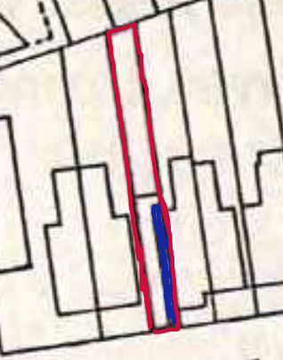

It just says 'The land hatched on the filed plan is subject to rights of way in favour of owner/occupier of the house next door'.
I have attached a map showing the 'hatched' piece of land where the neighbour has right of way which I have highlighted in blue.... I have also drawn red lines outlining the edges of the property I am interested in.
Any future issues that could get thrown up should not prevent me from accessing 'my' house as the 'right of access' is a pedestrian width pathway on the right side of the driveway.
The things I would now question is....
1. I guess if my car was covering this area then the neighbour could cause issues. I am not sure if a car could be parked on the driveway without covering a part of this 'right of way' area. I guess the worse case scenario is I'd have to park on the road?
2. Building the property and laying a new driveway may cause short periods where access may not be possible or is made awkward. Not sure what happens in these situations if the neighbour would want to make a fuss and complain. I wouldn't have thought access would be cut off for more than an hour once in a while during the building process. Maybe this is ok as long as notice is given?
Is there anything else, especially more serious things that I should also consider?

Hi....got some more info from the deeds of the neighbour:
The land has the benefit of the following rights granted by a Conveyance of the land in this title dated 21 February 1946 made between (1) Ellen Smith (Vendor) and (2) Peter Tulon (Purchaser):- "Together with a right of footway or passage of the width of three feet on the north side of the said premises leading from the road to a gateway at the back of the said premises".
Do you gauge much more from this info? Is there anything to worry about other than the neighbour, or a future neighbour getting the hump because my car is covering 10 inches of this 3 foot passage so much so they force me to park on the road?
Also to add...this neighbour has a main door at the front of their property, so it's quite possible they don't use this part of the driveway as a walkway too often.
Nothing about animals or vehicles, but obviously a car won't fit down a 3 foot wide passage.
I wouldn’t think you can legally park over the right of way so that will likely tick your neighbour off. It doesn’t look like the neighbours have garages/off street parking so what’s the problem with parking in the street anyway? What about getting a smaller car (Smart car?). How about shortening the building so that you park past the neighbours rear entrance or even try buying the right of way?
Good points.
Yeah, a car would definitely cover the 3 foot wide invisible path.
Not sure if there would be some objection to turning this into a residential premises as they'd possibly be more parking congestion as 90% of the properties on this road don't have driveways. I guess complaints possibly would not come as they'd assume I could park on the driveway, not knowing about this 3 foot wide invisible passage.
Yes - buying out the right of way could be a good idea. Not sure how much that kind of thing typically costs to do. I guess them agreeing to this depends on whether this access is essential or not. I don't believe there is an adjoining property at the back. No basement flat. Property '32A' etc... The gate they access leads into their garden.
This agreement to access was arranged in 1946 and the current neighbour purchased the property in 2000. So they may not even require the access.
Could always bargain with them and agree to let them use the driveway on rare occasions with my agreement, but maybe that would open up a can of worms and it's best to buy out the right of access or just park on the road.
