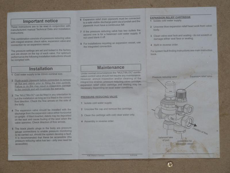

Can anyone confirm the OP's statement that there is a non return valve between the balanced cold outlet and the EXV connection port on that type of valve?
Tony
The cylinder instructions (inlet group was in accompanying pack with cylinder):
The instruction sheet with the valve group itself lists the presence of a check valve within the assembly, but does not have a schematic:
I agree the instructions and schematic does imply its located as you suggested.
Also stating the reason for it being there would make it logically placed at that point.
I always like to see a cross section drawing of parts though as manufacturers sometimes get their instructions wrong.
When the correct port is clearly shown in the instructions its difficult to imagine why the installer would have done it differently.
