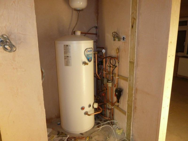

I don't have a 'finished' whole-cupboard view, but there's this from part-way through. The whole cupboard was at his disposal, but everything is on one short wall.

That space is perfectly viable to make everything serviceable... My pipe layouts are far from perfect but I have got a boiler, cylinder zone controls primary and domestic pipe work into a cupboard 1150 wide, and everything less than 600 off the rear wall (boiler and cylinder side by side. Actually the cylinder was a bit deeper than that - but it was the ,most protruding bit.

I've double-checked the cupboard. It is 1200 wide and 850 front-back internal floor dimensions. Ceiling is about 2450 high. The doorway is about 1100 wide and normal door (6' 6") height.

Pressure vessel is the white one that's up high in the cupboard, yes? It has a braided hose and connects onto the very top of the pipe that I believe is hot outlet (connects to one to the top of the cylinder).

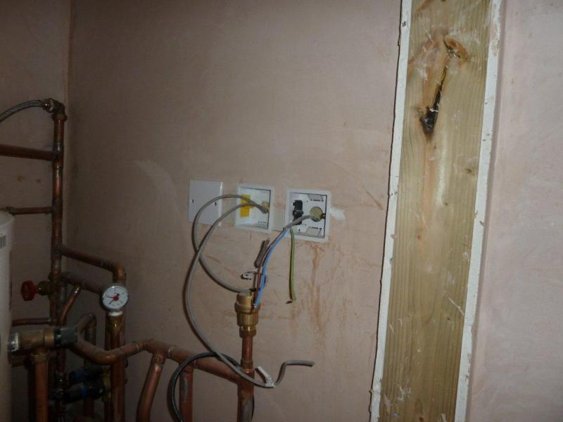

I don't have a good picture, but I have this (I was really photographing the cabling):
From top to bottom in the corner at extreme left:
1: braided hose to the pressure vessel
2: copper to the top of the cylinder
3: smaller copper that goes to the shower thermostatic valve the other side of the back wall
4: copper that I think takes hot water downstairs
5: red wheel valve
The 15mm copper immediately below that actually comes off the cold - it is the other side of the thermostatic shower valve.

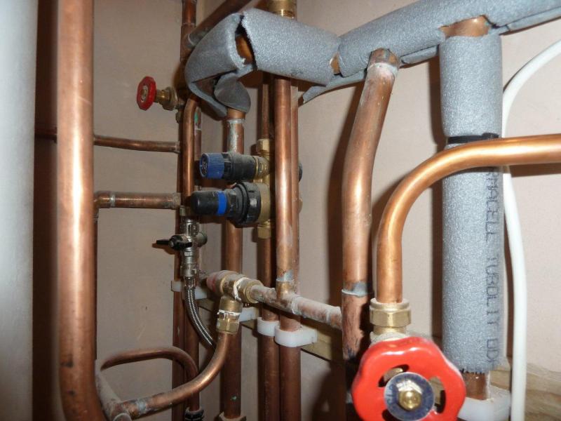

'Combination valve on the cold inlet' is that the double black plastic thing with blue bits at the bottom of the photo above?

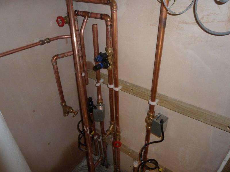

More visible in this, during install:
As I understand it, this has 22mm copper bringing cold up from downstairs:
1: through a stopcock,
2: through the double black-and-blue thing I don't know from Adam,
3: round a corner,
4: there's a 15mm leg down which now has a chrome valve and braided hose and connects into the return from one of the heating zones, I think.
5: round another corner, now flowing down
6: has the 15mm cold to shower noted above
7: has a 22mm that goes through another stopcock and then into the cylinder inlet
8: goes to just above the floor then turns through the wall to supply the bath taps (behind the back wall)

I wouldnt put any heat in to the cylinder till the pipe work was corrected so yes it has to be at risk
The stop cock 7 needs to be removed
The thing with the blue bits is the combination valve
I think the plumber has proved he is not up to the job, talk to the builder and come to some arrangement about taking out what has been done and getting it installed properly.

OK. What I don't understand is that the diagram in the gledhill instructions implies four pipes emerging from what it calls the combination inlet group, but I can only see two in what I have - ie no 'balance cold take off point' and no 'expansion vessel connection point', unless they are round the back and blanked off and I've just not noticed them.
I'll go and have a look at the back tomorrow.
