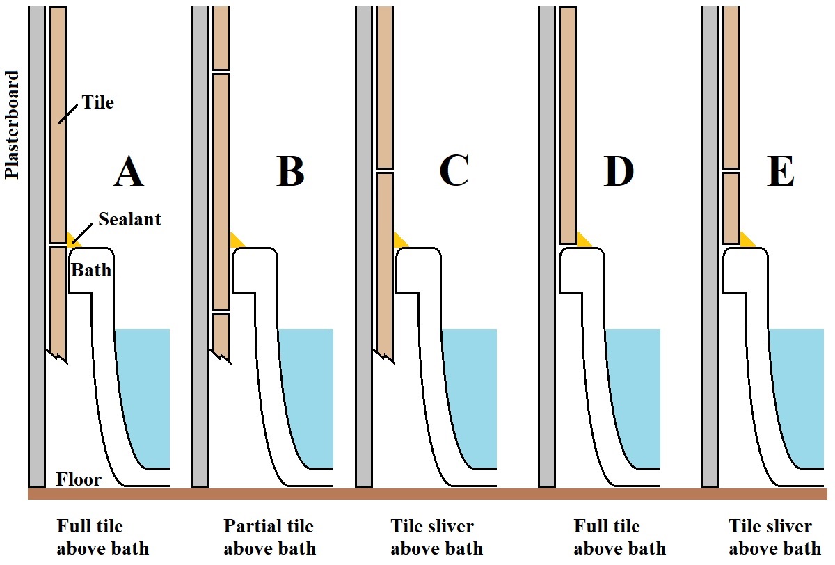

Just a question. When a Regional Installations Manager came to visit the job (after the bathroom had been re-tiled I hasten to add, not to view the initial car crash) he said that it was "normal" to have a thin row of tiles above the bath rather than a full tile. I confess I disagreed (and so did the tilers who were also present). So, is it normal to tile from the bath upwards using a full tile to start with (i.e. a full tile meeting the bath edge) or a cut tile?
Best to have the tiles running behind the bath so that there is tile above and below the edge of the bath I'm guessing as per A or B. The RIM was trying to say C is usual - is he correct?

However, due to space constraints, my daughter is faced with either D or E. Which is best/preferable of these two options?

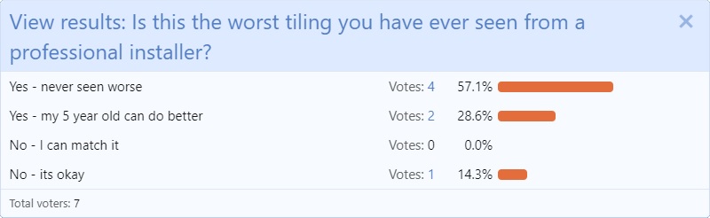

Interestingly, with 7 votes in so far, ONE persion says that it is okay. I'm guessing that that is a joke and that they are not serious. If they are, I'd love to know why they think it is fine.
If you haven't yet voted (poll is above post #1 this thread) please do so. Thanks!
D or E are the usual methods, depends on the size of the tiles relative to the wall height and other features in the room whether it's a full tile or part.
Tiles behind the bath means nothing to support the edge of the bath and more likely to leak.
What should happen is that a batten is fixed to the wall so that the whole edge of the bath rests on it and is fully supported.
Line of silicone sealant applied to the top of the batten and to the wall just above it, bath goes in against the sealant.
When set, tiles are installed above the bath leaving a small gap, tiles are grouted (but importantly NOT in the gap between bath and tiles), when the grout is set the gap between tiles and bath sealed with silicone.

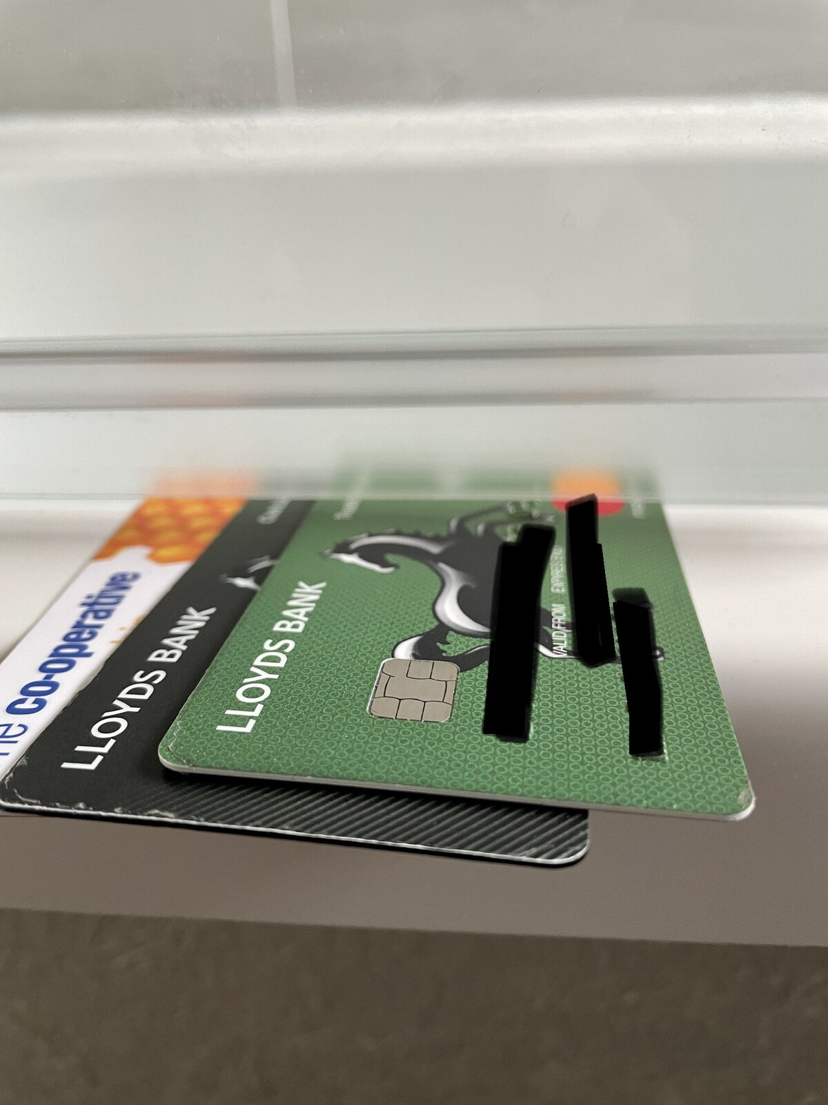

UPDATE ...
Well nothing has been done on the job since last Monday (6th).
The bath is plumbed in but pipework is leaking somewhere (this done by a 'plumber'). The shower is connected up but unable to be used because of a lack of sealant around the bath and ...

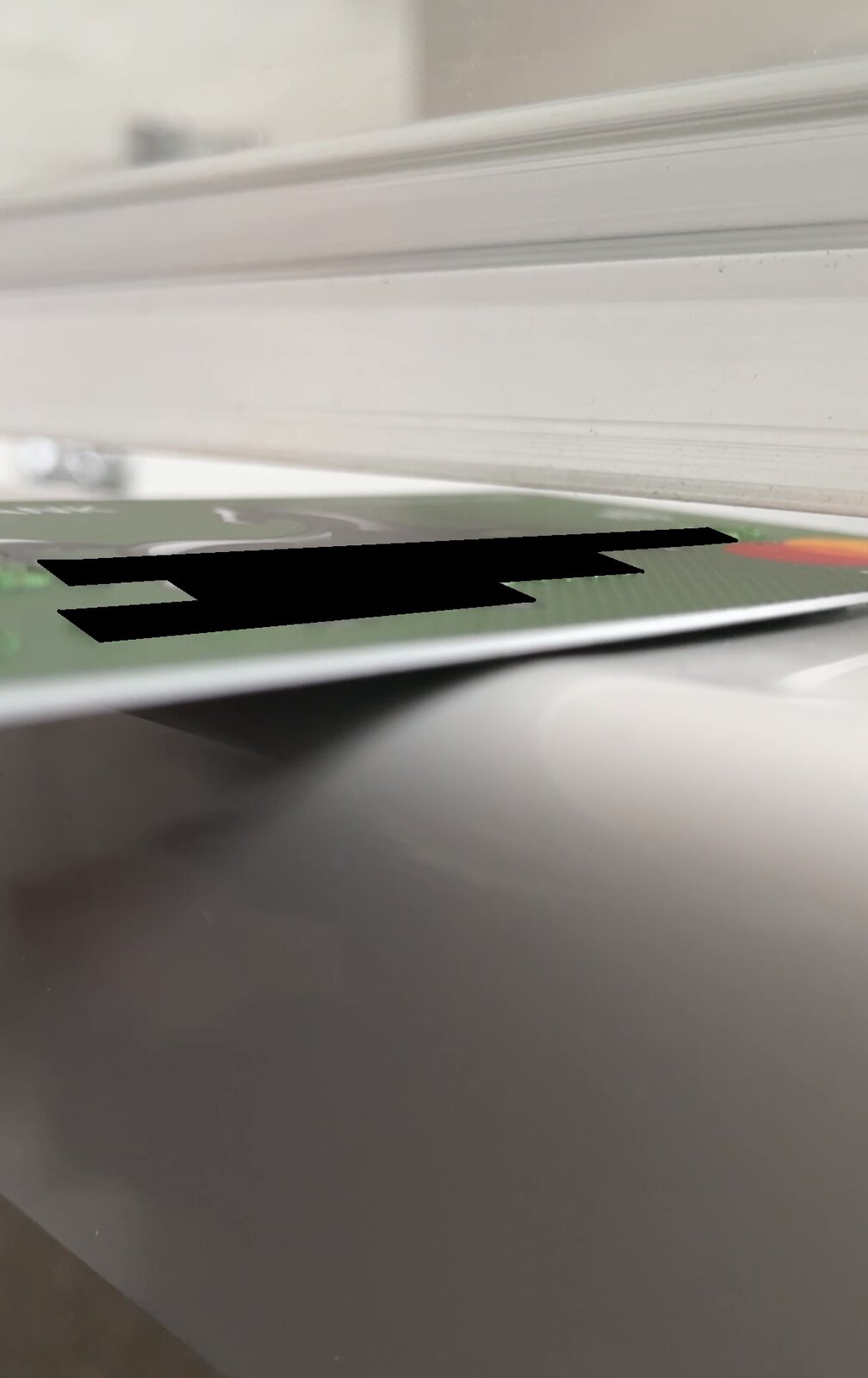

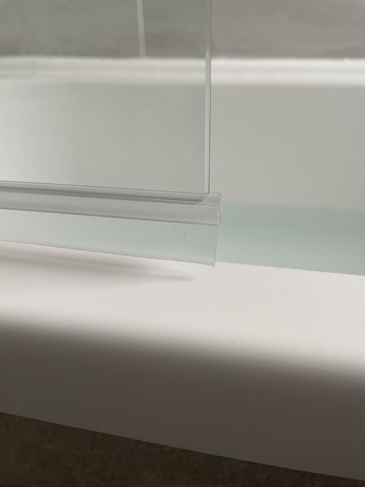

... the fact that the shower screen doesn't actually touch the side of the bath!

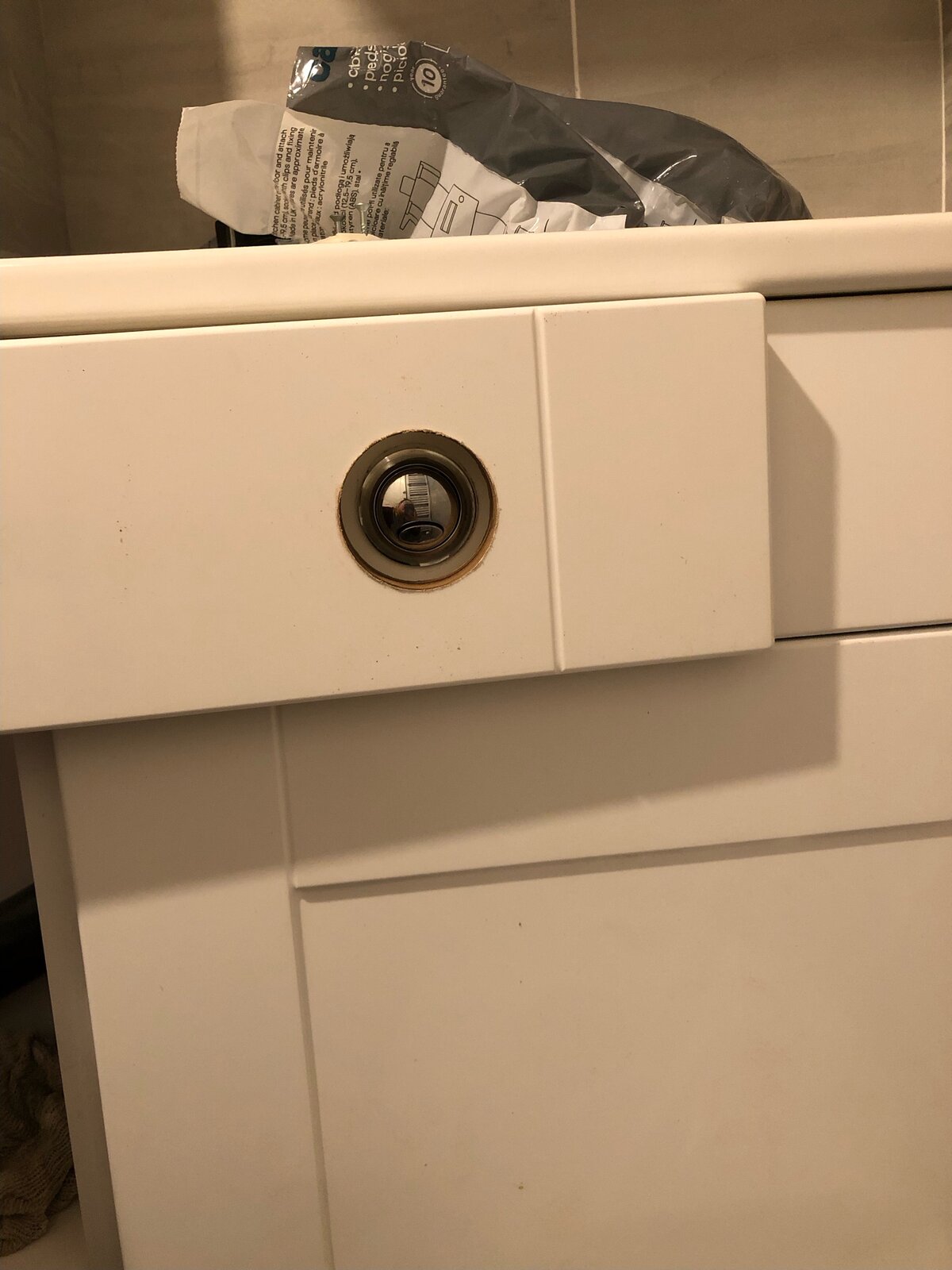

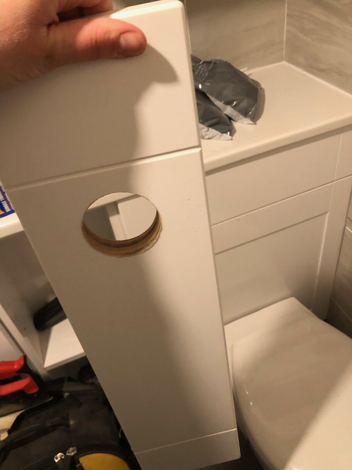

The installer also cut a hole for the push-flush button in a decor panel ...
... but he initially cut it far too big (as you can see) so he had to use the decor panel that should fit under the sink.

OMG!
How could anyone, even a diyer fit a screen like that???
And the hole for the flush button?!?!?!
It must've been his very first job.
Those buttons come with instructions and can be fitted virtually on any surface.
