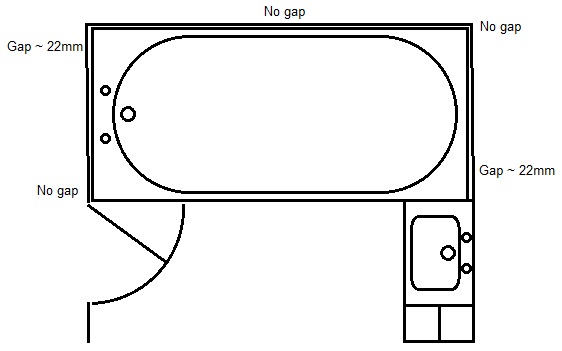

Turns out that the quadrant beading is required to cover a gap at the tap and foot ends of the bath which gets wider as you move from one side of the bath to the other (walls aren't square to each other). The diagram below explains.

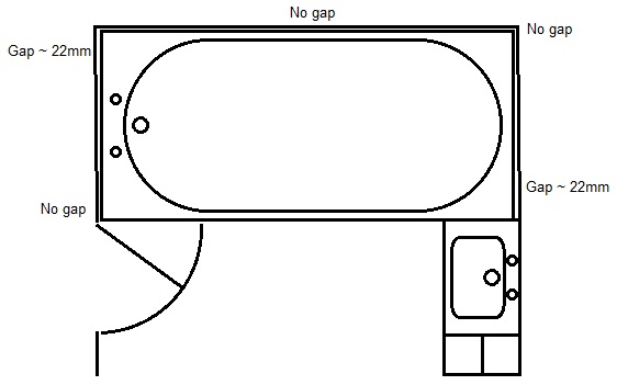

XRD
If I had to fit this bathroom I would've squared the long wall with the 2 short ones at aquapanel/cement board stage.
That's very poor planning because you'll never be able to cover 22mm gaps around the bath.
