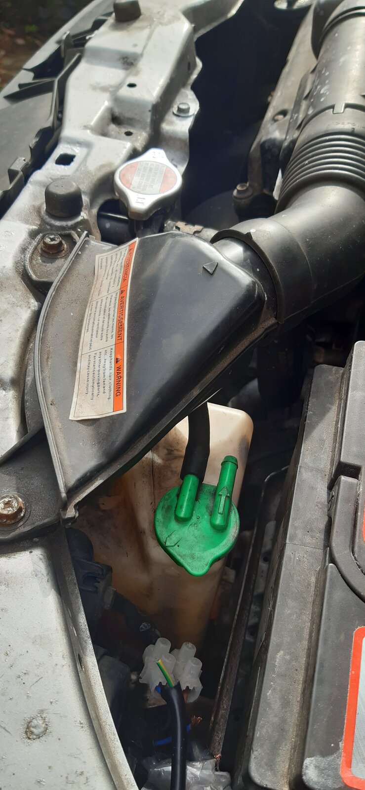

From the top radiator cap there could be a rubber hose, leading to the expansion bottle. The liquid in the expansion bottle must be above the bottom of this hose, so that liquid can come out of the radiator and then back again - a two way rad filler cap allows this.
Can you confirm this please?
John :)

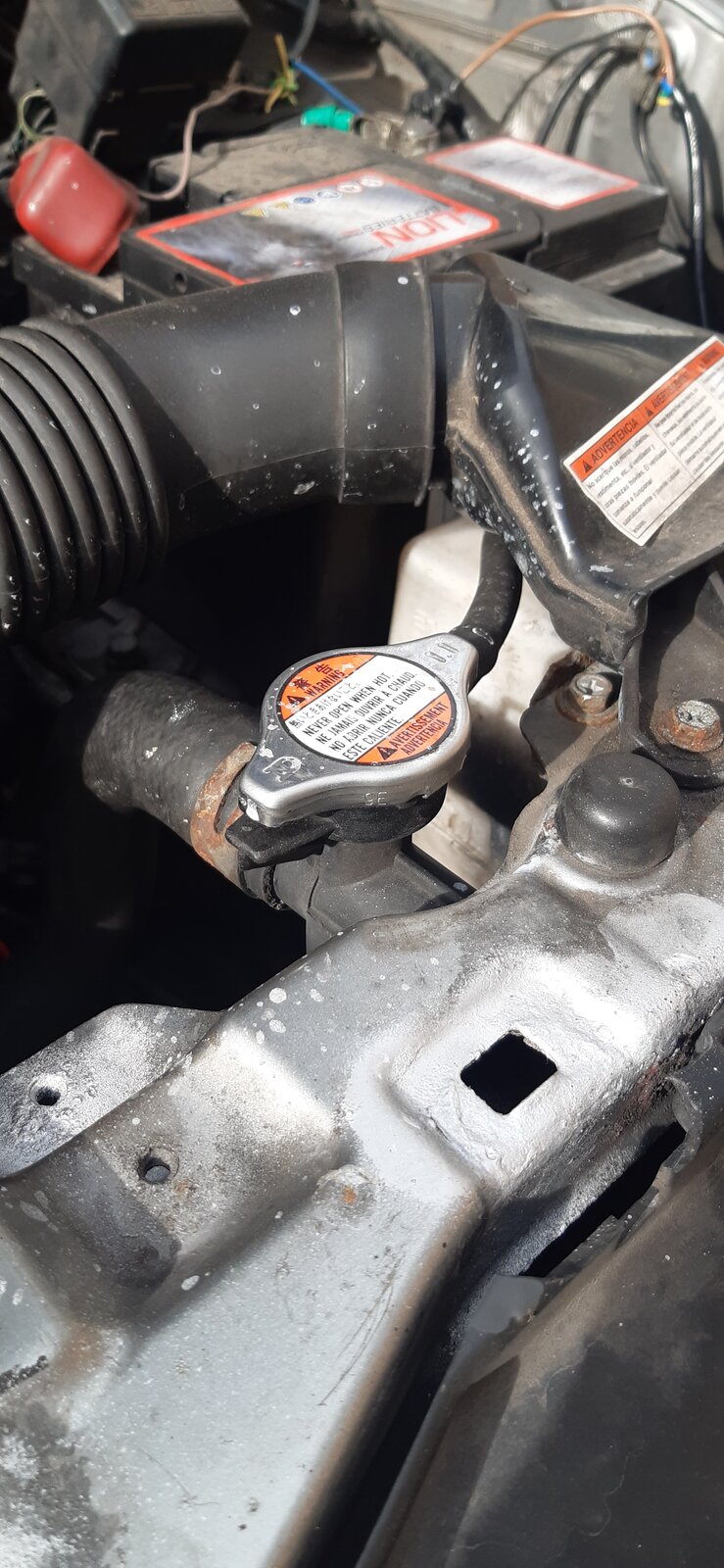

There is a small rubber tube just below the radiator cap.
The expansion bottle is a bit lower than that.
It's the expansion bottle that steam seems to splatter out of
Have you checked there's no gunge in the radiator, reducing the flow rate?
OK, thanks for the pics!
Keep the level of liquid in the expansion bottle exactly as it should be.
Is there any sign of oil in there?
So, we have an expansion problem, so either the coolant isn't circulating for one reason or another or maybe the cylinder head gasket has failed.
However, the radiator is meant to maintain a high pressure of 14psi. It can only do this if the radiator fill cap is good and it's rubber seals are intact.
Any comment on this? A pic of it would be good too!
