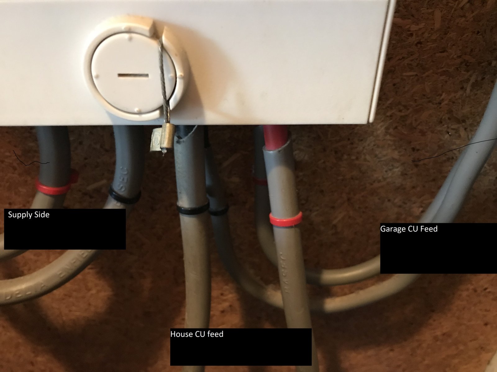

But in real terms the RCD for an electric car is inside the charging outlet, and likely supplied with SWA cable so no need for any RCD in the consumer unit, and with the supply required likely would be from a Henley block so it has full 100 amp supply if required. But one does question what was fitted with early charge points?
