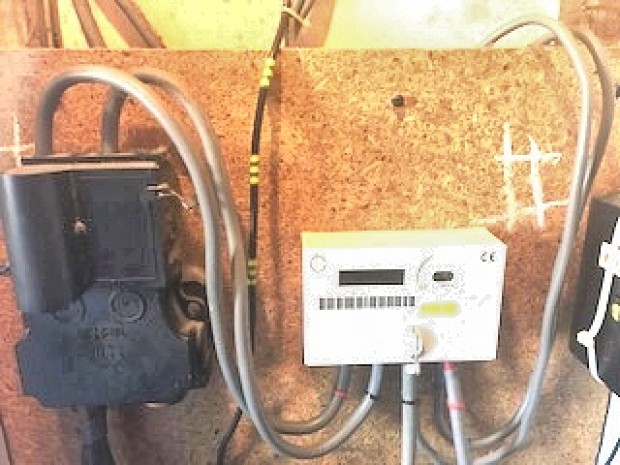

That's the meter :eek: ? A more usual arrangement is the feed from the meter being split into 2 pairs one to the house cu and the other to a switched fuse unit for the garage cu. They tend to use rather large bolt/screw connection units to split the feed from the meter 2 ways. Their name escapes me at the moment.
Unless there is some sort of replaceable fuse for the garage feed this looks to be rather odd as only the main fuse is protecting it. I don't think it's ever been done without separate protection but may be incorrect. Also usually having separate isolation as well.
I've seen meters of various ages and never one like that. A photo of the entire set up might clear things up

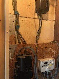

This is an image for the internal meter set up. The four tails I referred to can be seen, 2 on the left going to the house CU with the others to a breaker switch which in turn feeds to garage CU. I hope it clear enough.
The garage breaker is probably a switched fuse unit. That may use a wired fuse under the cover or a cartridge fuse. So essentially correct if fused. The fuse might even be in the meter - pass as never seen one like that.
So ;) thread so long I had to reread the first post, don't think you have a problem. The electrician that fits the new cu should check wiring before going ahead and may nose around before quoting. Can't see if you have an isolator for the main feed but looks like one fuse :) Bigger and clearer would be better. If no isolator an electrician should get the fuse removed and later replaced by the correct people. If you are being notified about having a smart meter fitted it may pay to do that first. They wont be bothered about you having a wylex cu and will probably wire up the garage feed as well using henly blocks to split the new meter tails. What they will do if that isn't fused pass. If there is one in the meter then they should fit something foc. Some electricians will remove and refit the fuse for cu work but as it's notifiable I'd guess few would in practice so as the smart meter is free a better option.
Your garage feed is basically the way it's done if some one want a garage cu's rcd's or rcbo's to work independently of the house cu's protection. Subject to wiring sums that can be done using an MCB in the house cu that bypasses any rcd's fitted or via a fuse that also bypasses house rcd's or a switched fuse unit. There are complications in the latest regs about cabling to a garage cu that say has to be swa in some areas but could be twin and earth in previous regs so shouldn't need updating providing it's ok.

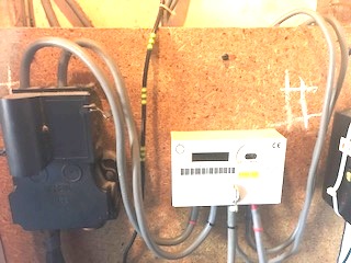

If it helps, this is a close-up of the meter/supply feed.
I can't see anything that changes prev reply. Maybe others can
The revised image was in response to the request "Can't see if you have an isolator for the main feed but looks like one fuse :) Bigger and clearer would be better".
